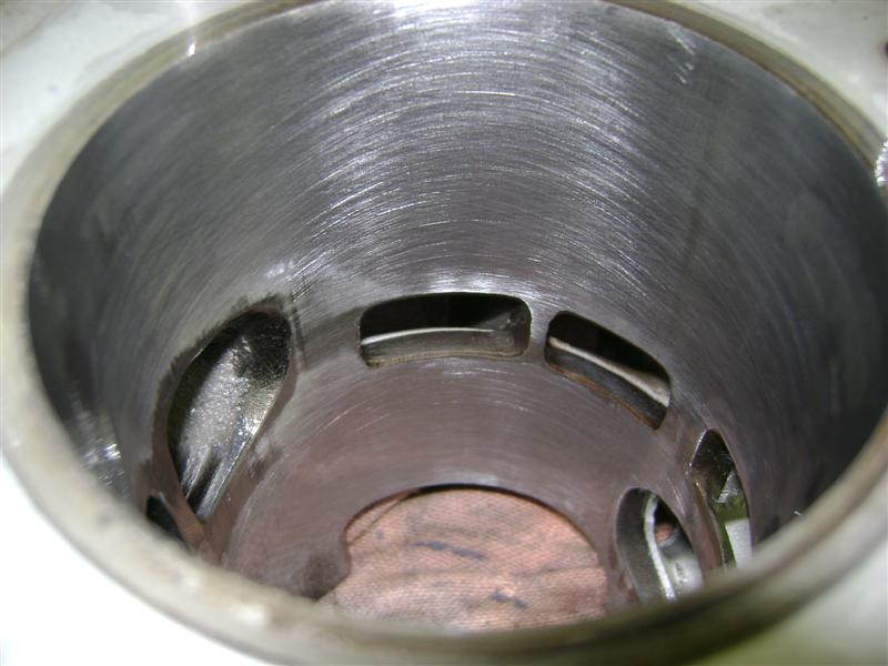

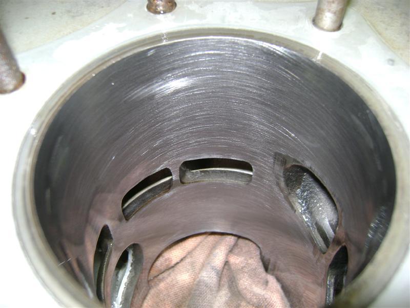

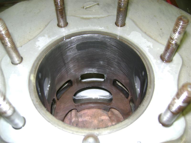

Got your cylinder, removed the aluminum then gave it a hone.
File comment: Huge build up of aluminum
File comment: Muratic acid doing its thing

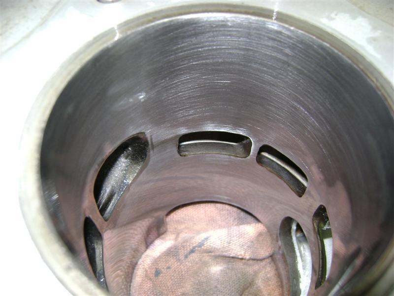

PostPosted: Fri Apr 30, 2010 10:11 am
Aluminum removed gave it a lite hone using a ridged stone hone.
The cross hatch is the high spots.

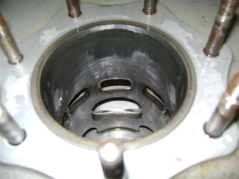

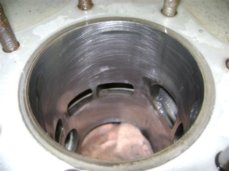

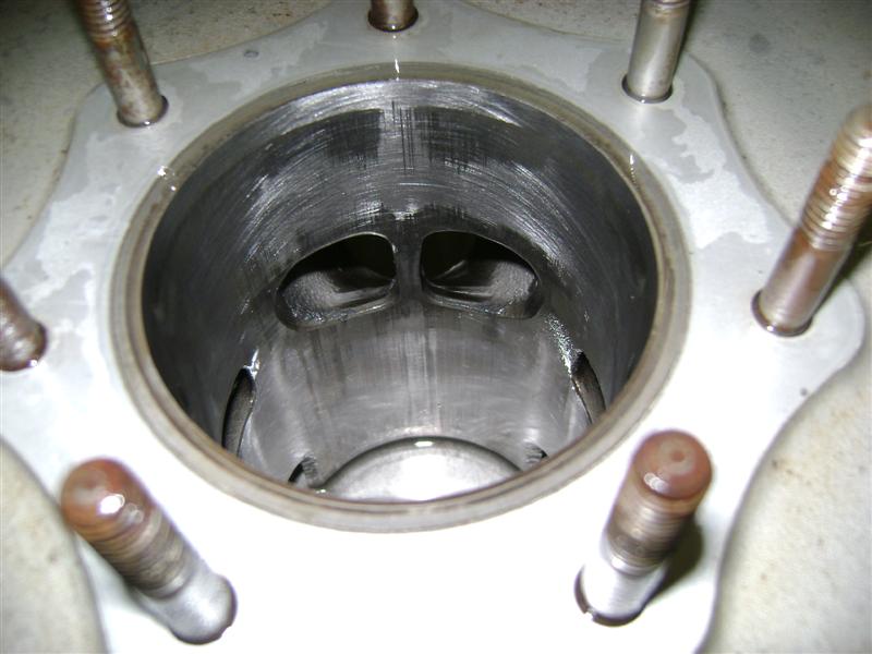

PostPosted: Fri Apr 30, 2010 10:14 am
Back in the hone tank and hone it a little more starting to get coverage

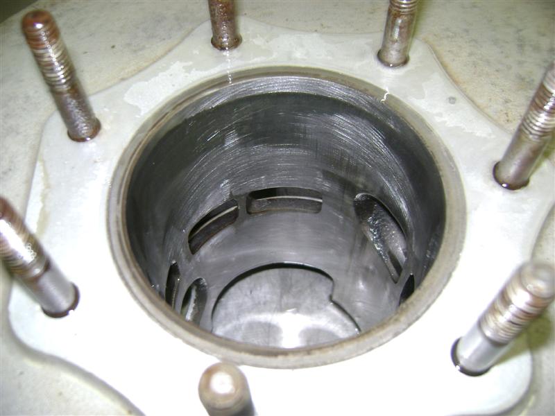

PostPosted: Fri Apr 30, 2010 10:16 am
Back in the tank one more time for more hone finially real close to where the bore is useable, the bore measures 3.102 or 78.80mm they make a 79mm piston?

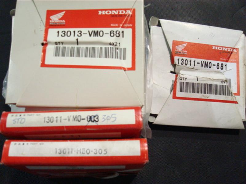

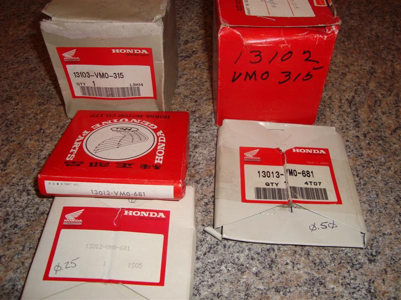

Yep, I have a Honda Art 25 over piston.
Here are pics of the the rings I have. I don't know if they are 25 over but I'm sure someone on the board will know.
PostPosted: Sun May 02, 2010 9:50 am
Service Honda site says the part number is 13012-VM0-305 RING SET, PISTON (0.25) wonder if numbers have changed over the years, it should say on the rings you will have to open the packages and look.

PostPosted: Sun May 02, 2010 10:44 am
Posts: 432
Location: long island NY
left side is .025 numbers,right side is .050.
PostPosted: Sun May 02, 2010 10:52 am
Posts: 432
13011 part numbers are for the std bore im pretty sure.
PostPosted: Sun May 02, 2010 5:39 pm
Joined: Sat Nov 27, 2004 7:04 pm
Posts: 138
Location: Gilroy CA
WTF?
Looked at all of the rings and in one of the boxes there was only one ring! I never opened it when it arrived. Damn e-bay thieves. It is stamped 25 so if anyone has a single ring we can make a matched set for Ride Red.
PostPosted: Sun May 02, 2010 7:26 pm
GarlicGreg wrote:
WTF?
Only one ring, that sucks, never heard that one before, years ago a friend ordered .50 over size for a 350 and kept getting std. rings, after the first set if you looked close you could see where someone had opened the packages and swapped the rings then sealed them back up, had to happen some place in the Honda parts system, we assume someone had a bunch of std. rings they could not get rid of.
