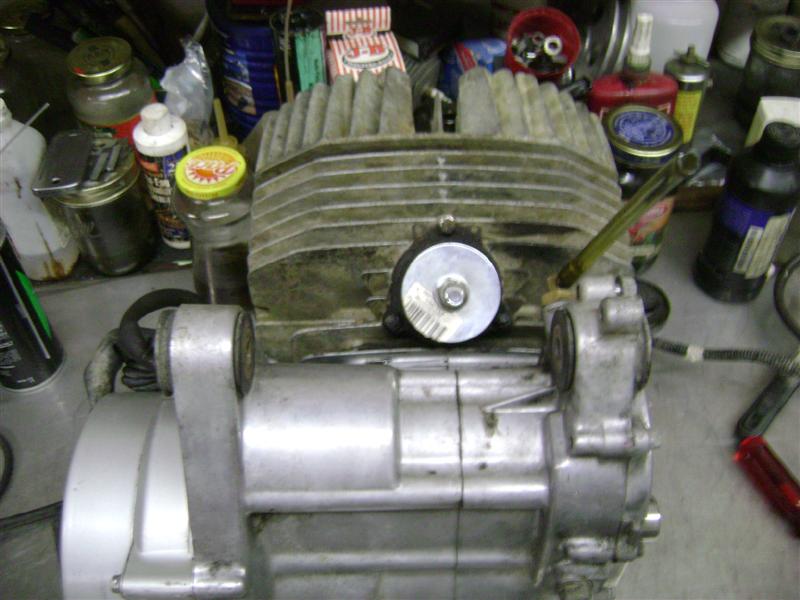

After it was somewhat clean I added air, pump it to 10 psi and it almost instantly drops to 5 psi then to 0 psi in about 15 seconds, huge leak, I stick the vent tube from the balancer mod he did up to my ear can feel air coming out, not good, remove the balancer side cover sure enough the balancer side crank case seal is leaking.
A air leak or a leaking seal is a big thing if not fixed or noticed it can cost you hundreds of dollars, what happens is your sucking extra air into the Engine threw another passage and not the carb if the air is not flowing through the carb its not picking up the required amount of gas and this creates a lean condition then you end up melting your piston, if all you need is a new piston kit and gaskets and you can simply hone the cylinder your still looking at 200.00 min. not including the down time you suffered.
You don't have to pull the Engine to do the pressure test as seen in these pictures but you will need to pull the exhaust and at least the carb off the intake and unhook the pulse line to the fuel pump.
Its a pain but its not hard to do well worth the time you invest if you have a bad seal and suck dirt and air it can cost you hundreds of dollars if you discover this later on.

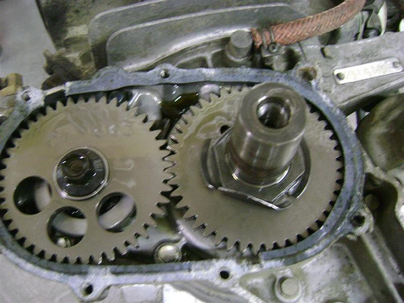

Pulled the right side cover off so I could inspect the mag side crank seal also.
See all the oil assume this was from the balancer case here read this http://pilotodyssey.com/350sb.htm" ."..

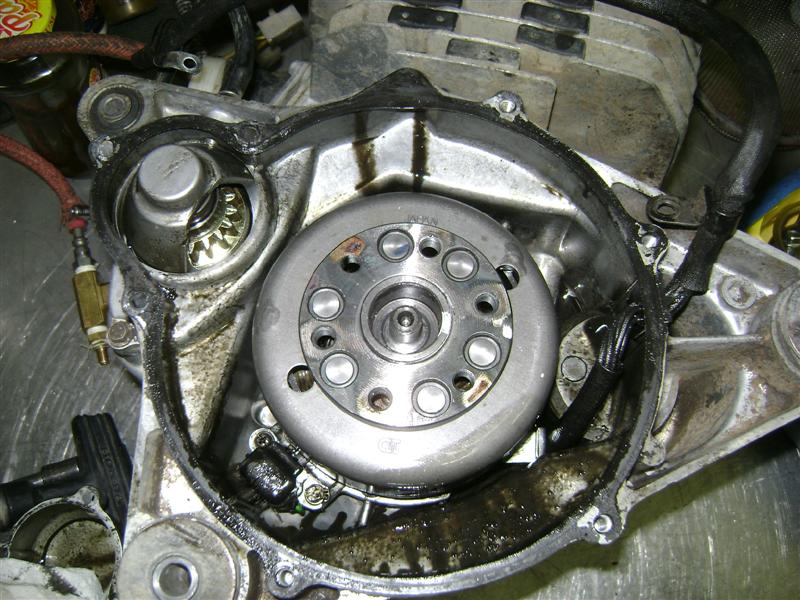

PostPosted: Tue Apr 03, 2012 4:03 pm

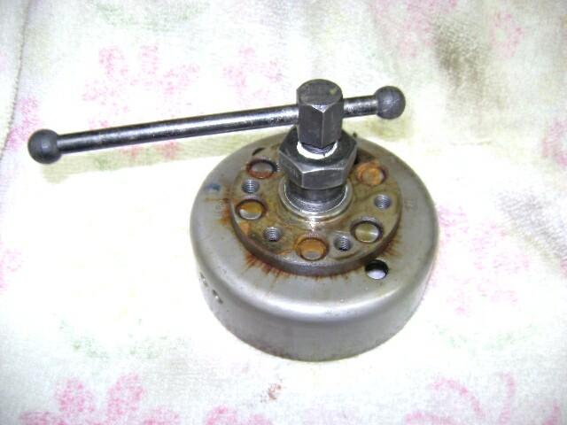

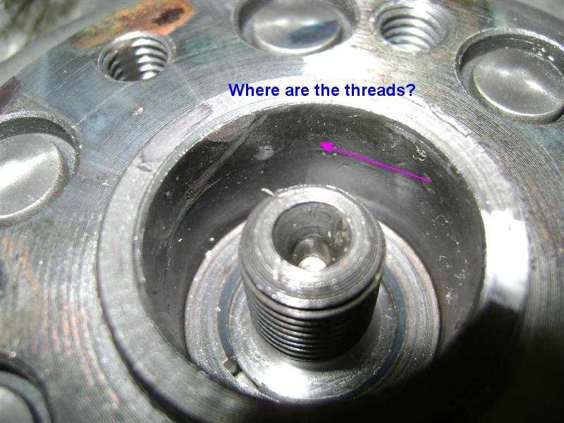

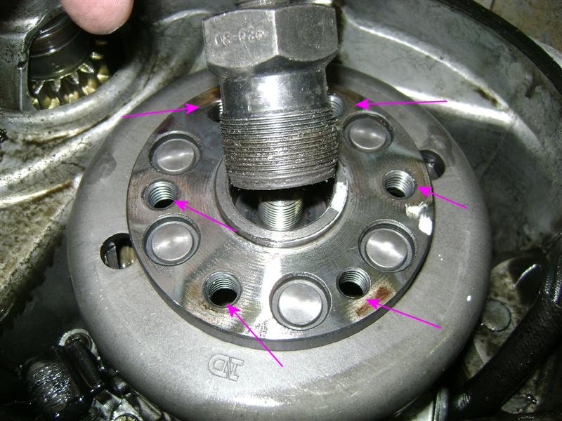

Next I want to pull the flywheel but wait a minute thought you used the same puller you use on a FL250?
WTF no threads! Mudbogger's was threaded they only thread some of them?
viewtopic.php?f=1&t=3596
Further review MasOdyssey's don't look like it was threaded NEVER use a puller like he used and pull from the outside of the flywheel!!!!!! http://www.pilotodyssey.com/cpg/thumbnails.php?album=10
Now I gotta make a puller or modify one to remove it.
PostPosted: Tue Apr 03, 2012 4:04 pm
Plenty of threaded holes for me to bolt a home made puller to and remove the flywheel

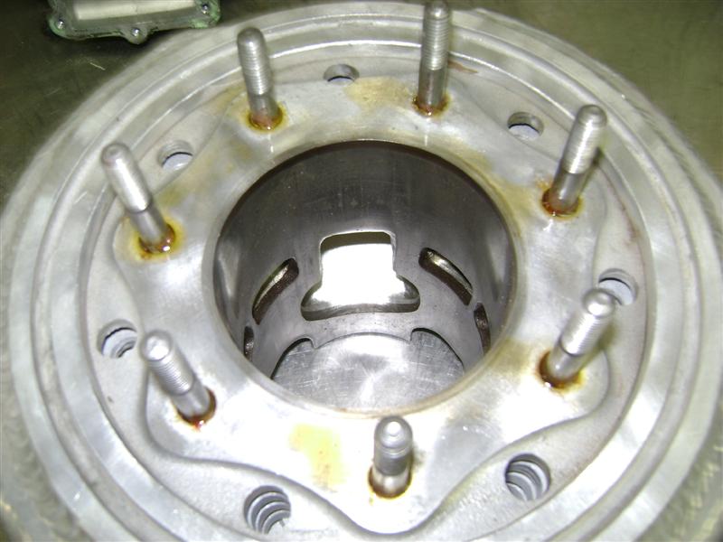

Cylinder and head removed, no big surprises here typical stock cylinder and head.
File comment: .

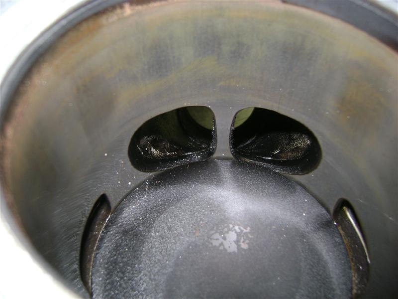

You can see carbon stains on the cylinder wall where the ring end gaps are.
File comment: .
A light haze of rust on the cylinder wall, what oil are you using?
You might consider pulling the choke after your done riding and let the Engine idle a while to give it a extra shot of oil to coat the internals when your not going to be using it for a day or longer

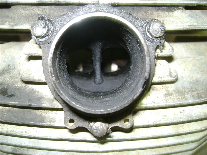

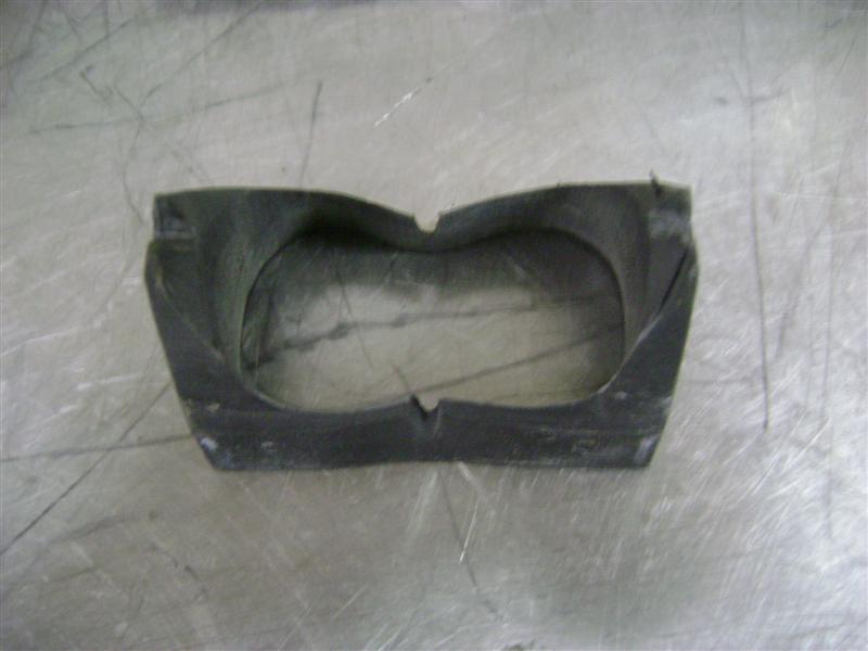

Exhaust manifold does not match the cylinder casting.

First thing I do on all cylinders is put PB Blaster on all the studs get them soaking

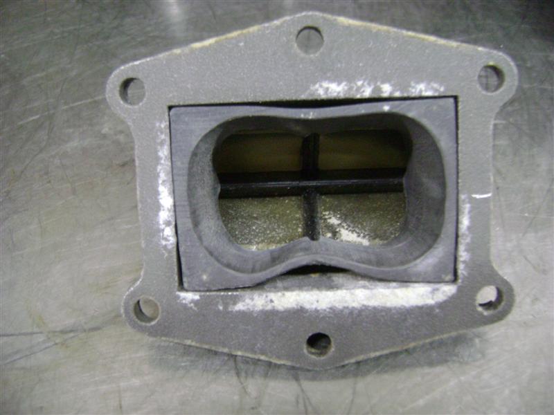

Reed petals has been changed sometime in the past

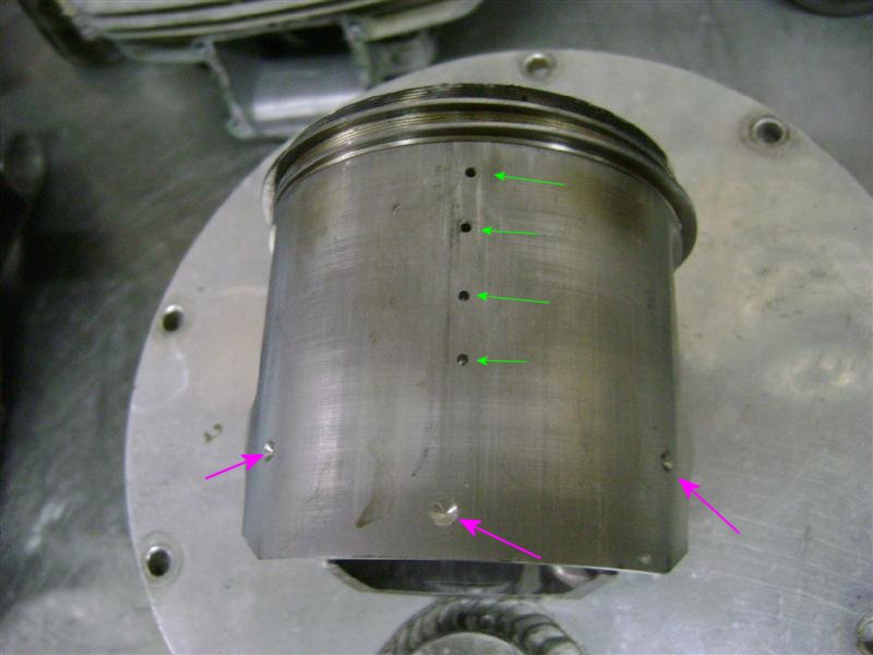

File comment: Here is the used piston that came with the cylinder/head combo, regardless of the wear on this piston and rings (not very much) they will be reused until the jetting is established and the cooling system tested and proven
File comment: 4 lube/cooling holes drilled on the exhaust side of the piston, more is better?
Note the 3 dimples drilled on the skirt I assume these are to also hold more lube

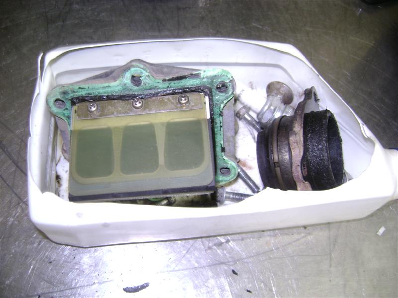

Here is the FMF reed cage that will be used, its needs a little work.
File comment: Like most these FMF cages their stuffers suffered problems with warping I will fix this

That's strange. I just got my FL350 flywheel puller in the mail and it's meant to thread in. Apparently it's the wrong puller. http://bit.ly/HS0YDw
And thanks on the liquid cooled setup. It's definately had some port work but to what level I cant tell you. Maybe Hoser can tell you more. I'm still pretty green on the subject.

that's the right puller I used the same one on Mudbogger's 350 viewtopic.php?f=1&t=3596 they must have had different batches of flywheels some were threaded some were not ?
PostPosted: Wed Apr 04, 2012 8:40 pm
The flywheels that i have used on my 350s have been threaded. wonder if some of the unthreaded ones were from a pre-recall Engine?
PostPosted: Wed Apr 04, 2012 9:05 pm
That Engine came off a post-recall buggy. There's no X at the end of the VIN. My other Ody has the X at the end of the vin. I'll post what I find on that Engine at rebuild time.

I've never seen one threaded like that either, i've always used a harmonic puller & 3 bolts to pull my fly wheels.

Are you guys looking close, the threads are very fine and shallow a lite layer of dirt will hide them you wont see them unless your specifically looking for the threads in the right place.
A dimly lit work area and a little dirt you will never see them.
If you look in the factory service manual the printed one not the POS copy from the web with the black pictures you can clearly see the puller in the flywheel then the next picture is the flywheel off showing you the bolts you remove to remove the starter gear :-)

I had to scratch my head one time looking for the threads, then I cleaned off the dirt film
