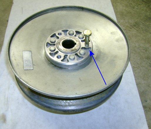

Here is the driven clutch I use on my 440 Pilot, the trans uses a different input shaft made by Dan Roberto, its a 7/8" shaft, it accepts the FL350 clutch and or the 90D Comet.
The clutch comes with 3 drilled holes so I tapped them to 5/16 bolt so I can use a 3 jaw puller to remove when it becomes stubborn you also can thread in a bolt to spread the driven for replacing the slipers and belt like on the Pilot driven, dunno if this works on the stock 350 driven maybe the 350 gurus know?
Sure makes changing belts EASY and you don't stress out the belt by running it over the clutches.

I need to get one of them puller dohickies... And a tap and die set to match.. I am need to replace my slippers on my driven, but have not gotten the nerve, that almost looks easy...

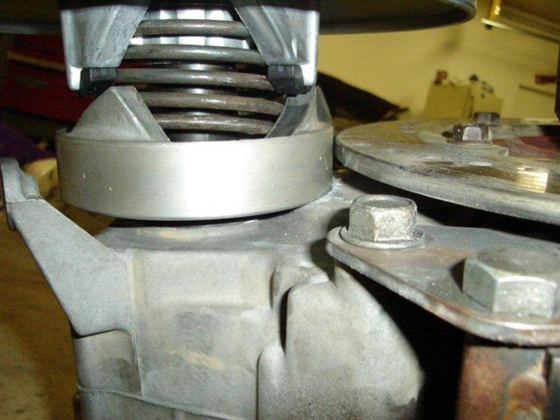

I found some pictures of modifying the helix to fit the Pilot trans

I'm curious if you have ever run into a more suborn driven pulley. I setup my puller like its shown in the pictures (great idea by the way) but the problem was the new 8mm holes I drilled and tapped stripped before it came off. I even went up to 10mm after that and those stripped as well.
I finally cut off the pulley so now I could grab the very back and once the spring compressed all the way it still wouldn't budge. I busted the puller trying to get it off.
I've never seen anything stuff like this before. We were putting on penetrating oil and heating it with a torch and even tapping it with a hammer. Nothing.

You trying to remove the whole clutch or just the cam?
The whole clutch will get rusted on the shaft and be hard to remove sometimes, the cam make sure you removed the snap ring :-) sometimes the end of the shaft its on gets mushroomed or rusted tap the cam and drive it on further then sand the end of the shaft, lube it up and try to pull again.
