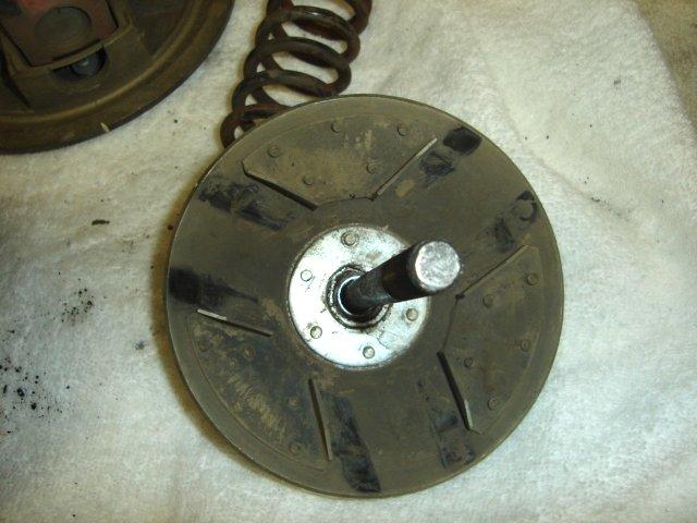

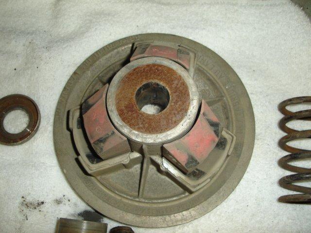

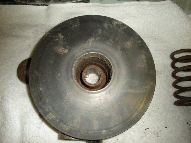

Mike sent me his PB for a CSI...
I found plenty of dirt inside.

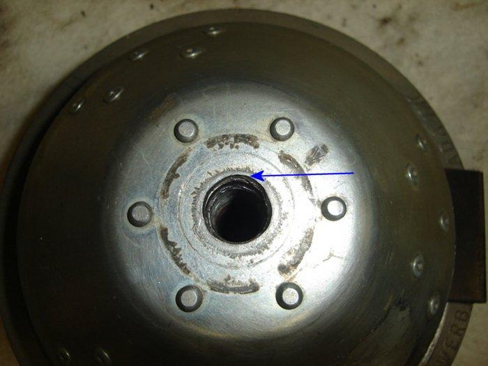

PostPosted: Tue Jan 02, 2007 2:57 pm

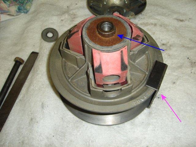

After cleaning the clutch up and inspecting I assembled, using the 'hoser clutch holding tool' (pink arrow) you can see this leaves the end of the shaft exposed so you can properly "key" the cover on the end of the shaft. (blue arrow)
PostPosted: Tue Jan 02, 2007 2:59 pm

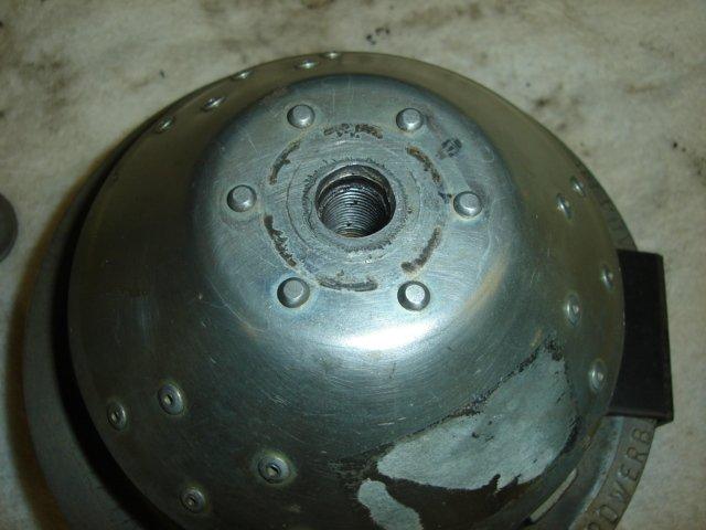

Cap on lined up properly, now the clutch can be put on the crank with the 'hoser holding tool' in place then all you have to do is torque the center bolt, you need to ensure the hoser holding tool is position so it does not get clamped between the back of the clutch and the Engine.

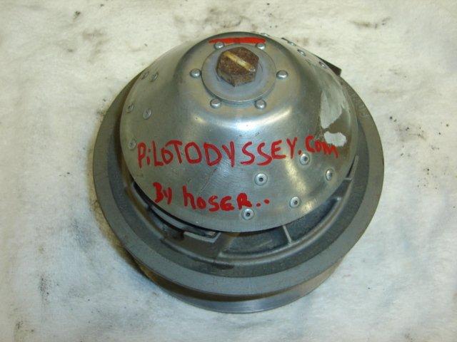

PostPosted: Tue Jan 02, 2007 3:03 pm
Shameless plug lmao

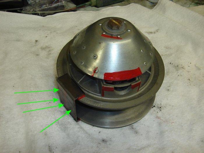

PostPosted: Tue Jan 02, 2007 3:05 pm
I used a paint marker to "key" the clutch for future reference when assembling, green arrows point to the 'hoser holding tool' its a ONE handed tool unlike the POS "Billet" 30.00 holding tool other mutts sell that require 3 hands to use, you can fabricate your own it takes about 5 min to make, cost about 2 bux...
http://pilotodyssey.com/PO/viewtopic.php?t=2238
