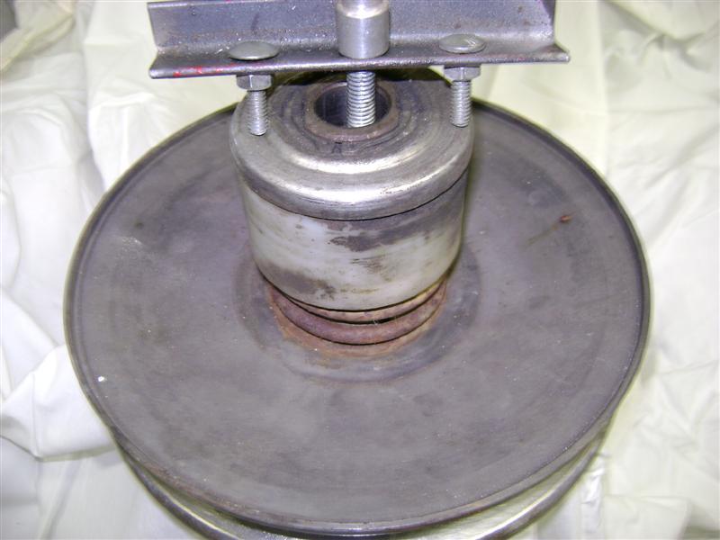

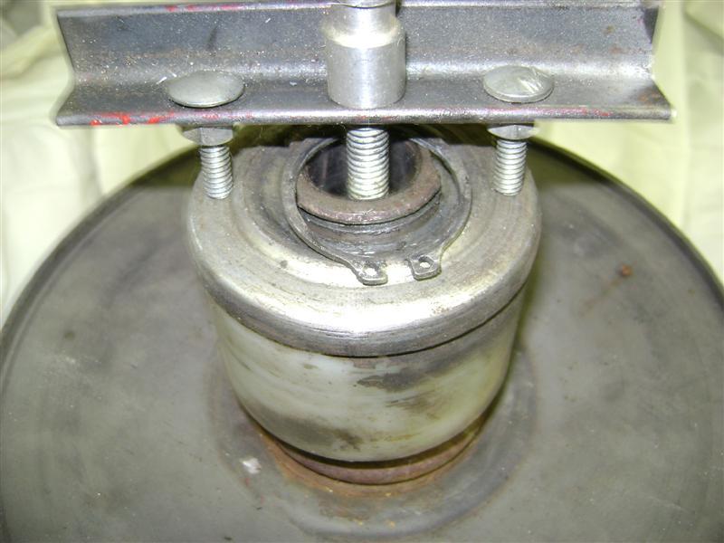

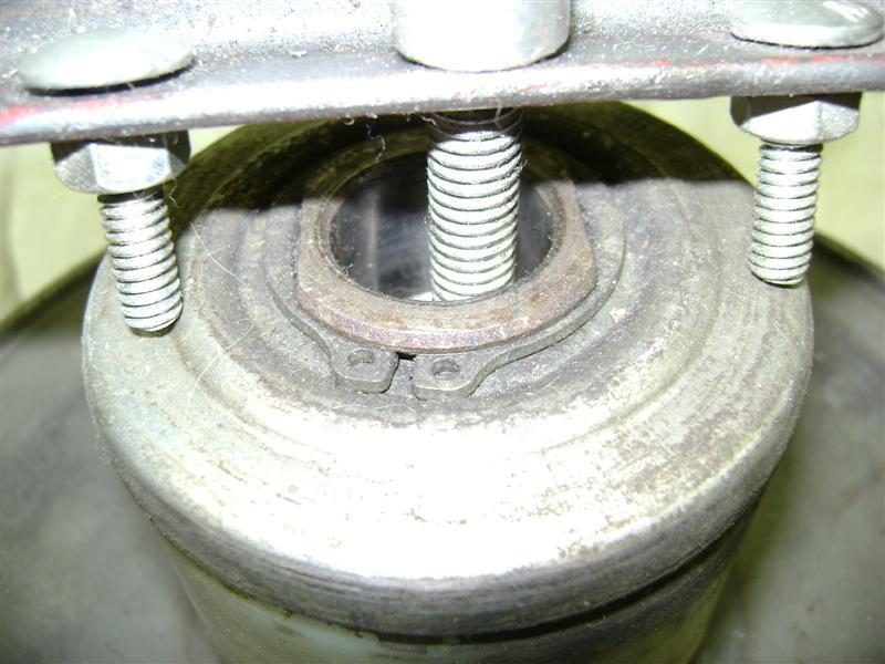

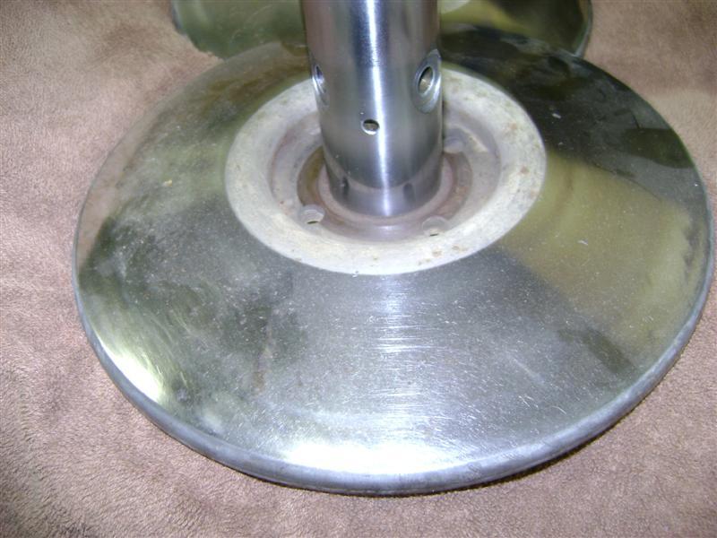

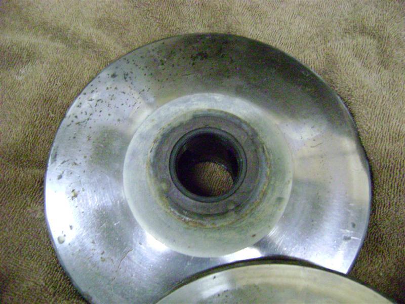

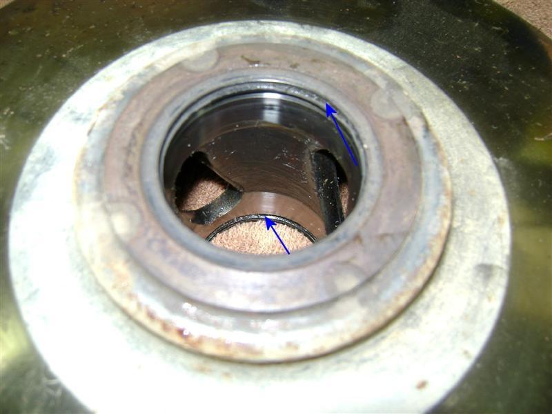

Afastcar sent his driven clutch for a CSI first thing to do is take it apart, using my home made tool I compress the top and remove the snap ring.

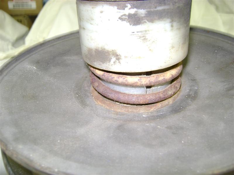

Spring is rusty...

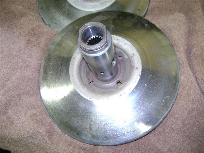

The clutch faces are in good shape

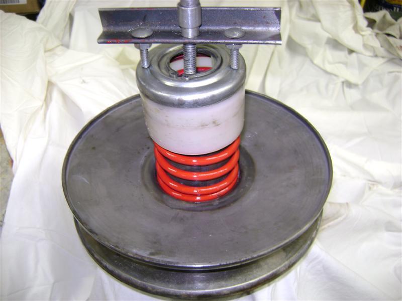

The spring and spring guide was hoserized to reduce friction and ensure smooth operation, I painted the spring to slow future rusting...
