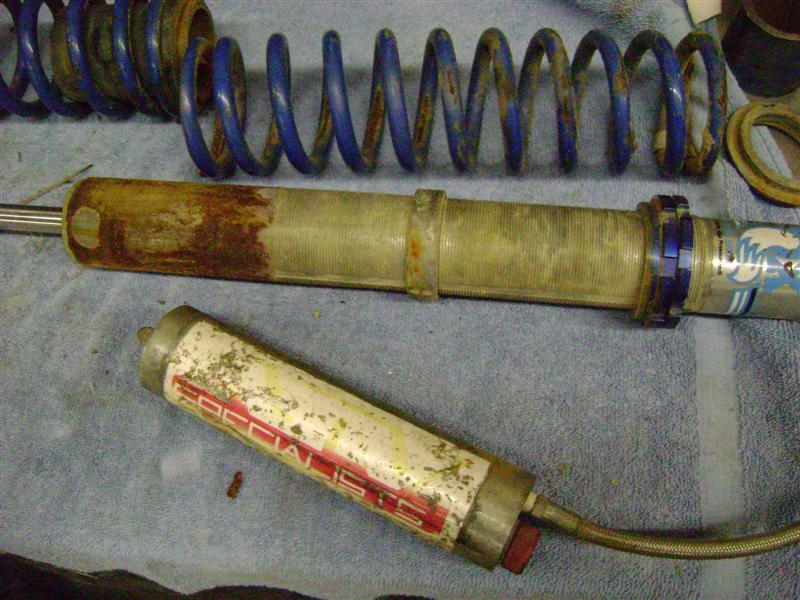

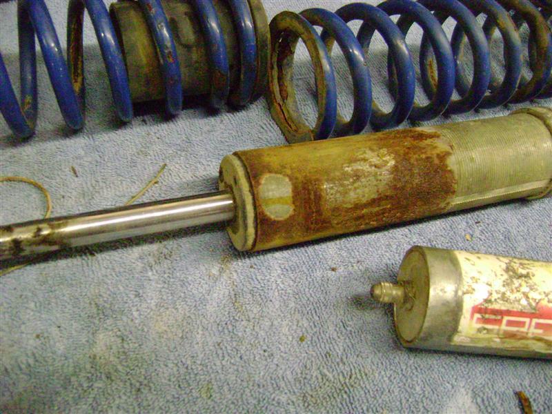

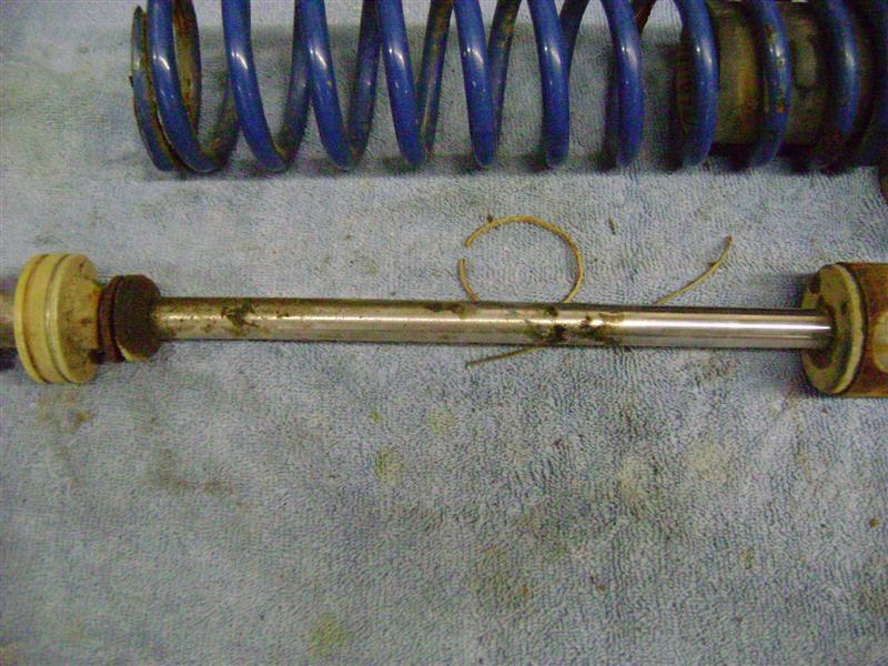

Here are some (FRONT) FOX shocks off a ATVR LT Pilot, they are old and weathered.
On the front shocks the shafts are pitted it looks like someone sprayed some sort of rust preventive on the shafts but its much too late.
These shocks measure 17.5 " center to center of the eyes, I washed them and they are drying I will post more pics later.
The shaft size is .500

PostPosted: Fri Mar 14, 2008 3:15 pm

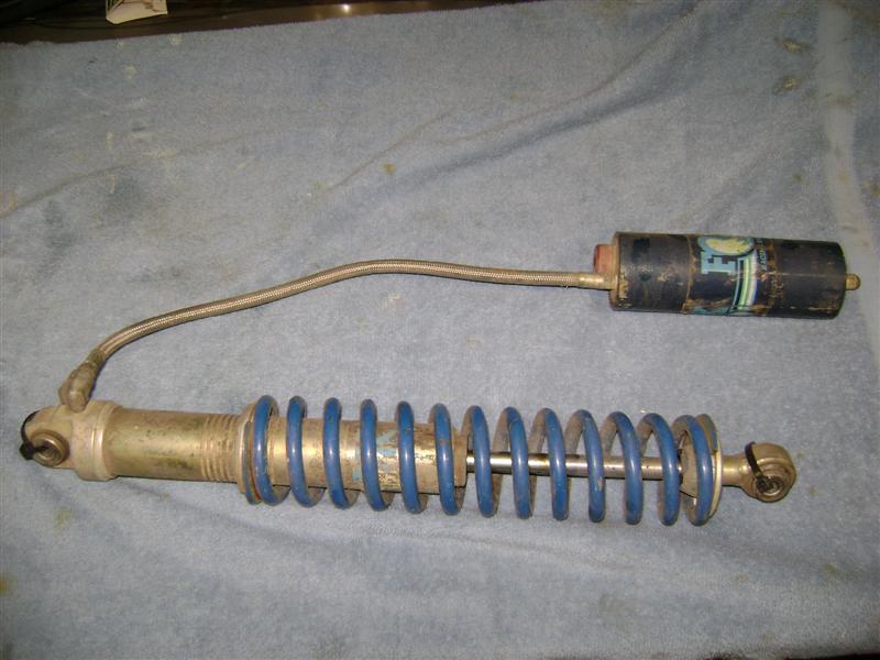

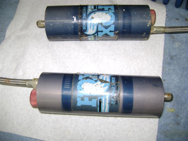

Here are some (REAR) FOX shocks off a ATVR LT Pilot.
Not sure yet if the shafts have any rust I need to clean the shafts and inspect closer once dry.

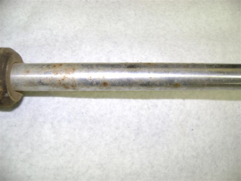

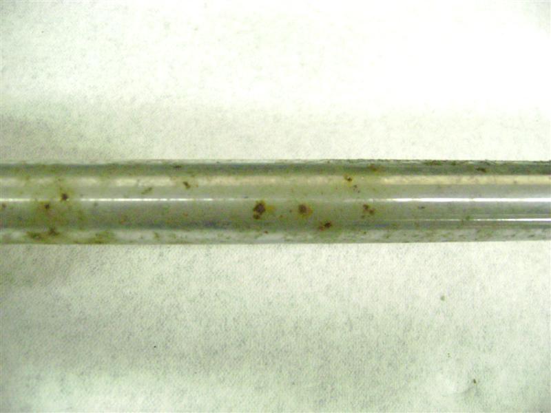

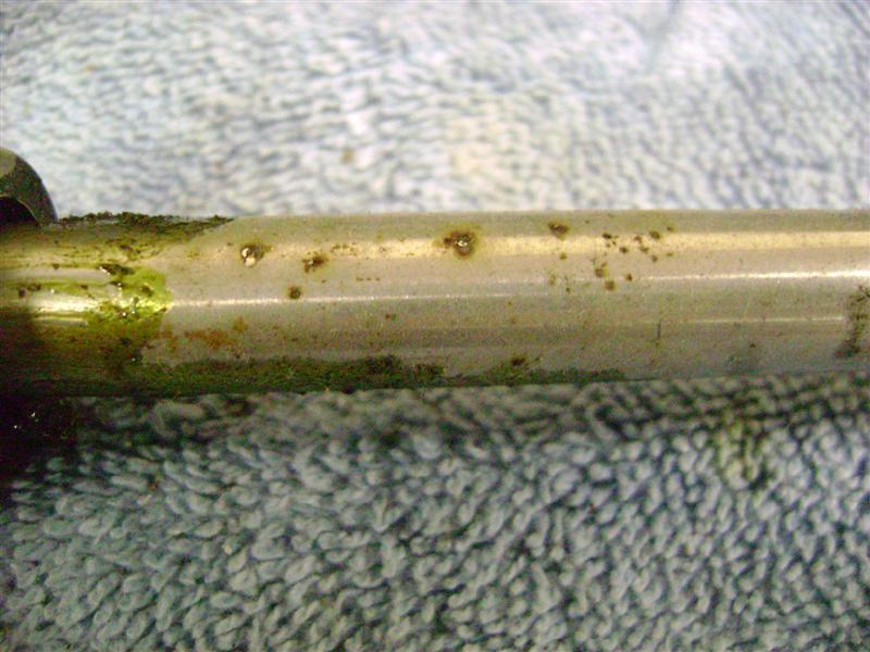

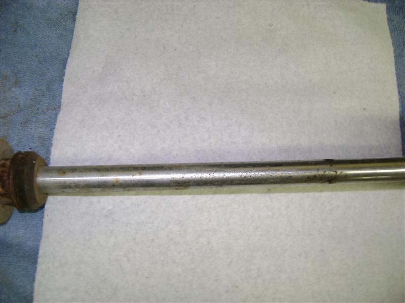

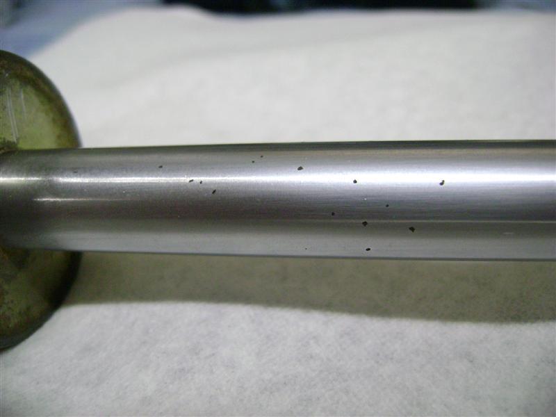

PostPosted: Fri Mar 14, 2008 4:04 pm
The pitting on the front shaft is not as bad as it looked before cleaning up but the damage is still their, sooner or later the pitting (little holes in the shaft) will damage the seal, they will also fill with dirt and drag the dirt into the seal and maybe the inside of the shaft, they sometimes fill with oil and drag the oil out of the shock.

PostPosted: Fri Mar 14, 2008 4:05 pm
The good side is the pitting is closer to the other end of the shocks travel so they might last years in the current condition it will depend how often you get that far into the travel.
It don't look like they are leaking so far.

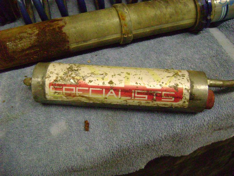

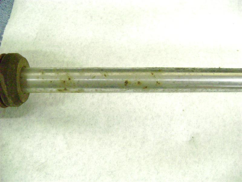

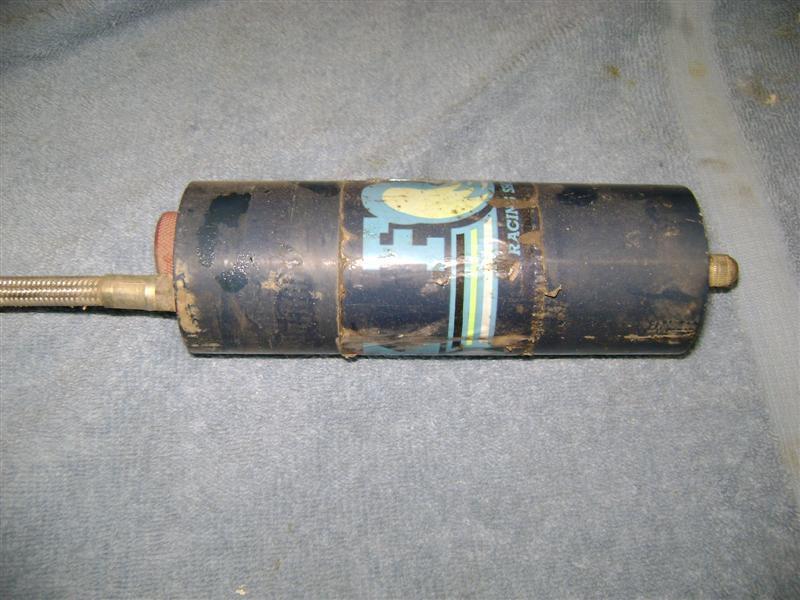

PostPosted: Fri Mar 14, 2008 4:08 pm
Looking at the amount of sun fade on the anodized rez it looks like these shocks have spent years setting outside in the sun one rez is fades much more than the other, no doubt all this setting outside played a big part in the shafts pitting, the only shocks I have ever seen pit were on machines stored outside for a long time.

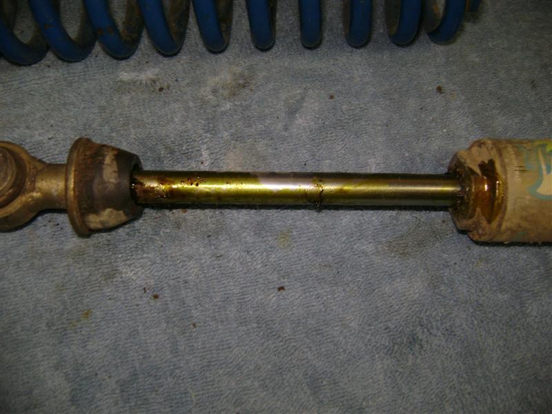

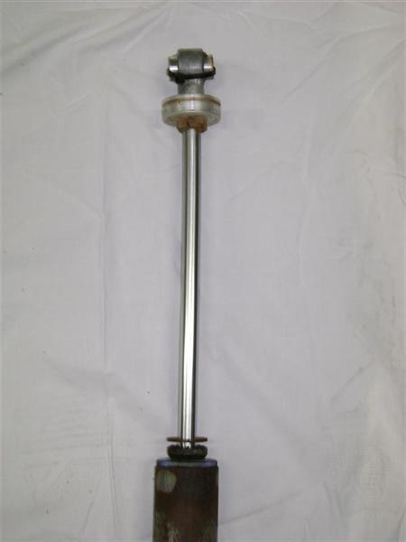

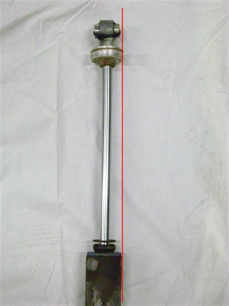

PostPosted: Fri Mar 14, 2008 4:12 pm
Here is the rear shock after being cleaned it has some slight pitting too.
Its hard to see in the pics but the shaft looks bent to me.

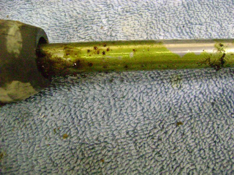

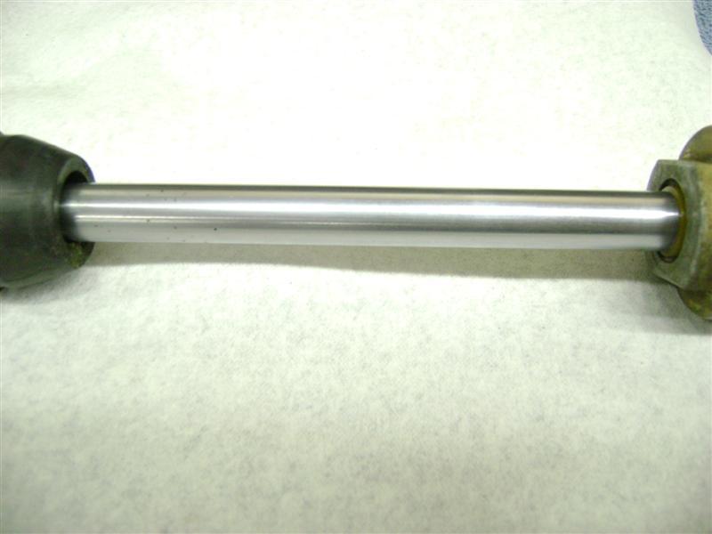

PostPosted: Fri Mar 14, 2008 4:13 pm
Here is the other REAR shock the shaft does not look bent.
Has some rust.

PostPosted: Fri Mar 14, 2008 4:45 pm
Posts: 533
Hoser, if you do not mind. I made a strait line to see the bend more clearly. I can see it fairly well without.

What I would do before making any repairs to these shocks is try them first, maybe even run them until they are leaking good then decide what you want to do, hard telling what valving these shocks have in them it might be all wrong, I have yet to see a LT ATVR suspension 'work' like a suspension is suppose to, I need to make a video some day following a ATVR LT Pilot and a Drakart so I can show you what I mean, FL670 has both so perhaps I can make the video behind him.
Following a ATVR Pilot you seldom see the suspension cycle, it only cycles over large bumps, you watch the head of the driver and the flag as they drive and you can see the car is taking more of a beating than a guy in a stock Pilot your following, IMO this is wrong using only 2" out of the advertised 12" of suspension 99% of the time, when you follow a Drakart especially the Drakart with the FOX Air shocks their is a HUGE difference, you see the suspension cycle up and down as it should, the driver and car don't take a beating, the ride even looks way more plush.
The bend on the one rear shock is slight, I doubt it will hurt anything but the seal and the bushing inside, I see no abnormal wear on the shaft as if its trying to bind, the bend more at the end so unless your using the full stroke of the shock I doubt it will matter, eye balling the bend I would say it will take 3/4 stroke of the shock to get to the bent area, the same goes with the rust its 3/4 the way into the stroke of the shaft.
I know your missing an axle was this Pilot damaged in the rear, you think that's how the shock was bent, another way to bend shocks is by a huge bonzi jump, the shock internals cant react fast enough and the shaft then bends under the compression.

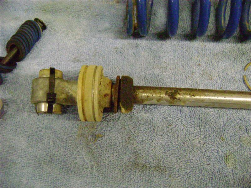

the upper mount to the frame on each side of the shock eye is a spacer, one is missing, its a stepped spacer to go in the shock eye then to the frame.
PostPosted: Sat Mar 15, 2008 7:42 pm
in this pic you can see them on the bottom they are wire tied in, they are the same on the top
