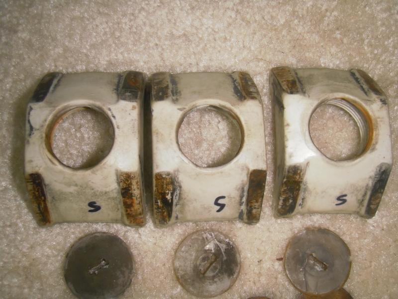

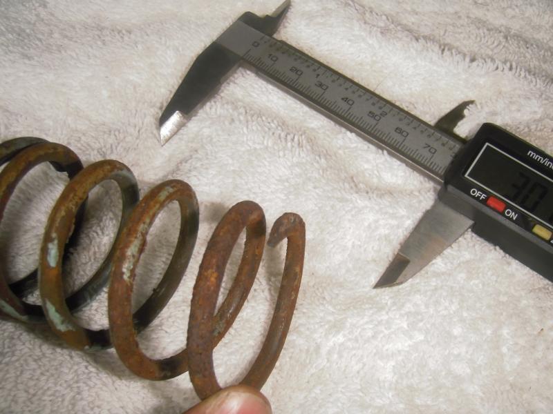

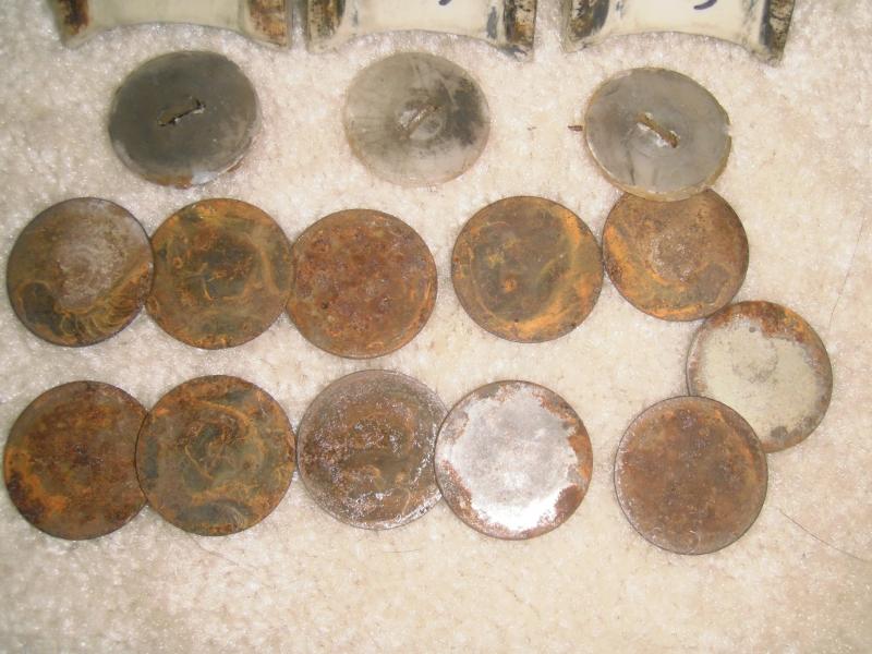

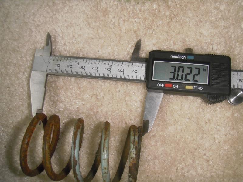

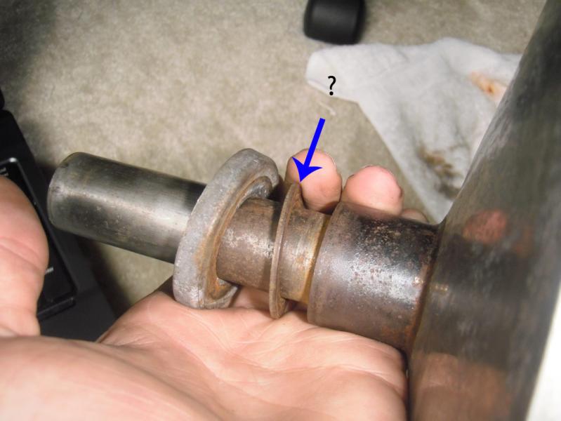

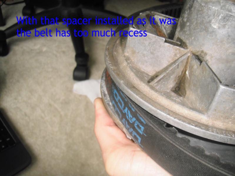

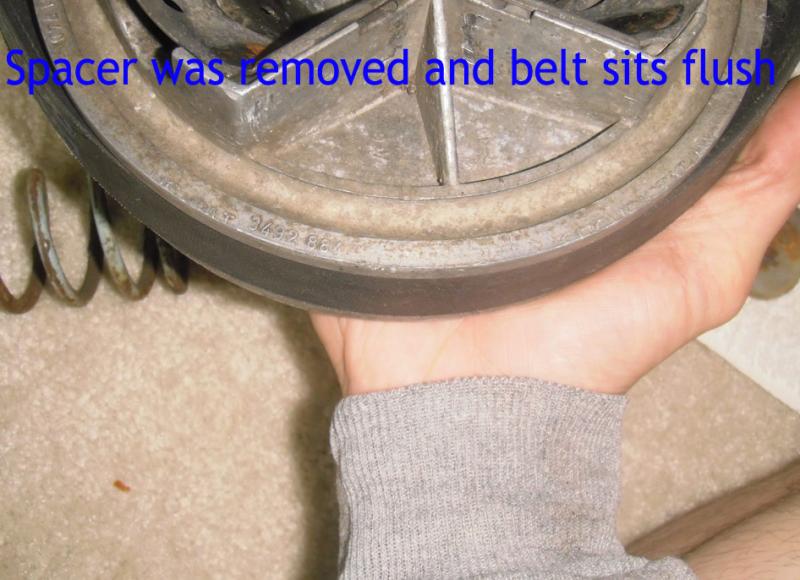

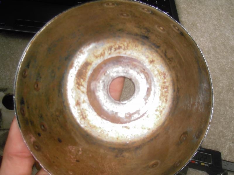

Today I tore this powerbloc apart that murph gave me off a machine he just purchased.. Several problems with the clutch I believe I found.
Odd number of weights distributed through 3 pucks (11)
Possible Broken Spring
Odd Use of spacer washer between part on fixed shaft where belt rides and spring bushing

Free length of the spring is?
Pics of the pucks and weights, outer cover?

ask and ye shall recieve
