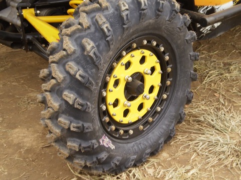

An observation on tires.
I think I was a little surprised at the tires on the UTVs.
I was expecting aggressive tread with wide tires like you see out trail riding in places like Hatfield or Brimstone.
However, the tires where aggressive but not over the top and they where much thinner than expected.
After watching the race I can understand the practicality of the tires observed.
It appears the UTV guys are more interested in digging down to something that can give them traction.
And with IRS suspension this make sense.

So my conclusion is the racers are looking for traction in the conditions they encounter.

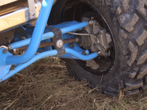

File comment: I don't like radius rod set ups like this. The rod can flop down and damage the rod end bearing. This guy added a rubber band to help this situation.

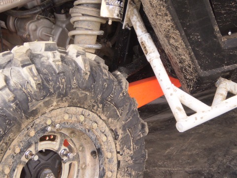

Nerf bars.
I have no idea if these guys are making nerf bars or buying them, many of them look the same.
A little more thought is needed in how the nerf bar is mounted.
In the picture below the bar is attached to the frame with U-bolts in a straight section of pipe.
And the nerf bar has a high end joint just inches below the u-bolts.
1) Attache the nerf bar to a strong point in the frame, not in the middle of an unsupported straight section.
2) Don’t pay for a high end keyed bolt joint then throw u-bolts at it. First I would recommend having it welded if you already paid for the joint. If not, consider a round tube where the ID matches the OD of the frame tube. Split the pipe and weld that to the end of the nerf bar. Then attaché that with a muffler clamp (u-bolt with a crescent shaped end plate). This has a chance to not collapse the frame tube. Also, this bolted joint can not transmit a sheer load (in the picture the load from the nerf bar will slide the joint up).
3) I don’t like the tube sticking out in front of the tire. If a tree gets jammed in there it will be really difficult to get back out, use a rounded end like the Honda line Pilot nerf bar (not an endorsement for the Honda line Pilot nerf bar).

Homos?, Morons? Geeze pretty harsh? At least they're racing.

All the racers were tire queers nobody running the OEM tires?
I havent done a lot of mud but the OEM tires on my RZR work perfectly for everything I have thrown at them not once have I thought wish I had more traction or actually needed more.
Taller tires would be great for rutted up worn out trails they are racing on :-)
Never understand why morons mount nerfs and bumpers like that straight on with the frame nothing to give, straight on is ok if your mount is weak enough its going to bend before the frame does, I prefer mounting tabs off to the side of the frame to reduce the chances of frame damage, I always thought bumpers and nerfs are designed to absorb some of the impact energy hopefully enough where the main body or frame never sees damage but sooner or later you exceed the capacity of the bumpers or nerfs and all are damaged.
