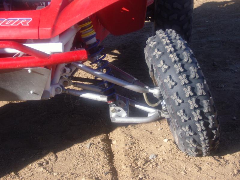

Well you will not believe this until I post some pics which I will do later, I snapped yes snapped my left front lower control arm, 1 inch. .095 Chromoly.

Oh my !!
I wonder if all those long travel Pilots should have the bottom A arm fish/skid plated ??
Obviously more going on there in the suspension than I thought. I would have thought that an A arm would break between shock and wheel and not behind the shock.
PostPosted: Sat Jan 20, 2018 2:19 pm
CO, yes it should most after market Racey arm have a plate on bottom that help take up the shock load. With the shock location and wheel rate that far up the arm it subseptable and to breakage form all the welding. I would say it broke there due to the additional tube supporting the arm close to the wheel.
Also look at the stock Honda pilot arm . Good old Honda once again on top of it. This is why on mine I move the shock closer to the wheel on the lower arm. Not only better wheel rate also softer spring rate for bottom out poundage.
I should also add look at the arms in the other post for new long travel . Same thing no plate or reforcment with with shock mount further up the arm. . The plate is welded along the bottom not all the way around and spread the load out. Not to big as the tube need to have some flex.
I am by no means a suspension guy, but I look at stuff from a millwrights point of view, and that's what I see. That could have caused a very bad wreck and then the machine would be smashed up and you wouldn't know what caused the accident. You probably would have thought the A arm got smashed during the big crash. Yeah I like your idea of mounting the shock close to the wheel. But like I said, I am no suspension guy.

Chromoly and HAZ, tricky stuff.
I'm guessing it broke right at the weld of the cross tube.
