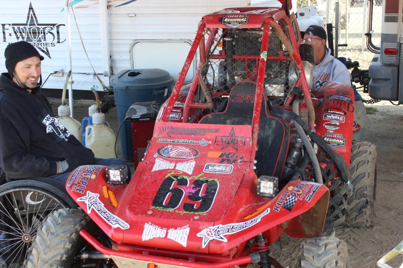

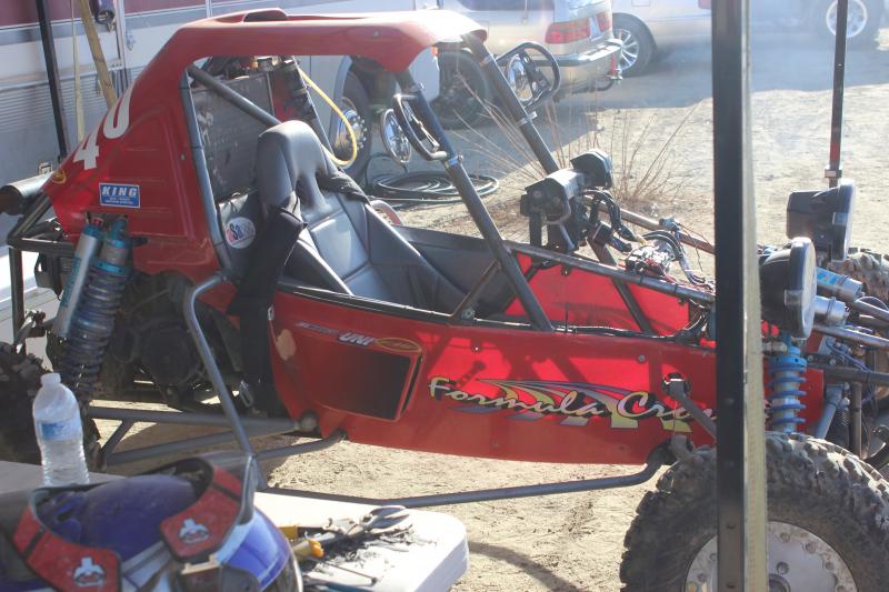

Here are some pics from race day. My 583 needs a top end Steves ran great.

Looks good how did the races go?
Straighten out the rear bumper best you can then weld some 1/2"x1/2" angle iron over the vertical tubes like this, makes it stronger where it gets hit and the edge of the angle bends and weakens the mutts bumper that cant drive and is running into you bumper :-)
They do this on the rear of the briggsbuilt cars rather than using a bumper, holes are drilled in the angle to reduce weight.
Feel free to sharpen the edge of the angle before you install :-)
