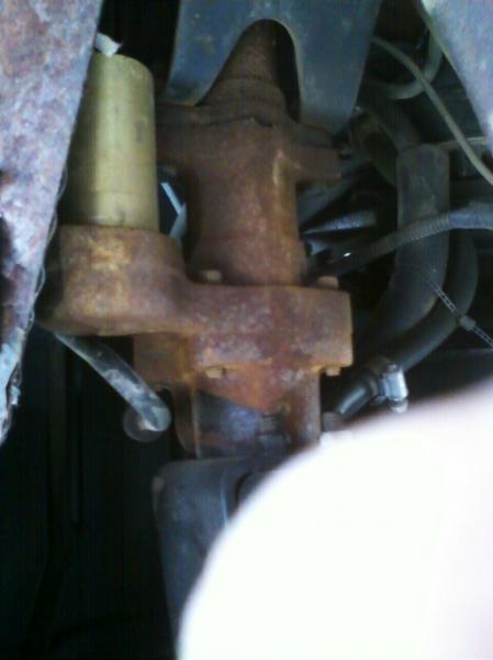

I just got back from the truck shop. There is a power assist unit between the master cylinder and brake pedal actuator that has two hydraulic lines coming into it and one going out. One is from the steering box and one is from the power steering pump, the "out" goes to the power steering pump. I talked to the head mechanic and he said he would make sure the tech that works on my RV will check out this unit. I posted a pic of the assembly. Would I hear the hydraulic power assist pump when I apply my brakes?? I used to drive big box truck on an old job I had and I remember when applying the brakes sometimes you could hear that pump whining. The mechanic at the truck shop said that you might hear that sound on electric pumps. I didnt see any wires coming from my pump(unit). He also said that his mechanics "should" have checked that power assist unit before telling me I need calipers and pads, although its probably a good idea to replace them since their 20 years old and Im sure they were not properly bled throughout their life. So in conclusion there are two high pressure lines going into the power assist unit, one from pump and one from steering box, if the one from the pump was clogged or something, then I would still have power steering, which I do. So that unit could be bad even though my power steering is working, correct?
