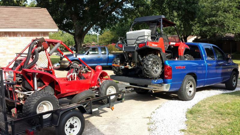

Ive thought about getting trailer hitch put on my Kia Optima just to pull the Pilot up there and camp in a tent instead of pulling travel trailer,would definitely help on gas
But now Ive got the rzr,if I wanted to bring both I'd need to buy another trailer.Right now I can fit everything in my garage,already paying storage fee on travel trailer,don't want another storage bill.
I can carry the rzr in back of truck but I wouldn't want to carry it all the way to OK like that,I'm afraid the trucks gonna collapse taking it 30 miles down the road,lol
