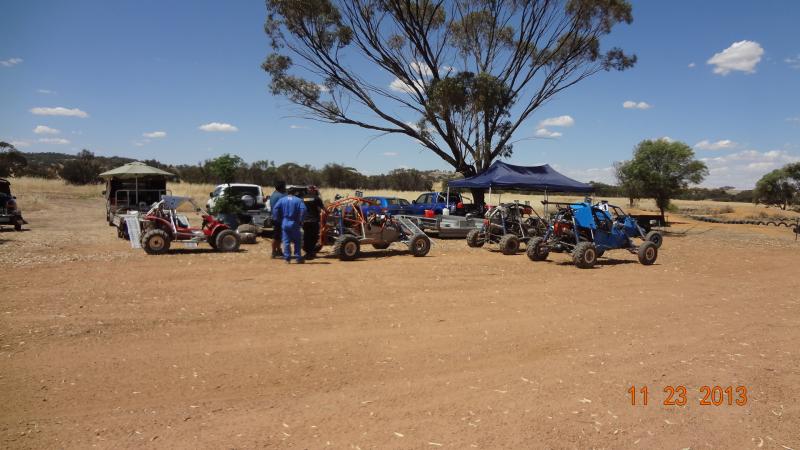

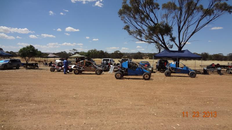

Thanks Rusty,heaps more lil ones to come,monotapuss after a while! :-)
