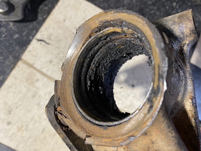

Today I blew the knuckle out in my 400 pilot. and my 600HO pilot has carbs which act like moving targets.

Its a new day - gotta get better. Post up some pictures of the knuckle. You got me curious. Did the upper ball joint give way or did the bearings fail?

The ball joint is fine. Looks like a sealing issue may have caused major bearing failures. This was just rebuilt with Nachi bearings and new seals not even 6 months ago.

I don't think I have seen a failure like that before. Man that looks chewed up. Are the pieces of the bearings lost in the sand?
Plenty of grease. Gotta get those races off and inspect - see if they spun on the hub shaft or if they spun in the knuckle. Hopefully all is good and you just need new bearings and seals.
I would inspect the other side as well.

The grease everywhere is because the failure split open the axle boot and slung grease everywhere.
Oh, both the hub and the knuckle are destroyed. Also the axle took a beating as well. Two main parts are going to get replaced and fingers crossed the axle did not lose life #9 out of 9.

Zero - I have to ask - did you have the spacer collar between the bearings when you serviced it 6 months ago?
Part 1 in the diagram. I can not see it in the picture of the hub. It should be between the two inner races.
And if you did install it, did you measure it to make sure it was within spec (not to thin)?
