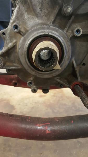

Finished machining your shaft.

Thanks so much for this shaft, opens up a whole new world for conversions.
PostPosted: Mon Feb 22, 2016 10:01 pm
What's the scoop with the shaft? Made new or modified existing? What cv cups and axles are you using. Perhaps I should sit back and enjoy the build, letting the details flow as they may. This has sure got my attention.

The shaft I made from 4140 chromoly. It's identical to the shaft I'm using on my LT617 build. It uses the Polaris ranger shafts. The arcade game is virtua fighter. If you look closely at my build pictures. My odyssey is sitting on a 8' dynamo air hockey table I covered with a sheet of plywood.

Using the shaft pictured and the Polaris CV shafts the stock 350 bearing carriers can not be used, the axles stubs on the end are too short for the bearing carrier or hub, a pilot rear hub will work with them however. Jknarfal is working on designs for new trailing arms and or modifying a new carrier to fit in the stock 350 trailing arms, which is proving to be a real test of skills, looks like a new trailing arm set up may work best for the axles.

Very nice work, jk! That shaft is the keystone in the conversion to plug-n-play axles.
I'd say if you were switching to a Polaris axle anyways, you'd want to use something other than the stock carrier & t-arm simply to take advantage of the additional angular travel in the new axles. And then you could go one step further and convert to outboard brakes. Sell you caliper, rotor and stock axles and you can almost pay for your conversion.
PostPosted: Wed Feb 24, 2016 11:00 am
Posts: 642
Yes plug and play. I could cut the shafts to accept several kinds of cv shafts. As long as the male end of the shaft is small enough to leave some material there it can be done. I already checked Honda civic shafts there too big in diameter. The rotor hub I made uses the buell 1125 rotor and utilizes the stock caliper. If one wanted to do outboard brakes then this hub just wouldn't be used.

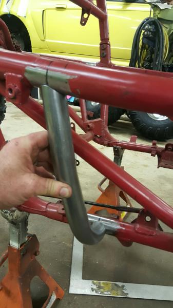

More progress made. Front brackets and jig.
