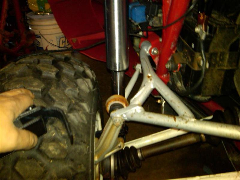

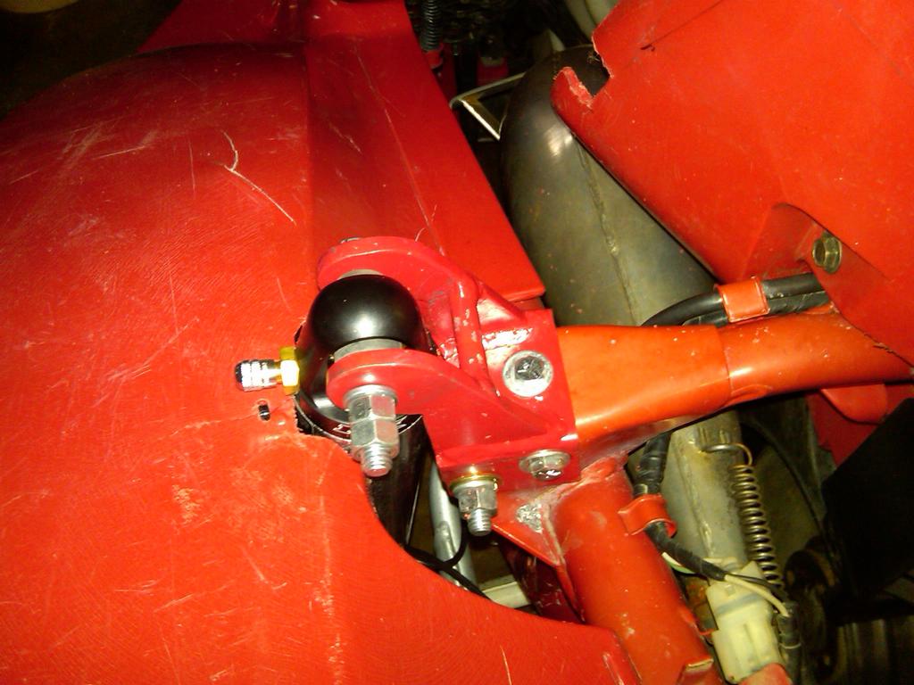

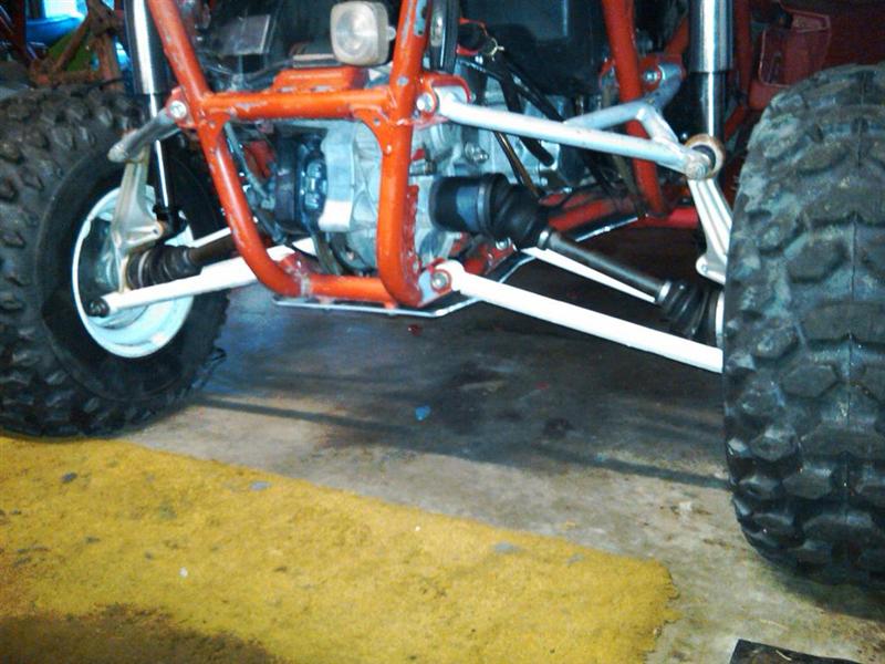

Installation pictures for the rear shocks and Lutrev mounts. The kit inproved my clearance by 6 inches from the stock shocks.The rear mounts were very simple to install, and I added a inner sleeve in the stock brackets which wasn't included in the kit-thought it would make the kit even better.I used old RANCHO shock sleeves for a ford pickup they fit perfectly and help brace the upper mpiunts to the stock mounts IMO.
File comment: the rear sits 6 inches higher then with the stock shocks
