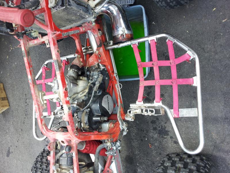

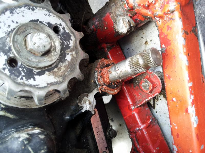

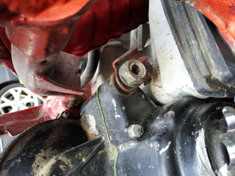

Ok, tough day today. Stripped the project down to bare frame and boy are there a ton of hidden troubles with this TRX. First and foremost I do not think the Engine is a TRX bottom end as the back of the cases were wearing on the swing arm badly-it appeared to me that the cases are meant for a 86 atc as the swing arm goes through the cases in the rear.
The frame is cracked in numerous spots all over, and repairs to it in places are poorly done.
Also I cannot get the rad out of the frame, it appears the top section is or was bent and repaired and it is just a shade too low and it is preventing me from removing it. Also, the swing arm bolt was frozen, the bearings are toasted in the front, carb is junk, the upper mount on the head appears to aftermarket it is cracked, the stem and associated hardware including bearings and such are all toast,I mean the list is endless.
I need to rebuild it from the ground up, and starting with the frame I do not have a clue if I should try to repair this one or purchase 1 through a member, etc. If this Engine is not the right bottom end, is it worth even buying another Engine for it, I am 90% sure it is a atc bottom end as there is no way that bottom end should rub that badly on the swinger. I'll post pictures later but I compared it too my 86 250r atc Engine and it appears to be exact same to the T.Any ideas are appreciated here as I might just part it out and forget I even purchased it. I am 2000.00 down already, with much more to come it appears.
I also forgot to mention the front arms are all toast,the front wheel bearings and seals gone, needs front brake pads both sides,I mean it is bad. I almost lost it half way through as most of the nuts and bolts are mismatched and that drives me nuts.

More pictures. I am weighting my options here on this project. I can get the frame fixed at my fab guys shop but is it worth it? If this Engine is wrong, I have to purchase at least the correct cases, CSI them and then rebuild the Engine which is not cheap. I am 2 grand into project currently and are looking at a few more to get it right at least. It might be worth just parting it out at the present time. It needs everything fellas, I mean literally every nut, bolt, seal, bearing, brake pad,grips, cables, carbs, rubber mounts, it is trash and needs replacing.
I was researching buying a donor TRX off ebay but that is not the answer either. Any ideas on this project are welcomed as I am at a crossroads with it. It is currently in boxes here at my garage, everything is apart and awaiting a decision.

Yes and No. I figured from researching a bit the frames are suspect on these, so I did expect some issues with it,but so many cracks and poorly welded repairs shocked me! The Engine being the wrong 1 was a total shock. :shock: Also it ran fine and compression is fine too-I did not check items like carb, tires, etc due to I usually replace them anyway on my projects. As to the many missing mounts and such I had no clue as I am new to these machines. I am sure if I look around I can find these missing items, but the larger items like cases, frame, a-ARMS are going to be big bucks.I do not mind investing into a machine, but in this case I really need to think about if it worth it.

Update. Speaking to the TRX forum fellas they feel the broken Engine mount directly above the cases is the cause of that wear, every time you adjust the chain or sit on it the Engine would be pulled back toward the swinger-they tell me the Engine looks to be the right one from pictures and the broken mount is the cause of that wear, your thoughts?

Touch up the frame repairs so they are solid repairs rattle can the frame Honda read reassemble and RIDE IT fix other problems as they crop up, address the other maintenance problems when you have it stripped down, bad bearings etc.
Take more pics of the Engine rubbing I am sure their is a easy fix for that.

Hello Hoser!I took the Engine out yesterday so that picture posted is basically the only photo I got.You feel that mount is the issue?
I can take the frame to the welder,BUT it still needs a ton of stuff to get it to ride condition and I think the upper section by the steering stem is bent down just a touch, I cannot get the rad out of the frame. And if these cases are bad that throws another wrench into the plan. Can I send this over to you please(Engine). I also need all the front arms replaced, steering stem is bad, I need many a part.
I am on Ebay and the forums currently researching the costs of a frame replacement.

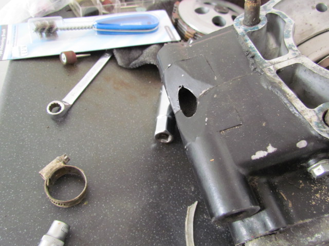

Hey Mud/ Hoser
if you post a pic of the front of the Engine (where the front mounting bolt goes through) i can tell you if they are ATC or TRX cases but even if they are ATC cases they shouldn't hit the swinger......i have new Engine cases and loads of parts for the TRX if you need anything??????

Easy way of telling ATC cases with TRX is the front mounting bolt hole....
ATC has a taper ground in to the centre of the cases.... the TRX case has half of the same hole chopped out on both cases....there are some internal differences as well, but you can match ATC and TRX cases together....
Mud i'll have all the mounts/mounting rubbers you need...i have got a frame but shipping will kill it from the UK....and i don't have any front arms.....but have loads of other parts ...make me a list up :-) :-) :-)
