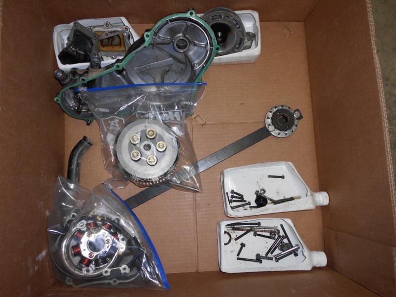

Before moving on the clutch system sub assembly is assembled, inventoried put into a zip loc bag then put into the parts box with the rest of the parts so nothing is lost.

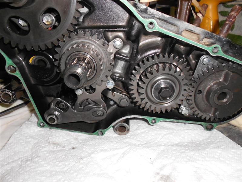

Back to the other side this unit has a billet bearing holder for the balancer shaft.

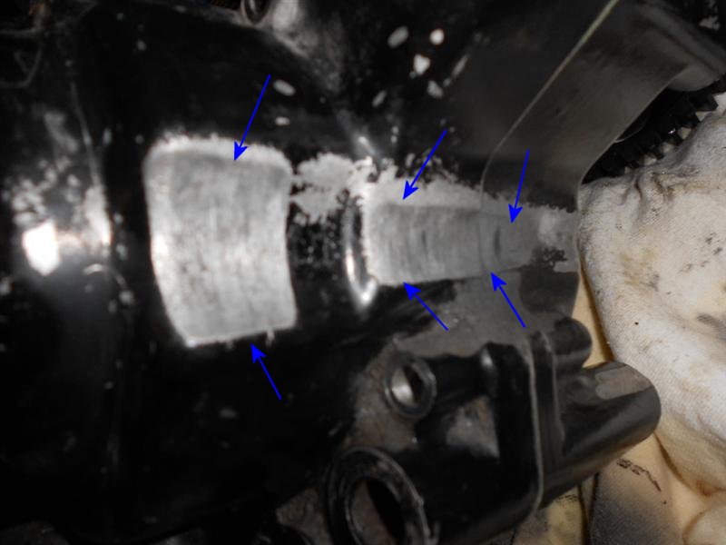

More pics of the carnage caused by a broken chain.
This happens when owners are too stupid or too lazy or too tight to replace their chain and sprockets, anybody that owns a motorcycle or ATV that is chain driven needs to budget a new chain and sprockets for each riding season, at the end of each season install a fresh chain and sprockets and NEVER have these problems while your changing them inspect and or replace the rear axle bearings.
"Case savers" are for people too stupid to inspect and recognize they need to change their chain and sprockets, my first ATV was a 1971 ATC 90 I have been a ATV motorcycle owner since 1973 I have never broke a chain I have never damaged a machine because of a bad chain or sprocket I learned by watching other destroy their machines haha.
Weld repairs
Here is where the cases were rubbing the frame or swing arm because the Engine mounts were broken.

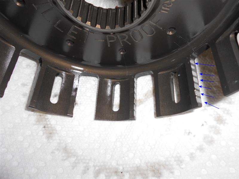

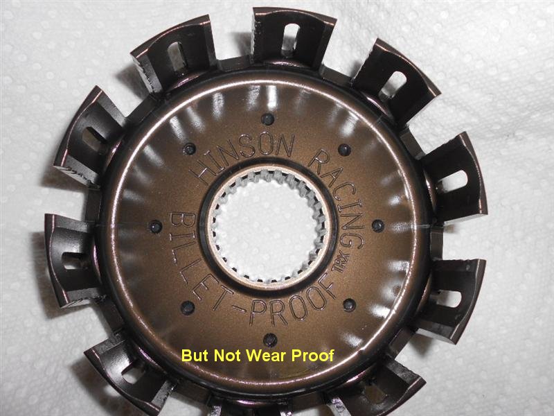

After market clutch basket.
Clutch basket is TOAST. Let me know what your price on a replacement is, 'cuz the local Honda shop here (HondaEastofToledo.com) has hooked me up with LT500R baskets...$208 for Hinson and ~$225 for factory. TRX's are more popular than the Zilla, so will likely be cheaper yet. That is...as long as the hub, pressure plate, and drive gear are still good.
I never understood why the clutch basket is the wear item rather than the clutch disc fingers (??).

Looks like the Hinson "Billet Proof" basket and the stock hub have "a groovy kind of love" going on (classic Phil Collins, lol). Clutch plates look okay w/ some life left, eh?
Gotta' love all the Skillbilly stuff to keep an Engine together. Even though it would've prob cost them less then $10 to do it right!
