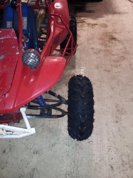

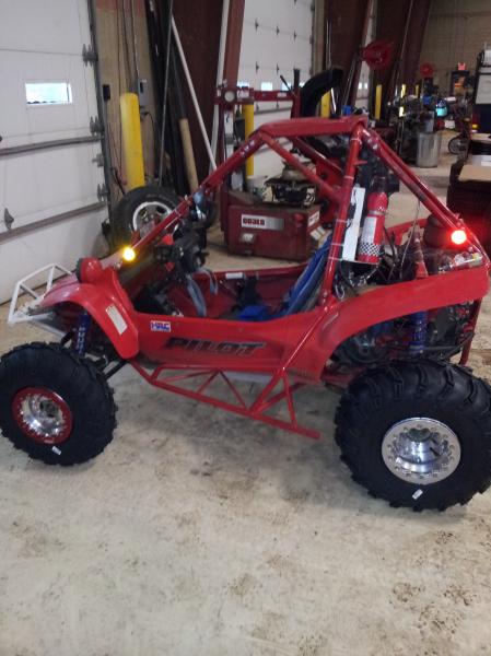

Pictures of rims and tires installed. The offset for the front rims is pretty steep, did not think it through when Steve gave the dimensions of the rims, but I will try them out anyway.

Sweet. I actually like that width, it looks like you can charge right into the corners. And the new tires will make your shop smell just like a motorcycle dealership showroom each morning when you go out for a little while.
PostPosted: Sun Jan 12, 2014 1:42 pm
Yeah looks cool wait until you hit the first rut or bump in the trail and it rips the steering yoke right out of your hands and draws blood, been their done that, seen it happen to others simple leverage thing or "pain amplifier" when its not trying to rip the steering yoke out of your hands it also gives the driver a feeling they need to keep a death grip on the steering yoke and causes forearm pump and driver fatigue.
Where is Stoneman I remember the time he showed up to the Badlands with a cool looking offset front rims and went home bleeding from both hands haha, we found a cool jump and were taking turns jumping every time he landed on one front tire slightly it ripped the steering yoke out of his hands he even had his buddy try it a few times so he could experience the same pains haha he fought and cussed them rims all day long.
Those rims were not for long.
When I bought my Pilot the front tires were almost bald, then I had no access for changing ATV tires and the local stealer wanted 20 bux to change a tire, it was cheaper for me to buy new steel rims and tires from Rockymountainatv.com so I did those wrong offset rims did the same to me and only lasted on my Pilot one ride trip, I gladly paid the local stealer to install my new tires on my OEM rims, lesson learned.
I suggest you buy wider offset rims and give it a try fact is have some wheel spacers made so you can get that extra width, looks cool and will "charge" right into any corner better :-)
If your looking for a wider stance, better steering, less drivers fatigue I suggest +2" A arms and FOX shocks in the front with stock rims. http://www.pilotodyssey.com/PO/viewtopic.php?f=5&t=3825 Faster, safer, less painful than all the other stupid attempts and ideas.

Got to be honest I purchased the rims from Steve to help him out and I have Plus 2 ams on the pilot as we speak.
I am going to try the offset as is. I don't race I don't jump I trail ride and the width might be a bit much but the also it might not help, but maybe it will for me in my rocky terrain where I could use a bit of help.
I have driven with an out of adjustment Yoda kit and I never had the steering wheel pulled out of my hands. never. I didn't buy the rims for Bling I purchase them to help out a fellow member and to upgrade the rims on my pilot.
I resent the statement that I am obsessed with buying alumn bling. if the rims are inferior I will scrap them for stock my stock rims are all bent from TurboTexas hitting rocks with them.
PostPosted: Sun Jan 12, 2014 8:22 pm
haha I was speaking in general I figured you bought them for the bead lock feature.
Yeah for sure if the suspension is not adjusted right it will rip the steering out of your hands I experienced that with my +2" setup when I first installed then again with the YODA +2" arm setup fact is my YODA setup still needs a final adjustment as its still twitchy and not dialed in like my old +2" arms were, its on my list soon as the weather turns to adjust the caster more (Lee's suggestion) its real close so should be fairly easy.
