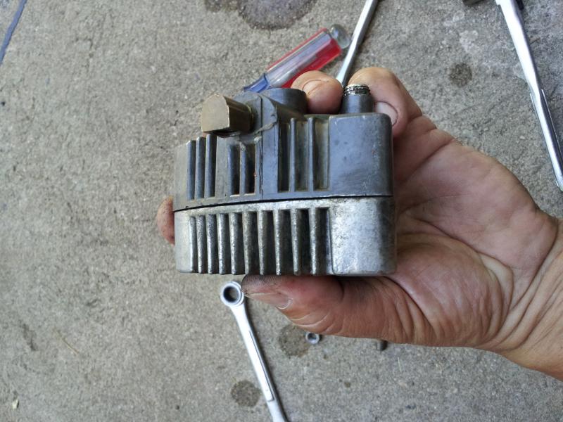

Had some time today to finally get some things done on this. I installed a new starter button in the ride, the old 1 fell apart in my hands when purchased. I also installed a new SCORPION gel battery, drained and filled the fluids in trans and Engine. I also ran into a bit of a issue-the rear caliper is seized up. Any idea on rebuild kits for it, there is no ebrake cable for it, the brake pa-portioning valve I did not touch at all, is this caliper made still, or do they make a replacement by chance? Is the shifter for some reason in any way affecting the rear caliper when put into a specific position? Thanks for the help here!
 Post subject: Re: Triple EEE Gen 3 car
PostPosted: Sun Jul 07, 2013 3:54 pm

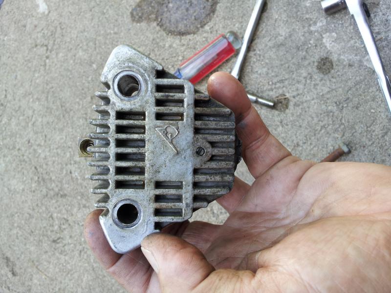

I was able to work on this caliper today and I freed it up no problem. It was as simple as pie. Here is a picture of the caliper

The caliper splits into 2 pieces with the mounting bolts acting as the actual holders.

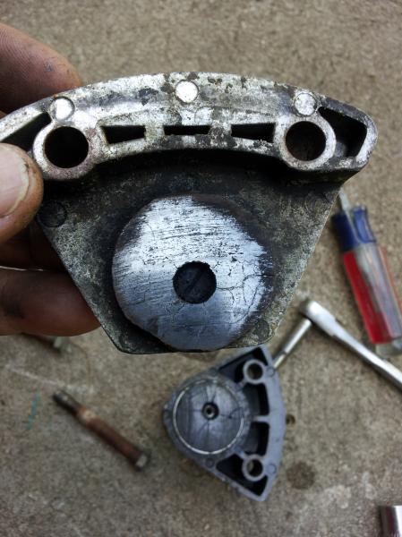

The left side just holds the 1 pad, which is held in by a small screw located in the center, that's it.

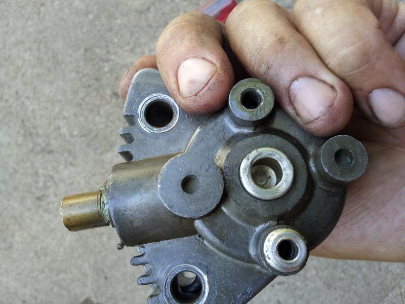

right side holds the actual piston and same as left the pad with screw holding it in. The piston actually goes through the housing and has a small nub on the exterior which helps immensely in freeing it when stuck.In this picture you can see it in the middle of the housing:

After a spraying of PB Blaster and a small c-clamp it freed up easily, I drained the old fluid out of it, took both bleeder screws out and cleaned them and assembled it back together, I had a set of pads here in the parts bin but need to replace them.You can also see a part number in this picture that is the only number I could find on it:

Caliper is made by Airheart inc out of MN.
