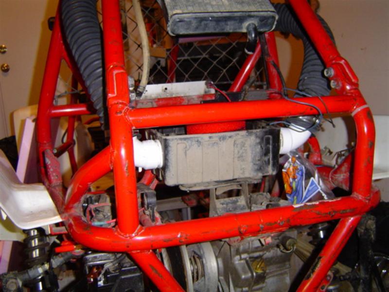

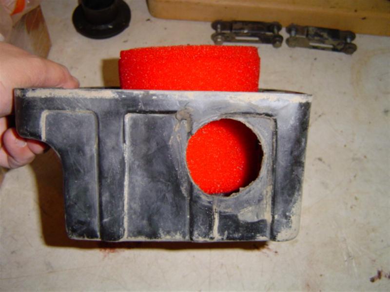

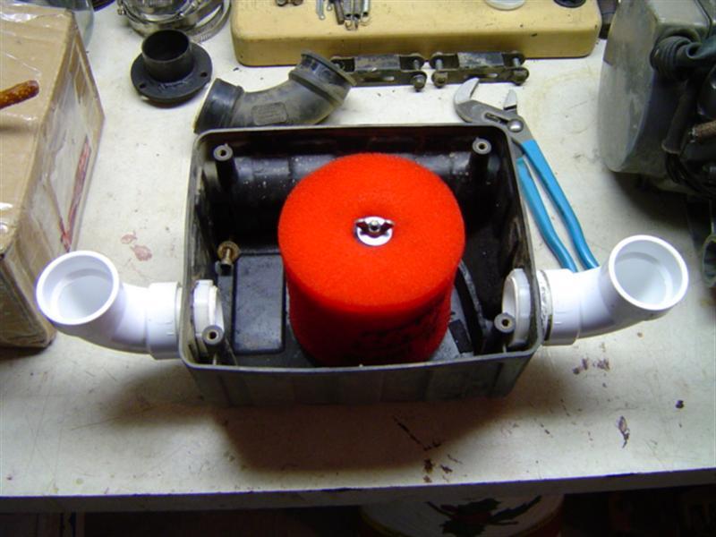

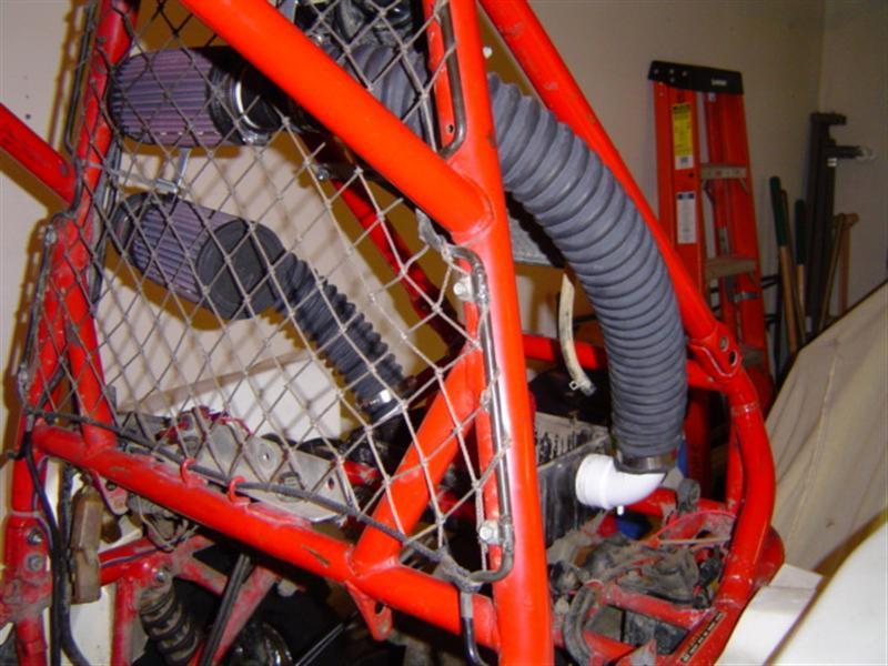

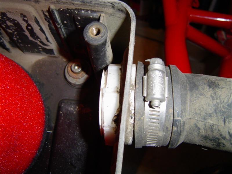

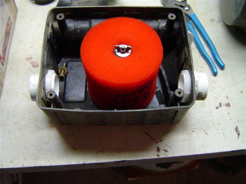

got some time today so I tweaked the dual air inlet set up on the airbox, when I bought the ride it had 2 90 degree rubber elbows on the box, which on the exhaust side was burning on the expansion pipe, so I went to my local Home Depot and bought 2 1 1/2 pcv plumbing elbows and some fasteners as well.Here some pictures of the modification to it.
File comment: when purchased this is what the set-up looked like
File comment: Now after completion-nice and sturdy.
File comment: Fatseners inserted into the side holes top view
File comment: Completed box top view-I still need to chalk the ends to waterproof it.
File comment: Quick look at the fasteners I used-they are threaded on 1 end with a plastic nut.
File comment: Installed on ride, front view.
PostPosted: Sat Nov 10, 2007 4:16 pm
More pictures:

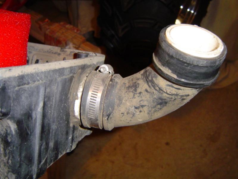

File comment: Hole saw works great for these holes, any local hardware store has them, cheap.
File comment: Side view of new elbow-this 1 will not burn on the expansion pipe like the rubber elbows previously did.

I have also upgraded the air filter as you probably have seen to a UNI, I really have had very good luck with them in the past and with the new dual air inlets sytem with prefilters I expect this filter to not see alot of dust, etc.

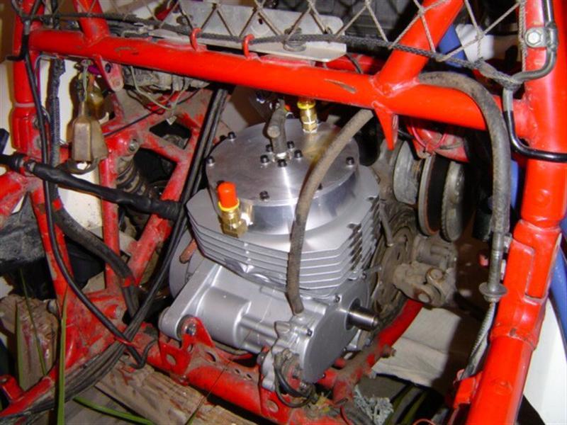

Got motor (( Internal Combustion Engine ? )) back today just in time for Christmas, there are some upgrades to it:

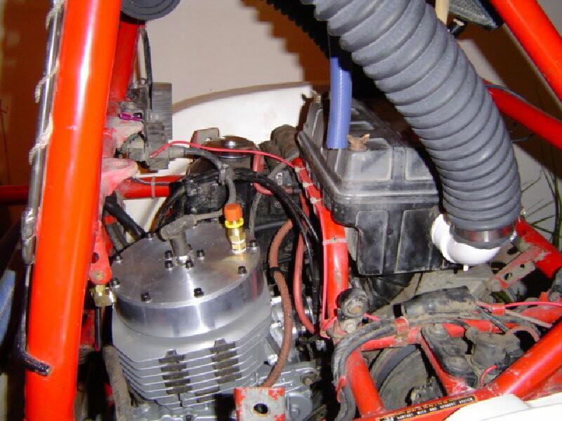

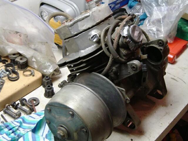

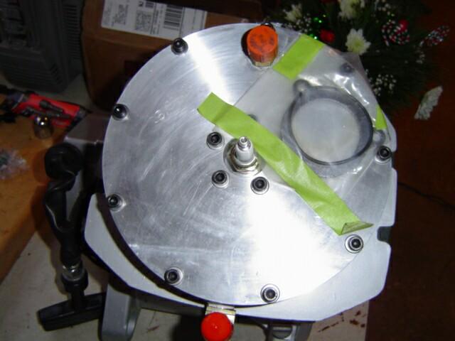

I installed a new cylinder on the motor (( Internal Combustion Engine ? )) as the old jug, head was a complete unit and it has issues with the bore, etc.I will resleeve it in the coming weeks.According to ED, the bore was not straight and when he bored it, it is out of Piston sizes for Wiseco -we will see after a complete CSI at the Hoser compound later this year.UPGRADES!!
As you can see I installed as well a new RAND water cooled head on the motor-UPGRADE!!
I keep the Mosberger intake but UPGRADED the reeds to Boyesen Fiber reeds-part # 18-330 from the carbon fiber ones that were previously installed-I prefer them for my powerband.

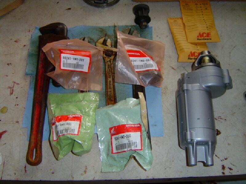

I also upgraded to a totally new starter from Stockers Starters as well
I had the bottom end totally rebuilt, new bearings, seals, gaskets, rod bearing installed as the old 1's had some wear on them-I'll ask Hoser if he can CSI the old parts.
Heres some pictures of the new motor (( Internal Combustion Engine ? )) minus the starter right out of the box, no damage BTW MY SHIPPING SKILLS HAVE GREATLY IMPROVED .

File comment: Before picture-remember this head?

File comment: New Rand water cooled head-

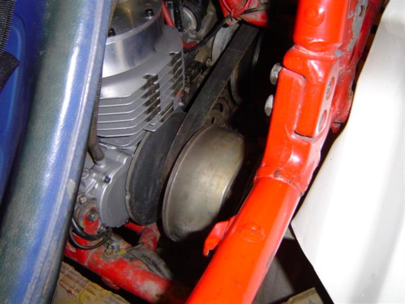

PostPosted: Sun Dec 30, 2007 2:42 pm
Installed the motor (( Internal Combustion Engine ? )) today-pluss upgraded the motor (( Internal Combustion Engine ? )) mounts, starter, battery cables and starter soleniod as well.I ran into a problem as the carb bowl is hitting the trans to motor (( Internal Combustion Engine ? )) bracket-see pictures below.Also, when I got the motor (( Internal Combustion Engine ? )) back, Ed had said the starter gear was bad-he wasn't joking at all, look at the pictures and always check the bolts that hold it in, mine was loose when I took the motor (( Internal Combustion Engine ? )) out, guess that's what did it!!
File comment: motor (( Internal Combustion Engine ? )) in in finally, got the tank as well in too
File comment: New motor (( Internal Combustion Engine ? )) mounts, starter as well

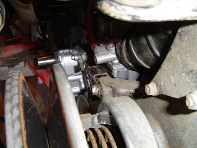

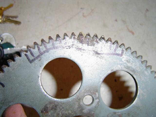

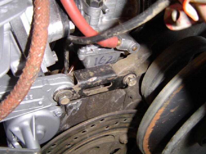

File comment: carb hitting bracket see?
File comment: another view of bracket

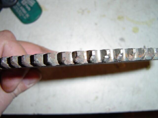

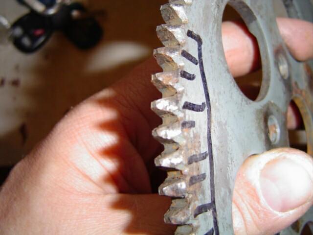

File comment: Starter gear bad teeth-no wonder it never worked!
File comment: Another view of bad teeth
PostPosted: Sun Dec 30, 2007 2:45 pm
More pictures
File comment: Bad teeth on starter gear-theres were 2 other places on it that were bad as well

Whats the other side of the starter gear look like cant you flip it over?
Gear on the starter itself ok?
PostPosted: Sun Dec 30, 2007 8:24 pm
I do not think you can flip them over Hoser, and in another area the gear was missing some teeth all together.I sent the old starter out for rebuild but I did look at the gear and no it was fine.

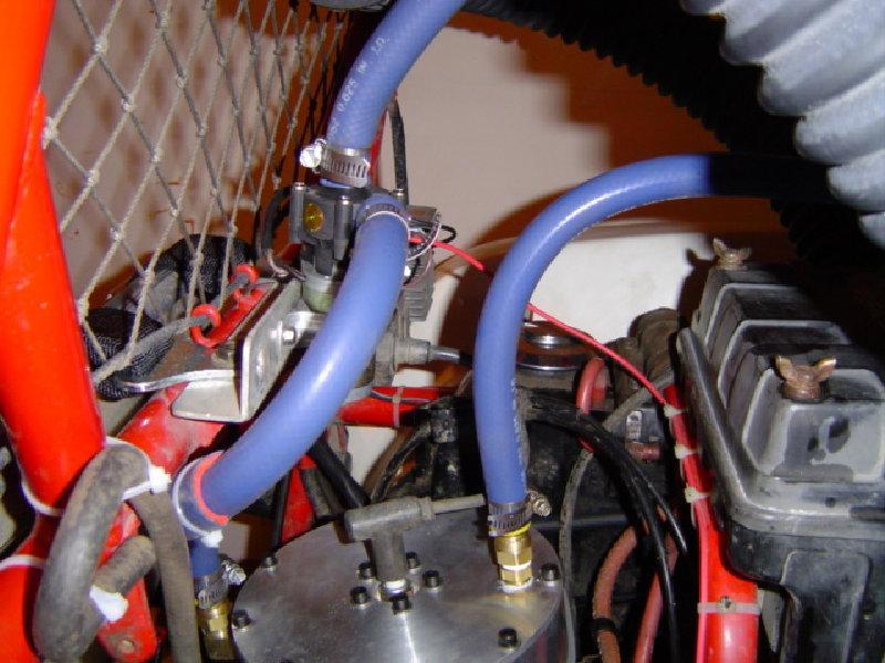

I got everything on the ody and it is ready to go minus the exhaust.The seat, harness,WATER PUMP, HOSES, SWITCHES FOR A FAN AND THE PUMP ARE ALL WIRED - everything is on and ready to go.I'll of coarse have to remove the seat for the exhaust install but that's no biggie-I'll upgrade the front tie rods with Hosers patent pending tie rod mod in the coming weeks, as well as Engine break in and fine tuning on the carb as it was completely rebuilt as well.This project has been a real blast to me personally AND i LOOK FORWARD TO JUST RIDING IT, THERES NO POWDERCAOTING ON THIS BABY AT ALL.
I forgot to mention that I took the 102c clutch apart and completely cleaned and lubed it up, the sliders have some wear on them but not to to bad, the spring is a red spring whicH I am usure what the spring chart is for the revs on that-I'll check on the board I know there is a chart posted up somewhere.SHOULD HAVE TOOK PICS BUT I FORGOT THE CAMERA IN THE CAR-SORRY BOUT THAT FELLAS!
Also, I need to install the belt covers for safety issues in the coming weeks as well too.
File comment: 102 c clutch cleaned ,lubed and back on the motor (( Internal Combustion Engine ? )).

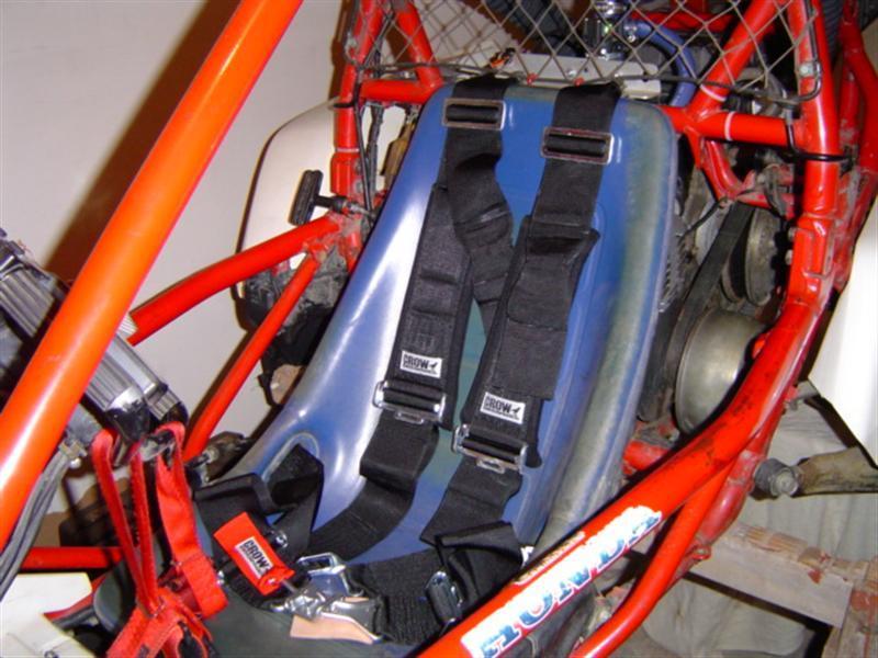

File comment: New CROW harness made to my hieght, shoulder pads upgraded for extra support on my shoulders.
File comment: Upgraded to a electric water pump for my water cooled system-easy install, clean and simple.
