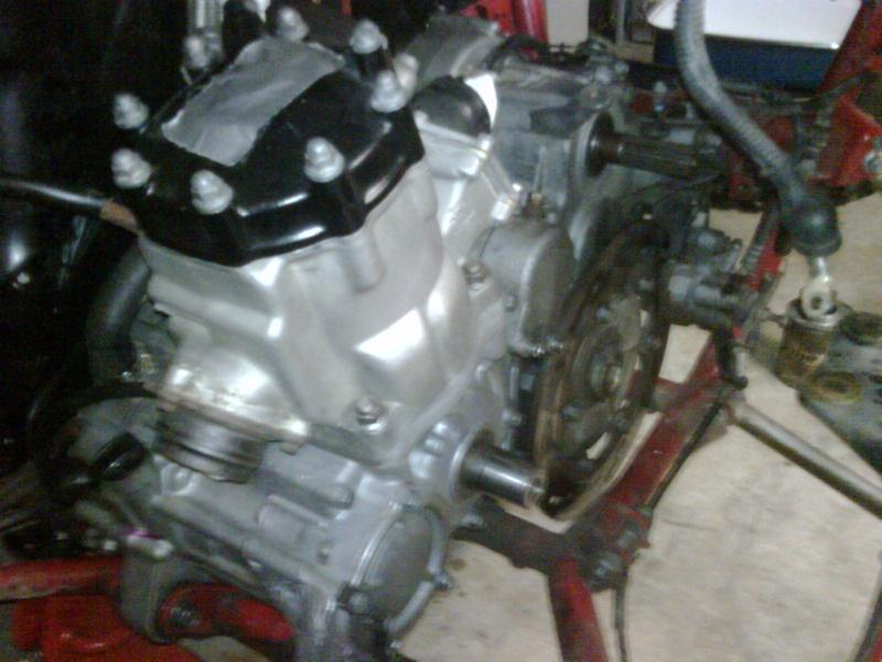

Installed the Engine and trans today. Installed the rear caliper with new pads as well. Installed the rear LT shock brackets too.

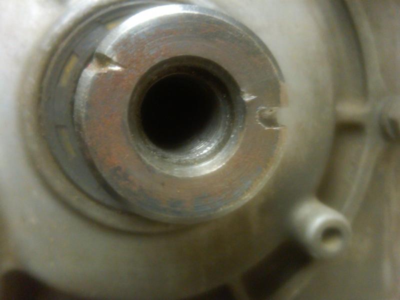

Here is a great reason why you need to check everything and take your time when installing the motor (( Internal Combustion Engine ? )) to trans plates. This is plain just skill billy shade tree mechanic workmanship. Inexcusable.
File comment: why?

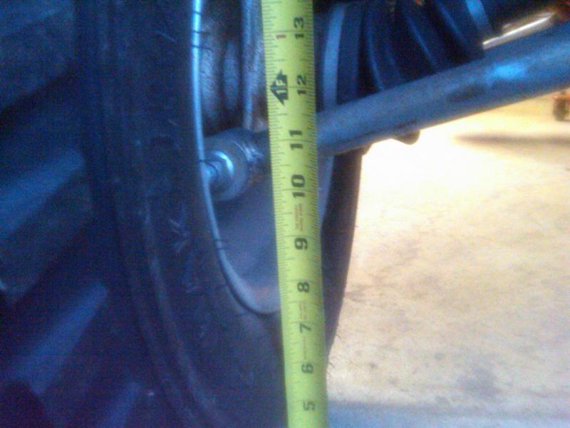

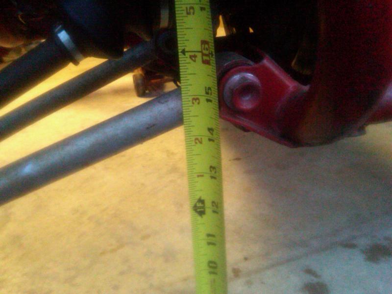

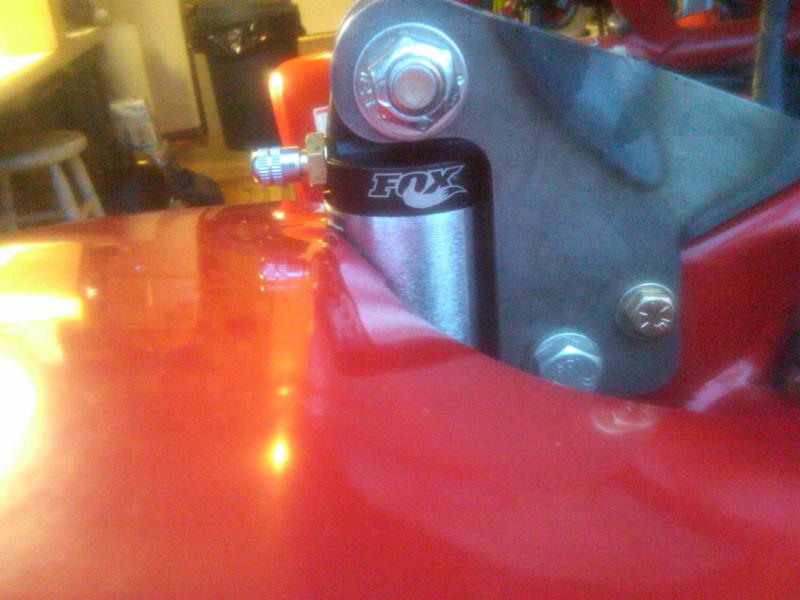

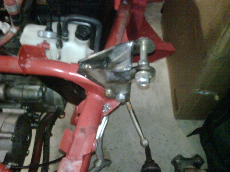

Some pictures of the rear suspension with the FOX AIRS and DC rear LT shock brackets. I did some quick measurements as well for documentation.
