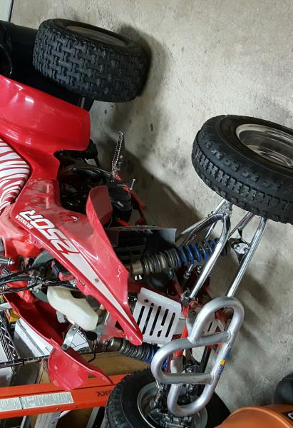

Got this project back up on the workhorses and are in mock up stage right now, Engine is at Hosers for rebuild-stockpiling parts for fitment, then dis assembly and powder. i HAVE ALREADY on it Lonestar +2 a arms, Lonestar +2 steering stem, Lonestar anti vibe clamp, Laerger extended swinger, Excaliber +4 rear axle, Durablue axle hub, sprocket hub, brake hub, Sidewinder sprockets, CPM alumn air box, 38 PWK carb, many more!

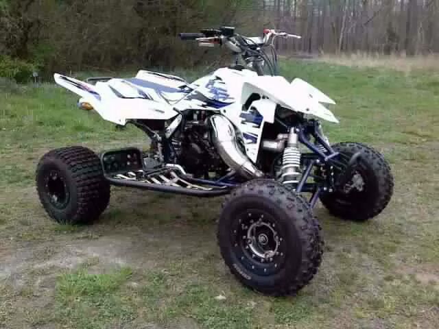

I am a life long 250r fan...had every year from 86-89...the frames are notorious for cracking everwhere...my buddys 250r just exploded do to the bottom Engine mount breaking off...anyway i wanted the new school suspension ect. So i built a ltrx250r... its a 2009 ltr450 suzuki with a trx250r motor (( Internal Combustion Engine ? )) mounted in there...its almost like the frame was made for it

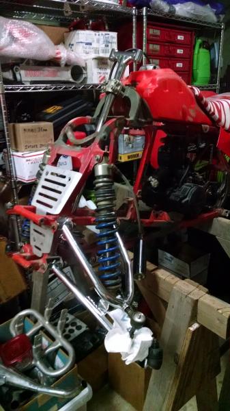

Working on the project currently. Here is a little picture.

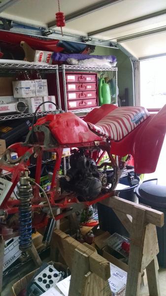

got the project about 75% completed, finally on it's wheel waiting for small items like grips, headlight switch, small items, still needs to be started, heat cycled, air leak tested, check water pump and rad, set shocks, rear carrier tightened, much more but all small items.
PostPosted: Sat Jul 30, 2016 3:08 pm
Well after many set backs finally she is completed. Compression is 197 psi, needs some carb adjustments and plug chops, front end adjustments due to the plus 2 Lonestar a arms but otherwise ready to ride.
Since last postings I assembled handlebars, fixed a very hard to find loss of spark ( replaced the entire wire harness CDI (Capacitor Discharge Ignition) unit)replaced the headlight switch, installed grips, plastics, checked all electronics hardware including stator, voltage regulator, pulse generator for manual specs, heat cycled it, replaced all brake pads, bleed nad ran new fluid to all cylinders, and double checked all torque values on all mountings.
