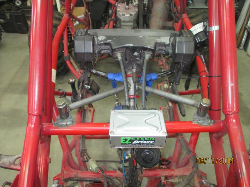

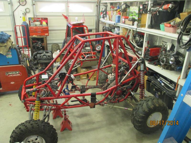

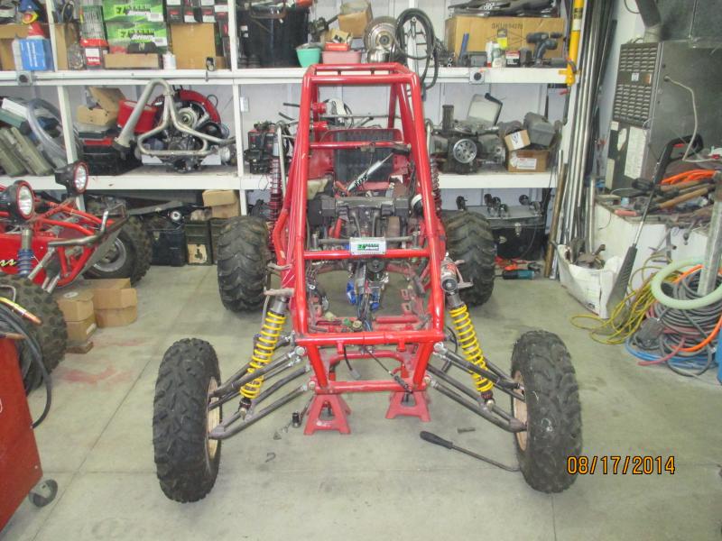

Waiting to be picked up---and I cannot wait to ride it!

Big big thanks to Dave, his sons and family for making this a dream come true for me. Him and the kids worked for months on my project and after going through some tough times finished and I could not be more grateful!!I wish Dave all the best and hope all is well!! Thank you sir really really thanks a bunch!!
 Post subject: Re: Project 2800 pilot
PostPosted: Mon Sep 01, 2014 7:44 pm
Posts: 550
Greg you are very welcome, this has been a very trying time for me because of illness that has really sunk its teeth into me, what started out to be a quick Long travel conversion found me spending more time in bed than I could spend on Gregs pilot. He has been nothing but a good friend the whole way threw, never putting any pressure and always giving me nothing but support and positive comments. Greg has what I call a super pilot, 14 inches of usable wheel travel in the rear with 12 in fOX coilovers with a large amount of work done to the inside with the rear wheel moved back nearly 4 inches giving more wheelbase and stabilty and putting the wheel where the suspension likes it the best for smooth movement, and about 15.5 inches of usable travel up front with the front arms adding to the wheelbase also, with super ATV electric power steering giving zero feedback threw the yoke that takes pilot driving to another level. You can drive threw the roughest terrain with no kick back threw the wheel at all eliminating any death grip or arm pump.

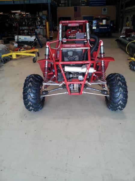

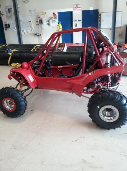

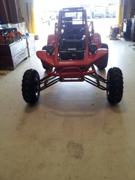

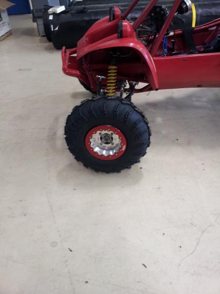

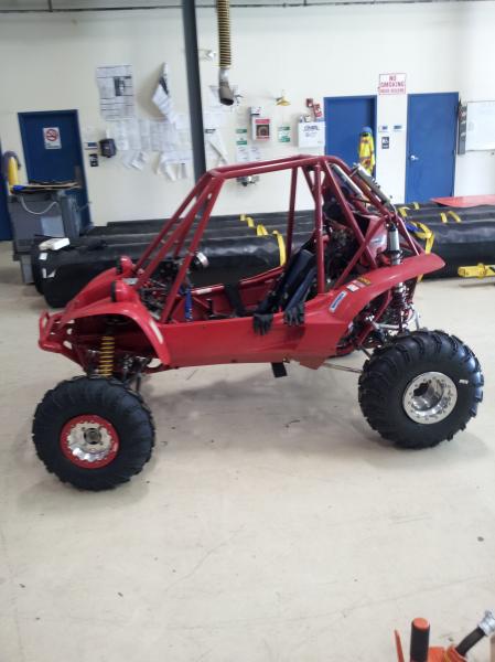

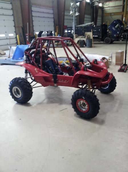

had some time this weekend to install all the plastics and shore up this pilot. it needed a little things to be done like extensions for the tachometer and other small items but the plastics were a real pain in the butt. everything had to be custom fitted to fit the electronic power steering and multiple bars for the roll cage and such.
I cannot run stock rims the offset hit the tie rod ends so I installed my OMF rims off of the terrible pilot they work quite well. It still needs some minor modifications to a bracket or 2, and then it is time to ride
here are some finished pictures.

Nice job Greg, looks great with the plastic on!

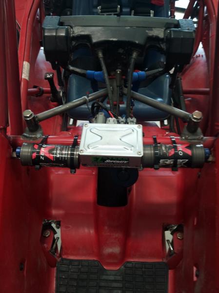

Thanks Dave for all the hard work, and I forgot 1 picture, but I saved the best for last!! My pride and joy that's makes riding so much funner!!!
PostPosted: Sun Sep 21, 2014 6:50 pm
Posts: 550
So I take it you took it for a spin?? Whole new experience with the steering/ Your welcome Greg, real glad you like it! Those wheels and tires are real nice, much nicer than it had on it !!! Very nice

Dave-Co or Mudbogger, can one of you give some more details and pics of the power steering setup? That thing is freaking AWSOME! Great work Dave and congrats Mudbogger:()
May I also kindly ask what is the price tag for something so bitchin? I need to start saving my money;)
PostPosted: Sat Nov 01, 2014 4:52 pm
I will snap some pictures tomorrow for you of the linkage and such. Price I will let Dave-Co speak to you in regards on charges, etc. I think the power steering kits are in the 600-700 dollar price range complete if my memory serves me. I bought several and they gave me a discount coupon for additional units.

Thank you for the nice words, the power steering was massive work and thought the first one I did, slowly refining the application on the next few I did. All 6 of my pilots now have this power steering on them including the bone stock my daughter drives. I drove her pilot several times this weekend and the power steering completly changes the entire handling of the stock pilot you would not believe. Before PS you would not catch me sitting in that Pilot, now it is unreal. Board member Lee Cruz came out to ride with us today with his long travel pilot that I built as well as put a cage on and drove my long travel set up just like his but with power steering, needless to say power steering is going to find its way onto his pilot VERY SOON! He also drove my daughters pilot and could not believe how the whole car performs with it. As Mudd says it is a game changer in the highest degree. It was rougher and tore up out here in Barstow more than I have ever seen it, nothing but ditches woops deep sand woops with heavy cross grain, generally a complete mess from the storms that have hit there, so bad our usual parking-camp area was washed away with 6-8 foot deep rain ruts where we use to camp! arm pump death grip is 100 percent GONE!!
PostPosted: Mon Nov 03, 2014 11:23 am
Dave - Could you share some details? which Power steering unit did you use? I see several kits listed on their website ATV and UTV kits. Could you post a few pictures of your daughters stock power steering setup? If there is a thread about this and I missed it please let me know. I did read that you use the 220 watt system. If this is something you have designed, perfected and selling I do not want to take advantage of your hard work. If you are selling them please let me know. I'm interested in the stock power steering.
