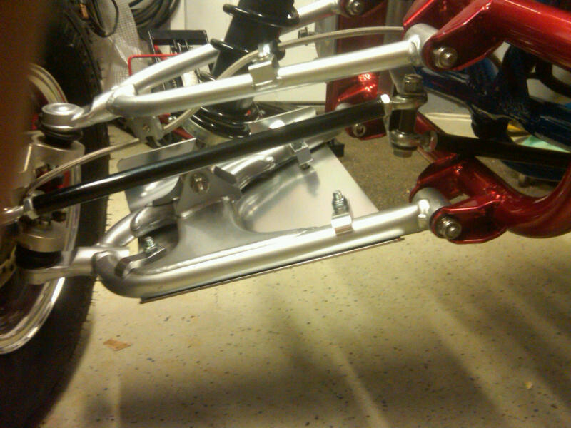

Any ideas on how I could get around the heim? I am thinking I need to see if I can remove that inner heim and place something like this picture in it's place:

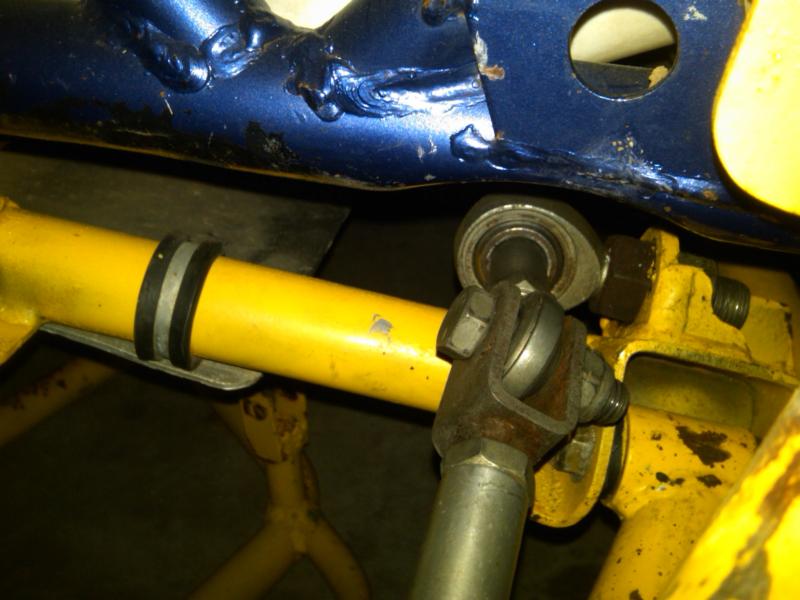

This would totally resolve the limiting of the left to right issues I am having. Any ideas? Here is a picture of my tie rod from top view, it is no where near the middle of the pivot points:

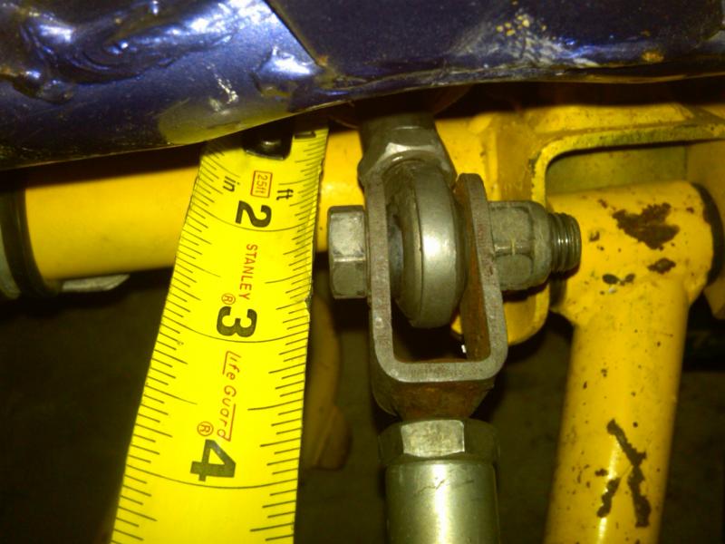

measurement of the lawyer link with the steering at dead center, this measurement is from the hiem to the end of the lawyer link, it shows a little of just how much travel is limited with this set-up.

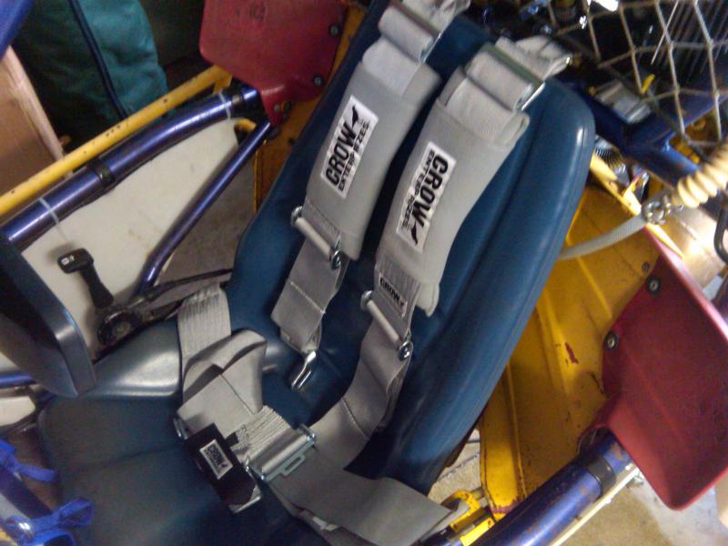

Took some time off this steering to install new harnesses and hand restraints.

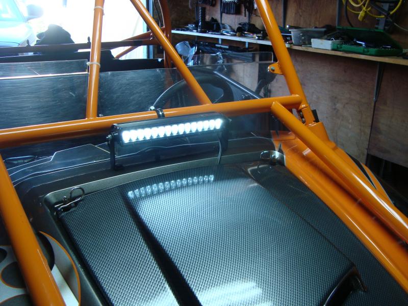

I could not get the lights to work as well so I scrapped them they were all blown out. Took all the old harnesses out as well was not needed. I am going to replace the stock lights with those RIGID lights Nelly installed on his 350 I like the look and the candlepower of them.

Mudbogger you will love the rigid lights.i just put a 10" on my rzr and cant believe how much light it puts out.
