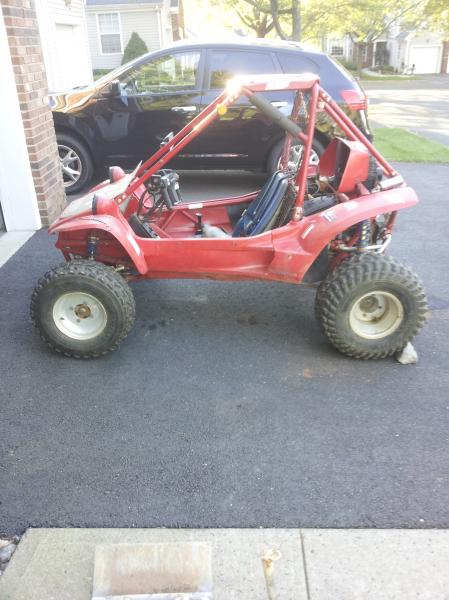

PostPosted: Fri Sep 06, 2013 8:26 pm
Throttle pilot arrived today here. After getting it into the garage i stated in checkin it over. First thing compression check, cold was 138 psi not good enough for me. Was hoping for a higher reading but it is used. And I usually replace the Engine anyway, so lets move on.
Carb slide wqas removed and it is in great shape, not a ton of wear on it, it is stock.
Belt looks to be OEM and to sya it is on it's last leg is an understatement, it is junk.
Clutch is stock OEM, look to have bad wear on the sides and will need to be checked further.

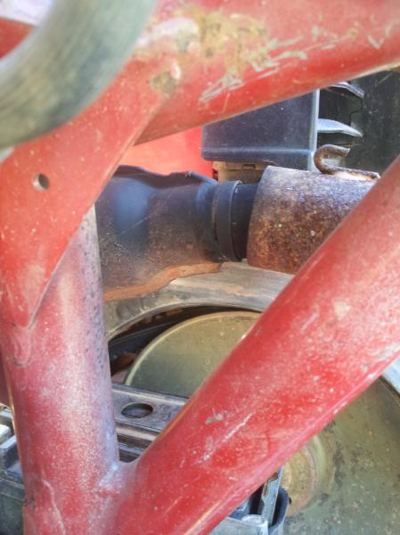

Exhaust-expansion chamber (oem)is hanging off the exhaust flange, not selaed and I assume the flange has some form of wear on it that might require a replacement.
The silencer is as well just hangin on by a thread, not sealed at all on the expansion chamber and is aftermarket, it will be replaced with a stock OEM to match the expansion chamber.
Air inlet is missing inlet assembly and hose, the air filter housing is dirty and need to be totally cleaned, filter will be replaced with a new UNI FILTER.

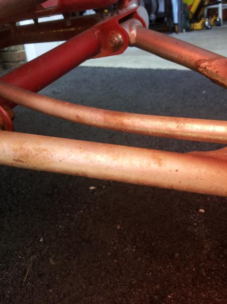

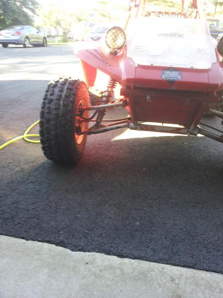

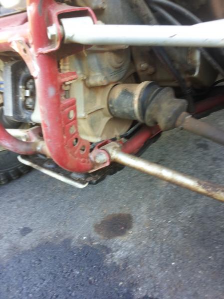

SUSPENSION-here we go- :-) front tie rods both sides bent badly, thing hardly steers.
Both upper and lower arms are bent.It is slight but a trained eye can notice it when looking. Need to all be replaced.
Left side tie rod end bad.
Left side wheel bearing bad.
Rear suspension needs to be completely replaced, every arm is bent some badly!
Right side upper tie rod end is bad in the control arm.
Rear brake caliper missing the E brake arm, no biggie, and the pads need replacement.
Now I don't want to be all negative here, actually some good things on it-the frame other then a slight bend in the top cage is in remarkable shape, underneath reveals really no dings,dents, or scrapping from rocks,the front clip is straight-the trans and rear cv's, stubs and rear carriers are in decent shape, trans shifts well, the cables are free. It does have aftermarket old school rims which can be reused. Shocks are in good shape, the plastics too other then the front fenders will stay on it, it has all the brackets for the fenders, the front foot tub is in really good shape,and overall it is a great Pilot. I will post some pictures in a few here.
PostPosted: Sun Sep 08, 2013 4:59 pm
Pictures.

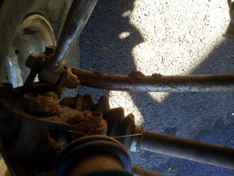

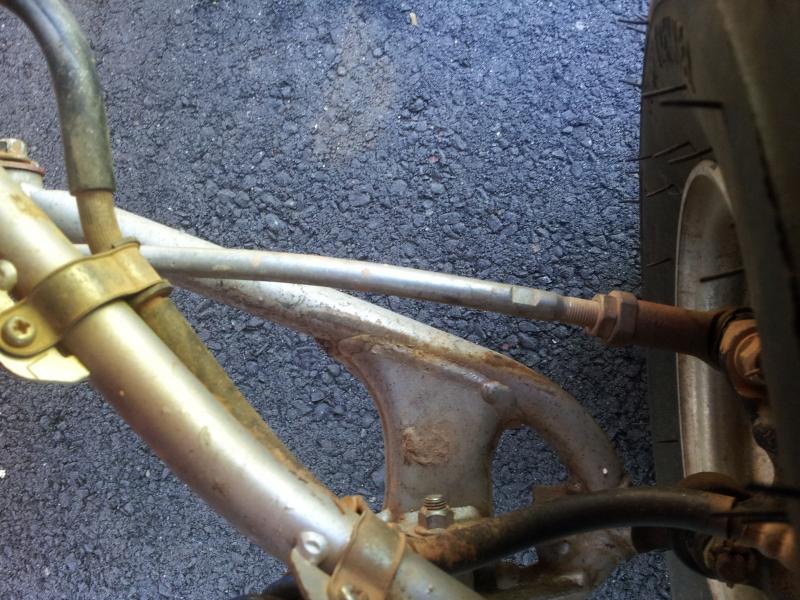

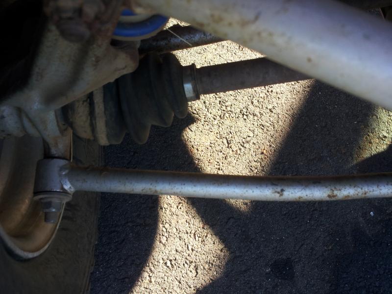

Here is some of the front suspension.

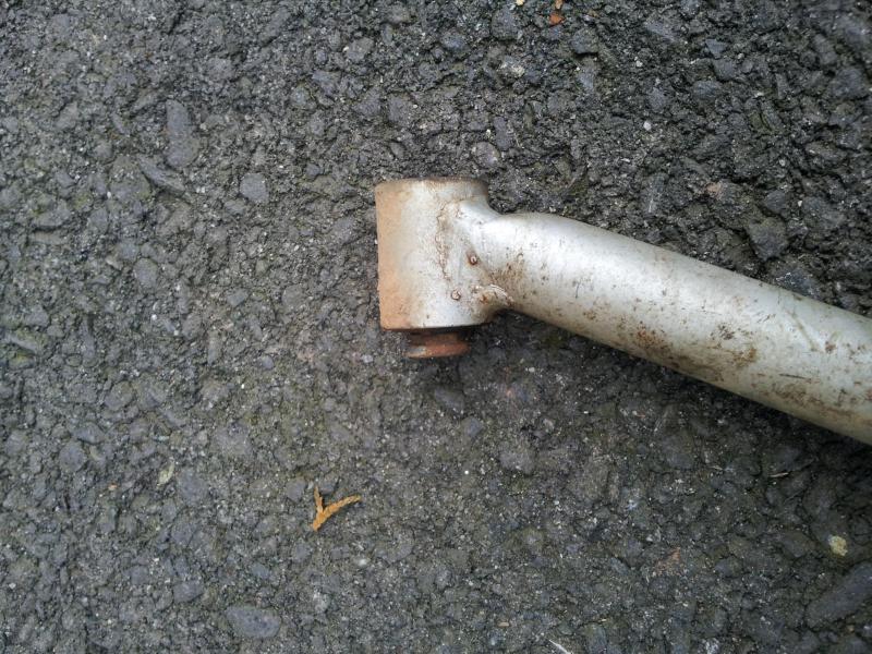

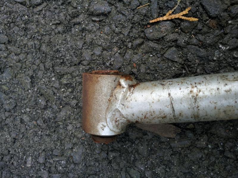

Some of the rear suspension arms:

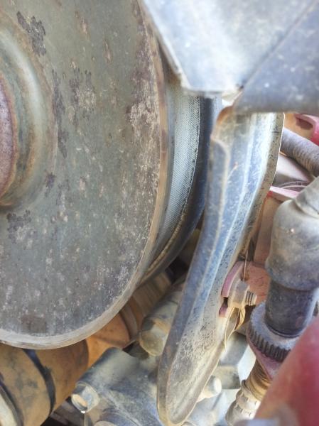

PostPosted: Sun Sep 08, 2013 5:04 pm

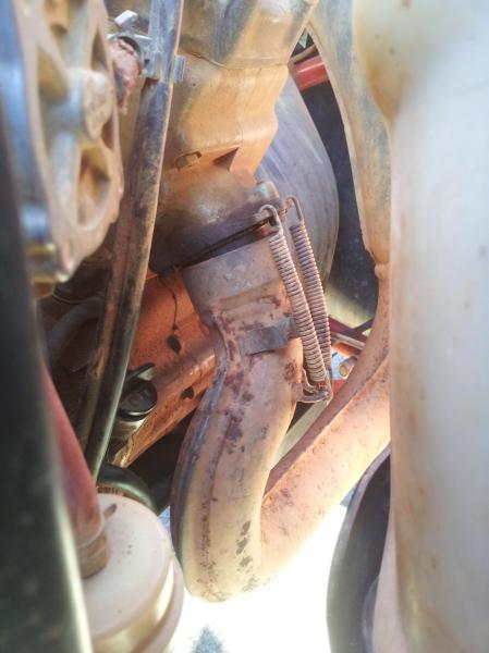

Exhaust pictures:
Belt:

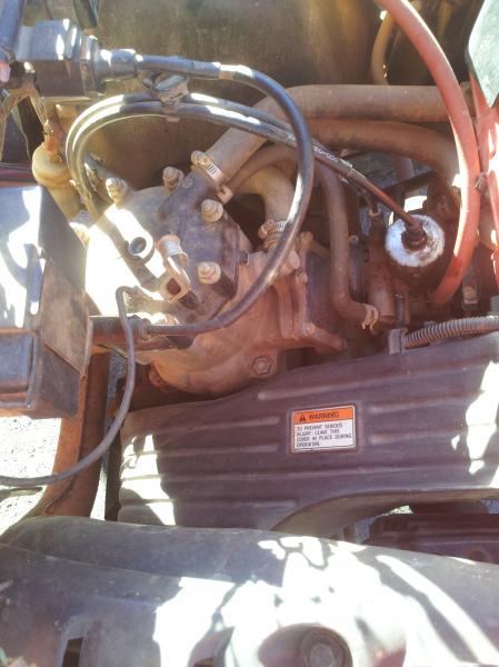

Engine picture:

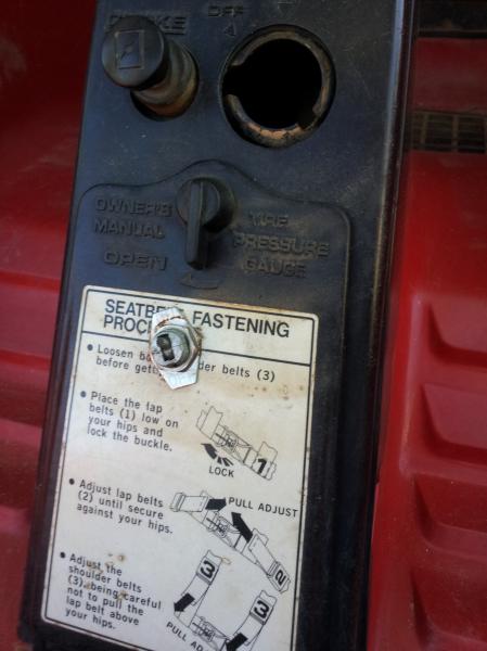

PostPosted: Sun Sep 08, 2013 5:07 pm
Here is the current ignition switch. Throttle provided in the sale a new switch and matching gas cap, big thanks to him!
File comment: Bent upper cage, no biggie to me honestly

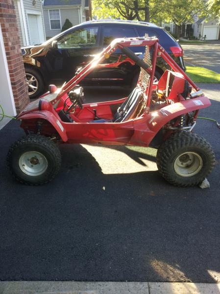

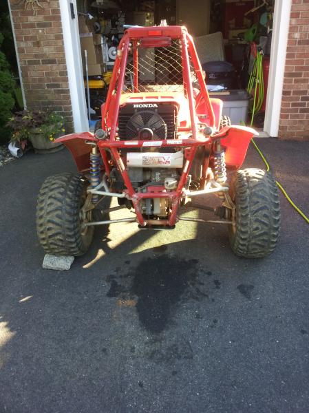

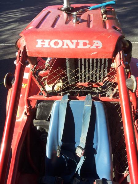

Got into the project this weekend.
Will post some detailed pictures during the week with full write up. In the interim I will post just a few things performed on the project:
Completely removed and replaced all rear upper and lower arms on rear suspension.Everything!
Removed and replaced both rear bearing carriers with new freshly rebuilt ones I had here in my stock.BOTH HAD BRAND NEW BEARINGS,SEALS AND UPPER TIE RODS IN THEM.
Removed and replaced both rear shocks with some fresh OEM rebuilt ones from stock.
Pulled Engine and carb out of the Pilot.

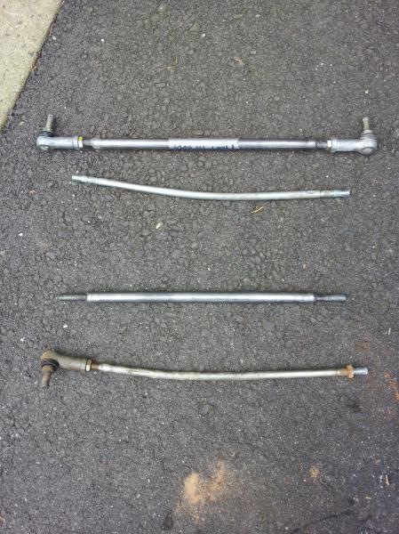

Removed and replaced both front tie rods and tie rod ends. I used Hoserized tie rods with brand new OEM tie rod ends. SET THEM BOTH AT 16.25 LENGTH FROM TIE ROD END TO TIE ROD END and the toe in is at 3/4 of an inch.
Removed and replaced both rear rims and tires. The old Douglass rims had actually been welded in 2 spots and 1 was bent badly.I went with OEM stock rims and Mudlites.
Removed and replaced both lower front a-arms with OEM stock I had. The bushings were wasted badly. I will remove them and install urethane bushing in them at a later date.
Installed the new ignition switch.
Installed new rear fender brackets left side, both were bent badly.
Cleaned and inspected both front brake linings. Adjusted and installed new springs.
Took off the wrong size lug nuts on the Douglass front rims and install new flare nuts 15mm head. I hate when the use the wrong nuts on aluminum rims, drives me nuts!
Steering whell was loose, tightened nut on that.
Installed a used front OEM bumper. Why? I need the Pilot to fit sideways in my new 8 1/2 x 24 trailer and they fit using the stock OEM bumpers. Any protection is better then none. I used 1 as well on Vrooms old Pilot and it fits like a glove in the trailer, saving me space.
Powerwashed the Engine bay, installed new brake pads in the rear caliper.
More to come!

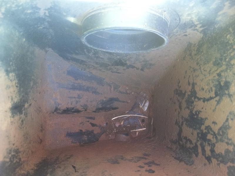

Had some hrs tonight on this project again. First I took the carb and cleaned the exterior as it was covered in mud and grime. After draining the bowl which had nasty rusty dirty water with a touch of fuel in it---- I took the bowl off to see what was left of the internals. Total rust, it was nasty. The carb has more rust in it then a 56 Chevy in a scrap yard. After looking at this I also took the fuel cell out and dropped it off a local radiator shop to have it cleaned. Carb will be replaced with a OEM used 1 I have here.
The rusty water/fuel got me thinking so I took a quick look into the exhaust flange at the piston and cylinder walls, ouch it is not pretty the piston is worn out like a old mattress rust on the cyliner walls, I al amazed it even ran at some point, the rusty water/fuel has wrecked this Engine, it is scrap, will hopefully be able to rebuild.

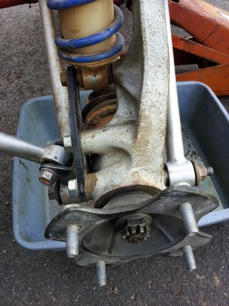

PostPosted: Wed Oct 16, 2013 5:41 pm

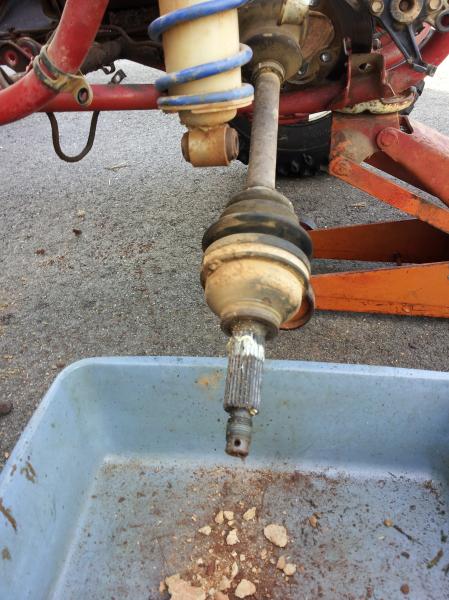

Here we go with the details. Here is a picture of the rear suspension arms I removed off the right side of the suspension.
After seeing that I new I had to remove and replace the rear wheel bearings, there is now way they could be good after being driven with a bent suspension system.Here is a picture of the bearing carrier removed off the axle:
Axle as it looked when suspension was removed:

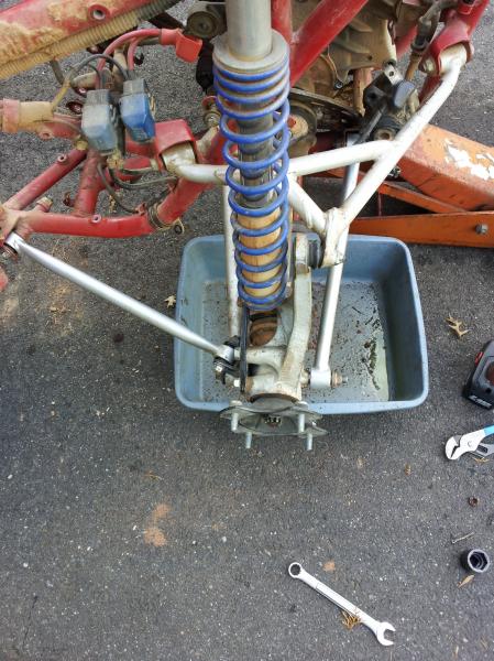

After removal of the rear lower arms, the rear bearing carrier I checked the shocks as well, a closer look revealed they too took a good hit and the hsafts were bent they were replaced with a used OEM set I had here.Here is a shot with the old shock still mounted in the new suspension, you might be able to see that it is bent:
Here is a picture of the used but freshly rebuilt bearing carrier mounted in the left rear. In the right rear I also installed new upper tie rod end in the housing.

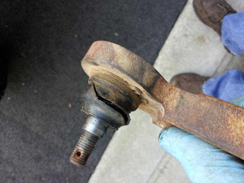

Old tie rod end :
New end installed:

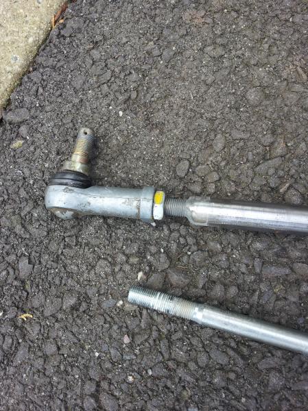

Ok, now to the front suspension. I close CSI revealed numerous issues.
I put the Pilot up on jack stands and proceeded to remove both tie rods with ends. Here is what I removed form both sides, they are bent badly so you know it took some form of hit, just as we saw in the rear you have to replace it all, and hopefully your frame is not bent. In my case some measurements concluded I have a pretty straight frame, the suspension parts took the brunt of the force.Again, it all needs to be replaced if your going to do it right.
Picture of the tie rods New versus old, you can see these tie rods are HOSERIZED:

This is right side, you can see the damage to the inner bushing, it will be put on the shelve like the left side for future CSI-might be able to re use with a urethane bushing kit:

Power washed the Engine bay, cleaned the air box, have been stockpiling parts I took from stock for installation. I have a complete stock exhaust for this project here, I purchased used hadn restraints off Ebay and are still looking for a used set of harnesses.

PostPosted: Tue Oct 29, 2013 6:08 pm
Hoping to send the bent tie rods and rear suspension arms out to Hoser for his patent pending "hoserize" procedure. I will use them for stock for the next project.
I also rebuilt the rear carriers tonight, pictures to come. I measured the old bearings to new, and the seals, they are pretty much the same and the seal on the axle hub is a good one, look to be a top notch replacement for the OEM.
i WILL NOT USE THESE CARRIERS ON THIS PROJECT, i REPLACED THESE with rebuilt carreirs already, they will go back onto the shelf for future use.
