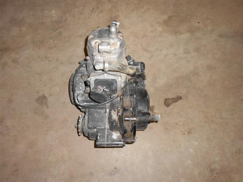

Here is some pics of the Engine Mudbogger sent me from this project http://www.pilotodyssey.com/PO/viewtopic.php?f=34&t=10462
Engine out of the box

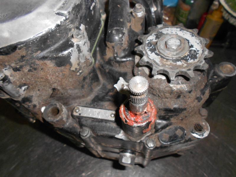

WTF is this red stuff for? Take a look at the bolt/washer used to hold the junk sprocket on.

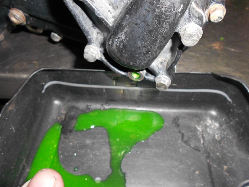

don't know what the manual says I have not read it in years but here is what I do FIRST I remove the water pump drain bolt, I got a little out this one just setting on the bench be ready to catch alot of coolant if still in the frame and the cooling system is hooked up.

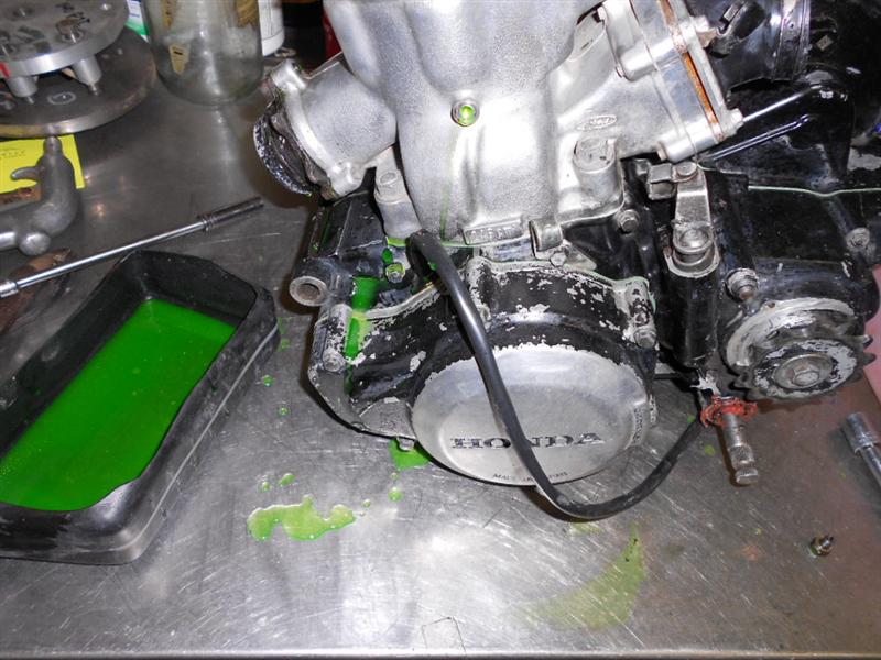

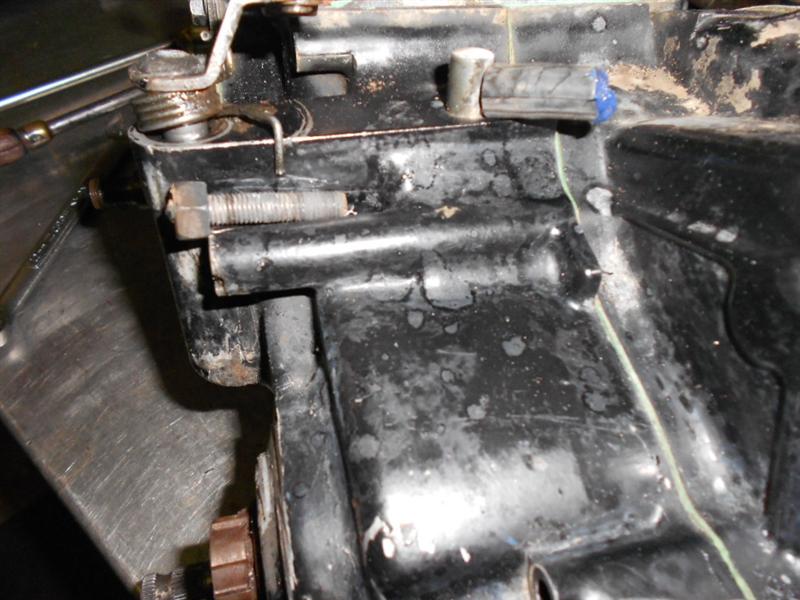

Then I remove the COOLANT SYSTEM DRAIN BOLT IN THE SIDE OF THE CYLINDER.
PostPosted: Sun Jul 22, 2012 3:01 pm
Out pours MORE COOLANT be ready to catch it, with the Engine on the bench now I have coolant not only INSIDE the Engine but OUTSIDE the Engine on my bench and about 1/2 dozen shop towels.

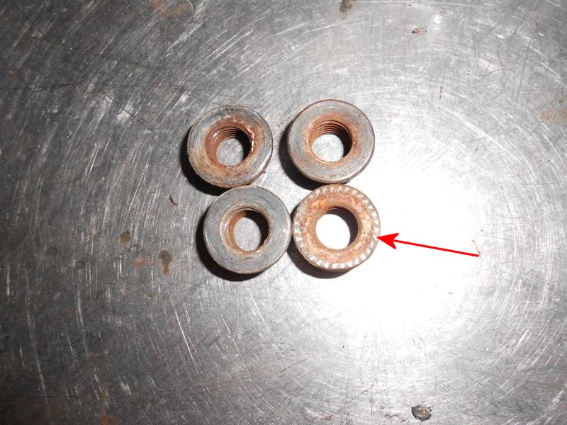

PostPosted: Sun Jul 22, 2012 3:06 pm
After taking a break from cleaning up the coolant mess I pulled the cylinder off, found one of them self locking flange nuts installed the type that digs into the cylinder so you can never maintain proper torque because the cheap ass WRONG nut you used destroyed the surface.
Mudbogger said the former owner said NACS Racing rebuilt this Engine, I am not impressed.
PostPosted: Sun Jul 22, 2012 3:08 pm
While were on the subject of the wrong nuts or bad nuts I would like to point out the 2 wrong nuts that was used on the cylinder head, is this some of the NACS Racing work too?

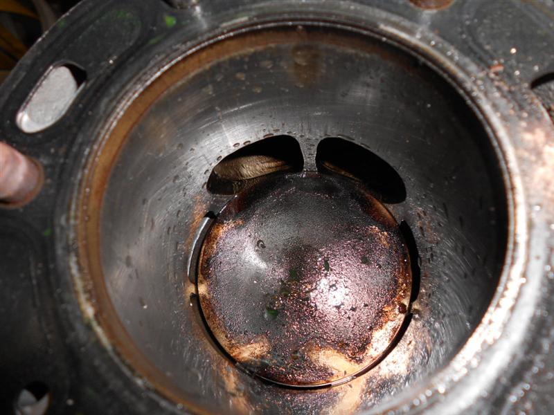

PostPosted: Sun Jul 22, 2012 3:11 pm

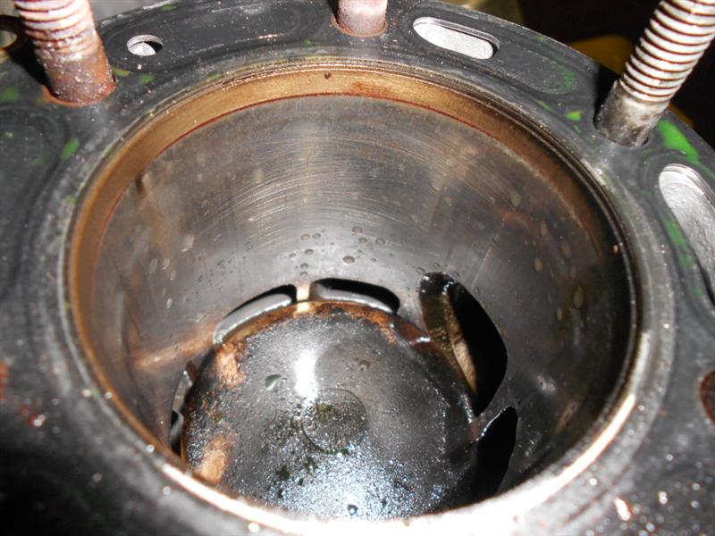

Cylinder removed shows this is a updated port design notice the intake port is more like on a Honda Pilot cylinder yet still retains the bridged exhaust like the FL350 and the older ATC/TRX cylinders.
Note will post more detail pics of the cylinder later.

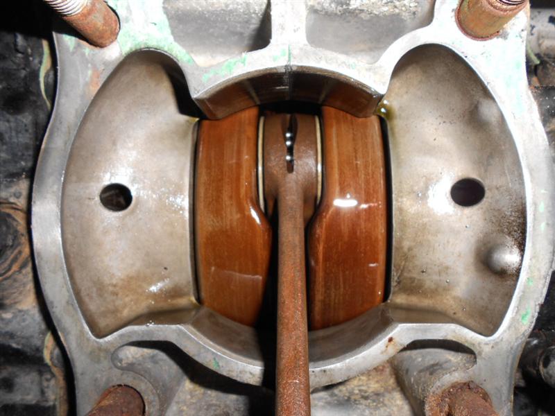

PostPosted: Sun Jul 22, 2012 3:19 pm
Cylinder off looking into the bottom end everything looks normal the big end of the rod is IMO on the lose side if we end up splitting these cases and go into the bottom end I would replace the rod no use spending a gasket set and new crank bearings (required if cases are split) seals and not rebuilding the crank.

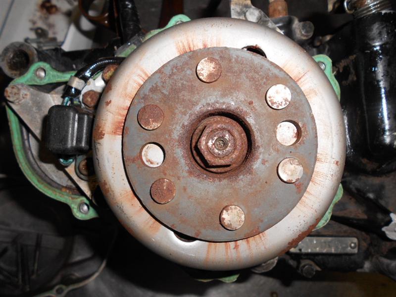

SHAME on who ever the last mechanic to install this flywheel look at the rust.

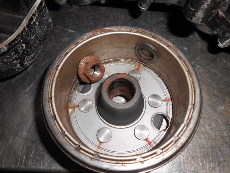

I always brush this area with Engine oil and a acid brush before installing.

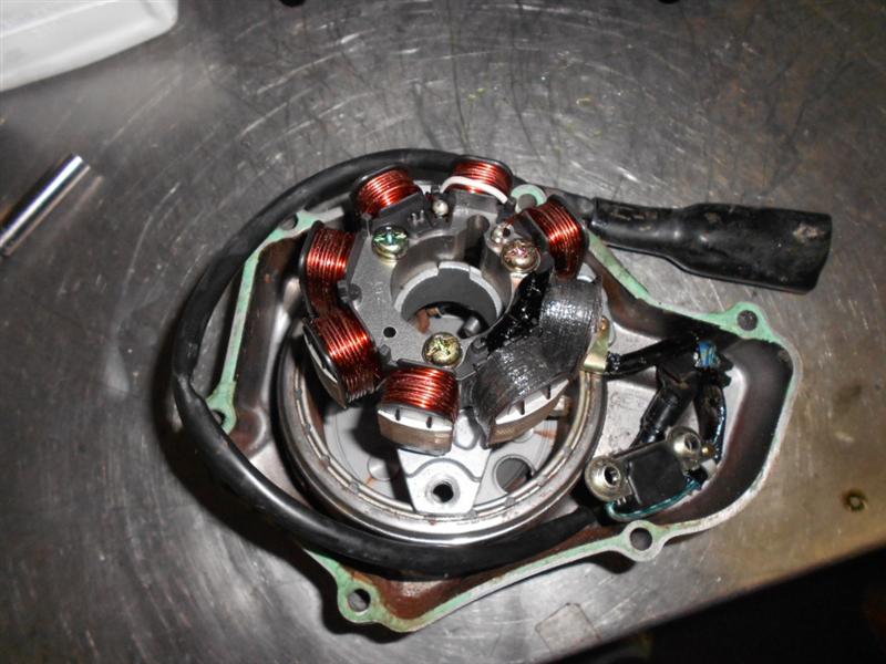

PostPosted: Sun Jul 22, 2012 3:31 pm

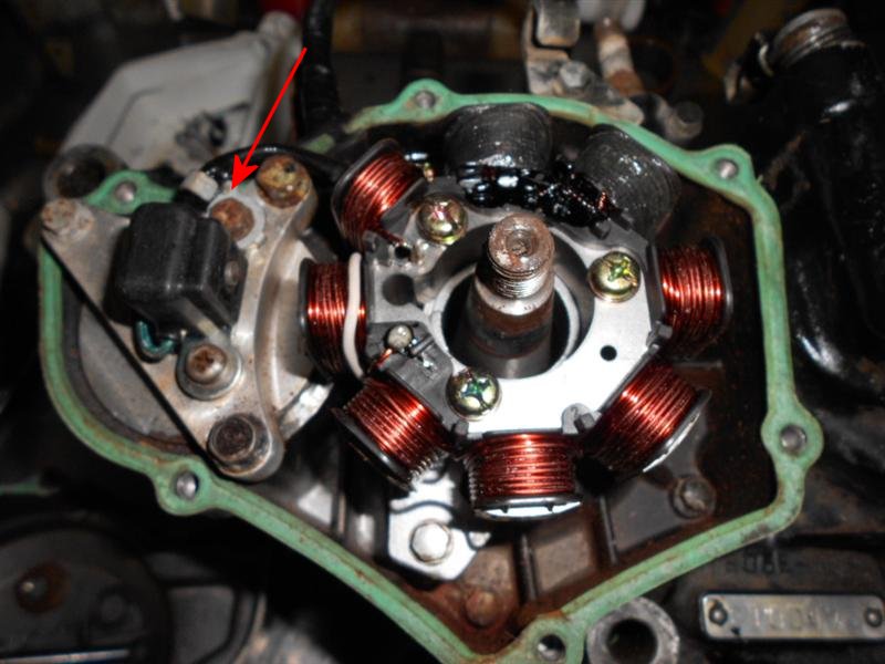

Under the flywheel it looks pretty good other than the last mechanic here must have lost the OEM screws to hold the CDI (Capacitor Discharge Ignition) trigger on so just substituted what ever they had laying around the shop, this more of the quality work of NACS Racing?

Here is the wrong bolt remove from the CDI (Capacitor Discharge Ignition) trigger look at the lock washer they over tighten the bolt so much it destroyed the lock washer, tighter is better? I simply use a drop of loctite on the threads of these bolts.
The correct bolt part number is 93301-05012-0A BOLT, HEX. (5X12) $0.23 each add these to the list might as well get 6 of these.

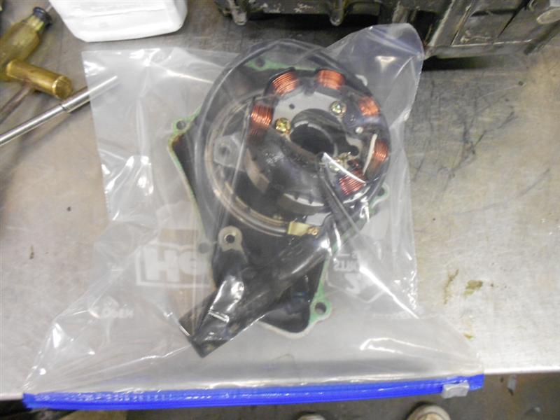

Once I remove all the ignition system I put everything including all the cover bolts into the cover then into a zip loc bag.

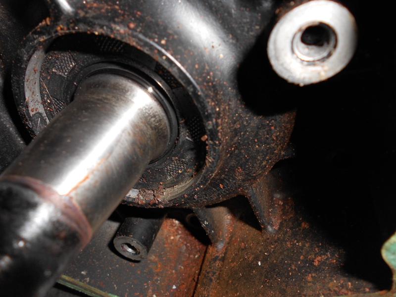

With the ignition system removed this exposes the mag side crank shaft seal, its been a while since I installed one of these seals but do they install this deep into the cases?
I don't see any of the normal signs of the seal leaking.

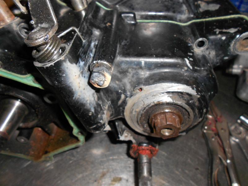

Following the trail of stupid or skillbilly on the outside of the cases I run into this makeshift nut on a stud no idea where this nut came from but its made from aluminum
PostPosted: Sun Jul 22, 2012 3:46 pm

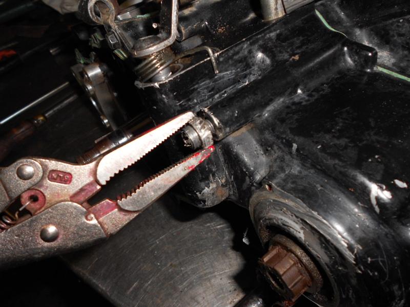

Only tool I have to remove this POS is a visegrips glad it was not tight.

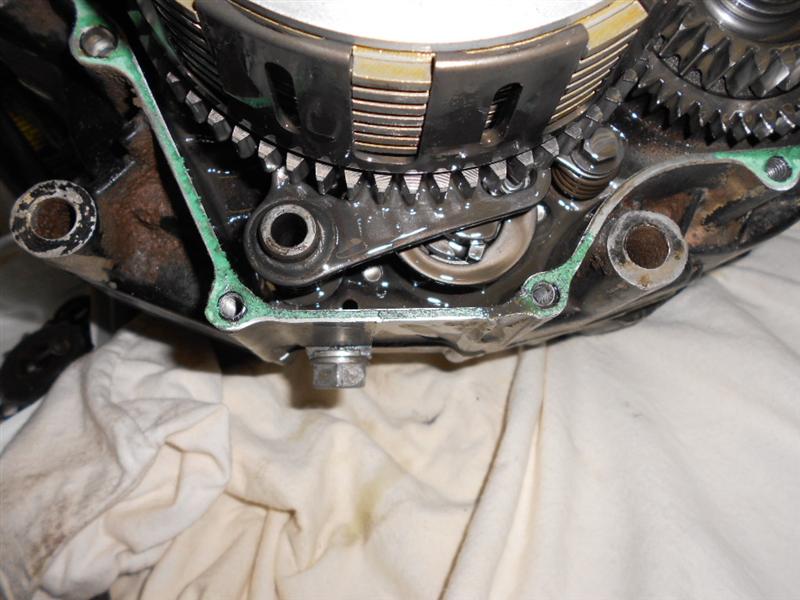

I removed the right side case cover and that is about how far I got I didnt see anything nasty but just gave it a quick look, the clutch basket don't look too worn will know more once the clutch plates are removed might even have a after market clutch basket installed kinda looks billet black not the factory cast.

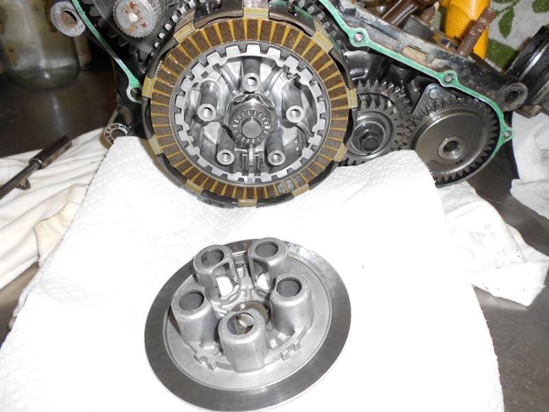

PostPosted: Sun Jul 22, 2012 5:02 pm

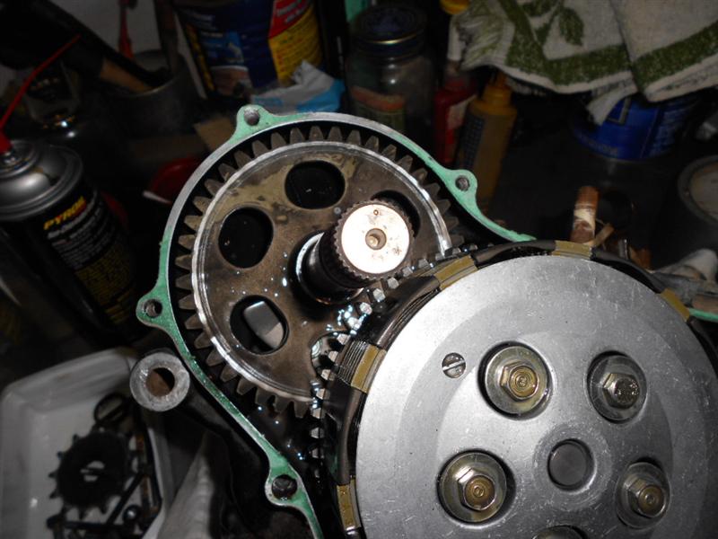

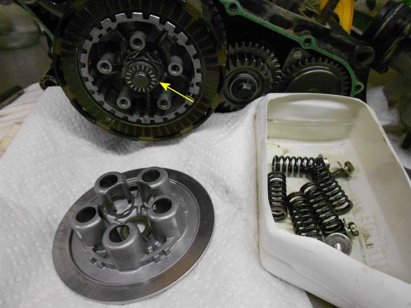

Removed the clutch sub assembly for inspection.
It has the updated shifting mech.
Steel plates look ok

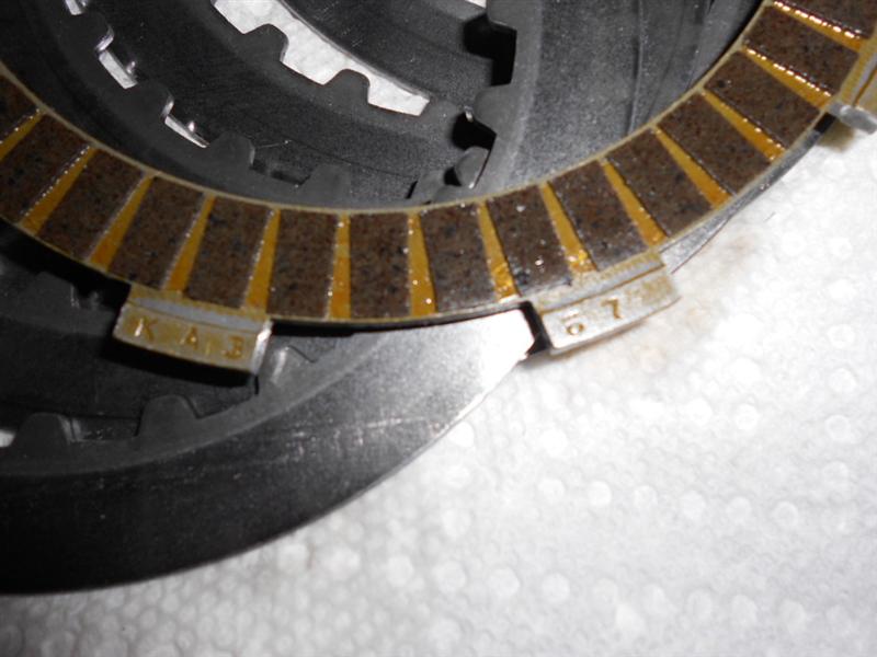

Fibers look ok will measure them later see the KAB 57 part number? KAB is for the TRX ?

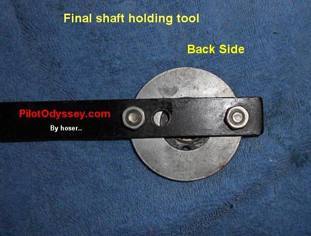

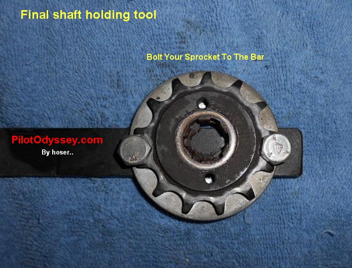

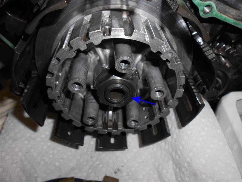

PostPosted: Sun Jul 22, 2012 5:04 pm
Too remove this nut you need a holding tool you put the trans in gear the holding tool on the final shaft where the sprocket goes.
The holding tool
