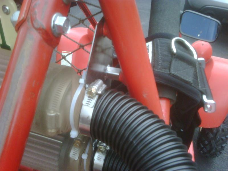

Got into the ride yesterday. Belt is shot, all fluids were changed. As pictured the clamp for the intake is wrong, the 39 mm need rejetting and a good cleaning. Rear clutch will need to be removed and CSI'D as well as the CV'S and the axle stubs too. The trans seals are fine, and I need to do a leak down on the motor (( Internal Combustion Engine ? )) as well. It is a ATV motor (( Internal Combustion Engine ? )) and currently it runs fine, but as we all know they are junk, I might just wait for a spell here as I have another Pilot coming this week that is going to need some attention immediately and I would like to have something running for riding!!

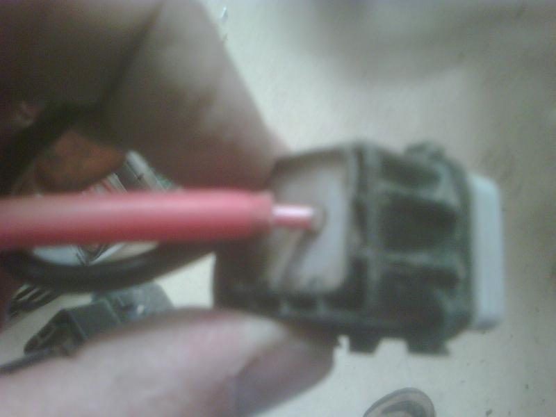

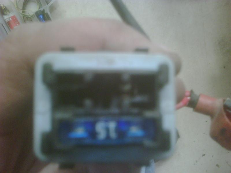

Rebuilt the master tonight for the ride. Simple fix, quite easy IMHO.

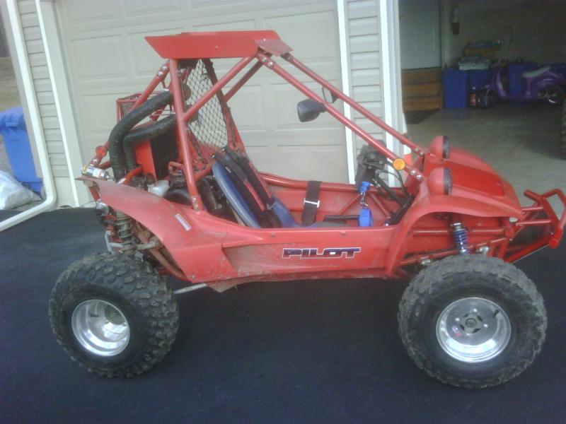

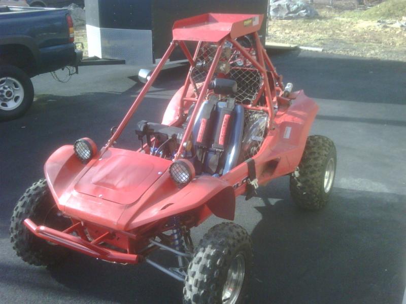

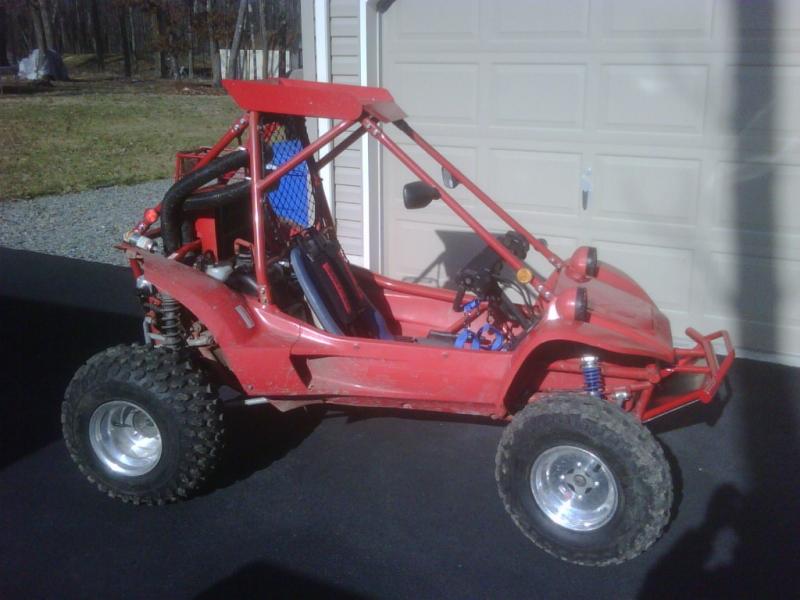

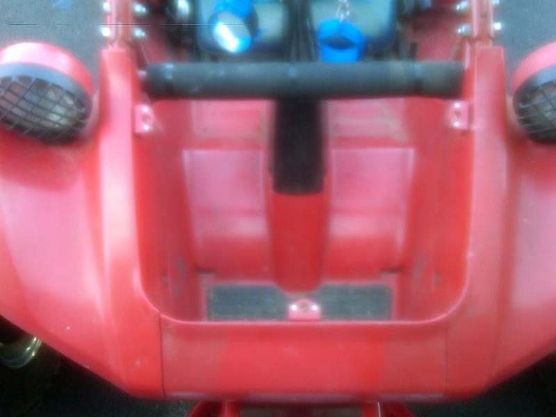

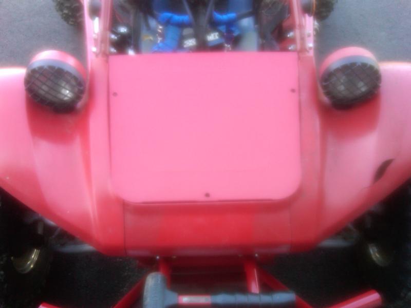

Here are a view pictures of the Pilot currently. I have since replaced the old single intake with a dual intake system,and have rode this for many many trips. A recent trip I had some issues will post more on that.

I also installed used stock headlights as the pilot came with KC offroad lights which sucked.

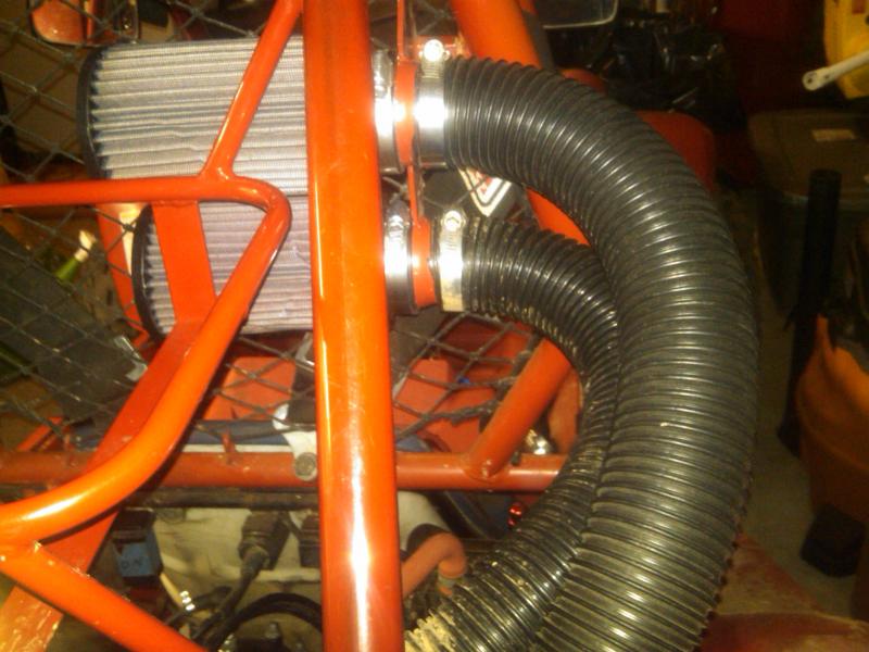

Recent upgrades include new harnesses, new ATVR roof lid, front bumper,and hood. I jetted up to a 186 main as well. I have never touched the motor (( Internal Combustion Engine ? )) as it had great compression and passed a leak down test.

Got to CSI the lack of compression issue. On my last ride I had a breakdown with this Pilot. I had just gotten off a long wide open run with the Pilot and the idle was staying up high-and also it was not pulling well on top end which was never the case. I knew after the long run I was leaning out on top end so I was not anticipating anything I have not dealt with.
As expected I took the top end off today and the rings are melted to the the piston in 3 spots. It is a Wiseco piston 80mm so that is good news indeed! Now this is an Engine I have never worked on, and it is an ATVR built Engine. The head is shaven so thin I'll never use it again-the head gasket is still using 3 layers which I was surprised to see. I will cc it during the week.
The piston had a good burn pattern on it, the exhaust flange will need to be replaced as well as the reeds, just makes sense while I have the thing apart.Pictures to come.

Went and took the carb off tonight. 39MM pwk. First off the slow jet as a 35 way low I run 45's pretty much all the time. Second- main jet was a 175 and it was lean for sure. Needle is aftermarket and I need to get the a Schematic up for them off a website as I am changing it out for sure. Reeds look fine but I'll change them out anyway. As I said I have never checked this Engine at all since day 1 of purchase, so it has been more them enough hrs till it poofkaboomed.
 Post subject: Re: CA Pilot CSI-
PostPosted: Wed Feb 15, 2012 8:04 pm
After some internal/jets/needle conversions and a talk with a tech over at CARBPARTSWAREHOUSE today I just ordered a brand new 39MM PWK carb from them. They installed all on my wanted internals in it and included a jet set for a price that plain beat me rebuilding the older carb. I will use the old carb for parts as all of my rides other then the NY Pilot use the same carb.
Carb should be here in a couple days LA SLEEVE sent over an email my jug was re sleeved to stock bore with piston kit and will be packeaged for delivery to me tomorrow. Was 416 bucks total for that.
