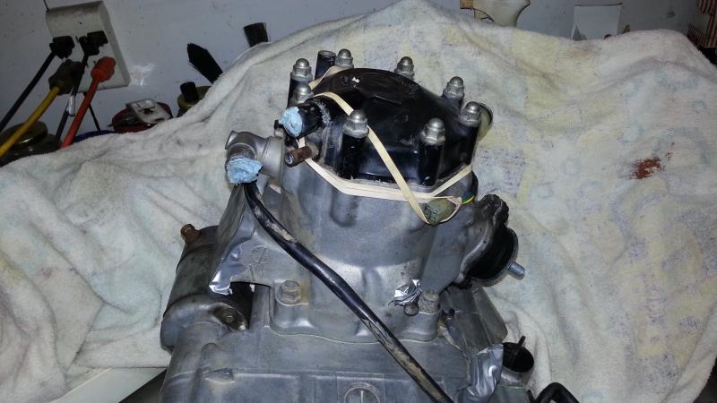

Mudbogger sent me the Engine out of the TurboTexas Pilot he bought the compression was down to like 130 psi ? so he wanted the Engine inspected to see why.
After about an hr in the shop sink with a tooth brush and Dawn dish soap the Engine is clean, it had been leaking spooge out the exhaust badly, the Engine came without the metal ring on the exhaust flange and no signs of silicone sealer on the flange I can see why it was leaking.

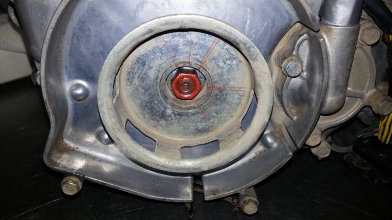

Their is signs that the bottom end has been rebuilt before you can see the newer green gaskets and some gasket sealer on the crank case gaskets.
Their is also some sort of red loc tite stuff on the nut that holds the starter basket on.

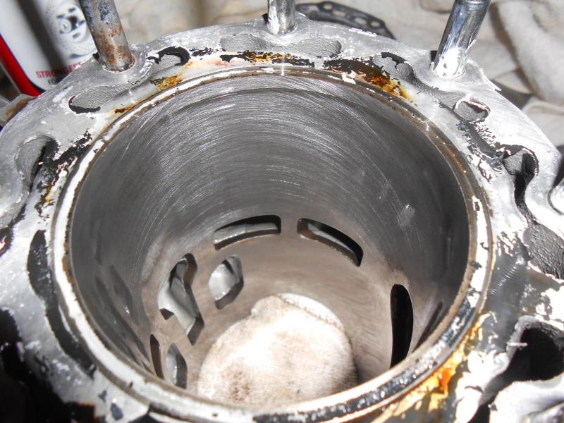

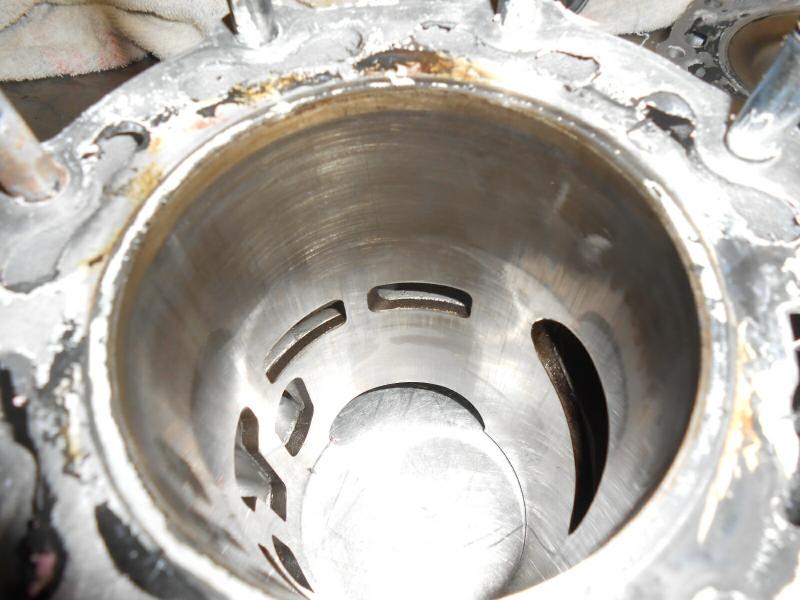

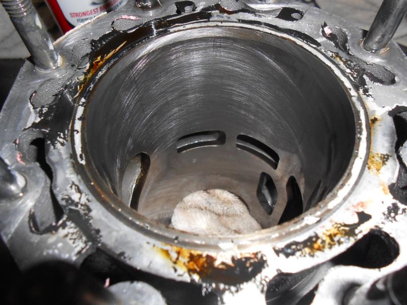

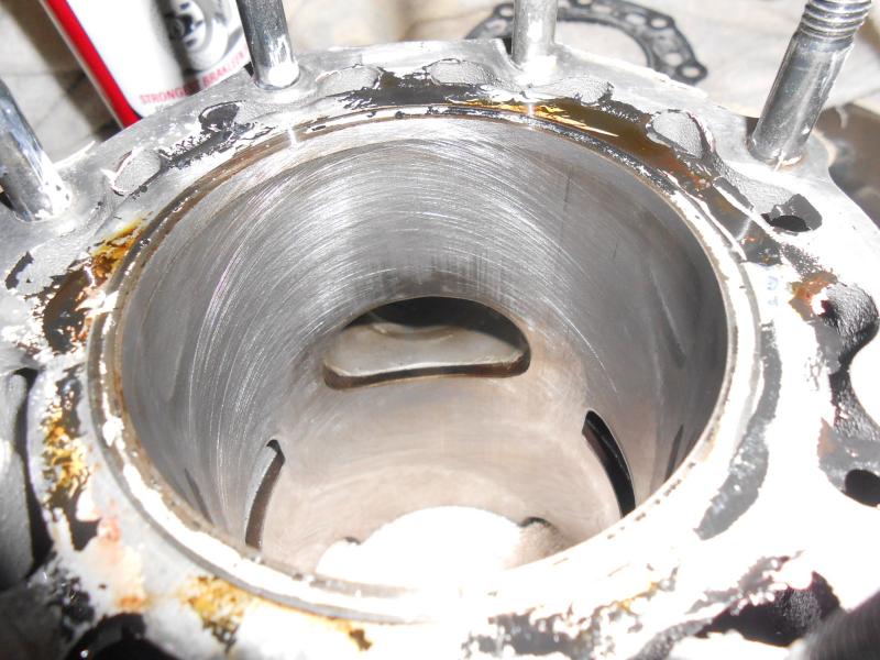

Head off someone used gasket sealer on the head gasket this is normally not required.
You can see the rings never properly seated not sure why the wear is so low in the cylinder need to hone it with my ridged stone hone and see if the cylinder is straight
Its a 1.5mm over Wiseco piston

No clue what kind of oil he use but the residue left behind was kinda brown and looks red in the pics because if the flash almost looks like rust but its not the flash does silly things sometimes.

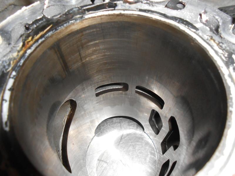

The cylinder bore is not straight I suspect who ever performed the hone on this cylinder at the last rebuild used some sort of spring loaded or flex hone it just followed the crooked bore so the rings were trying to seat on uneven surface take 1/2 season of wear to make them seat if even then, by time they seated all the blow by would corrupt ring grooves.
Here are some pics of a lite hone with the proper ridged hone you can see the uneven areas.
No doubt the shop that did the hone will tell you a flex hone is ok, "never had a problem" "been doing it for years" "never had any complaints before" "those expensive hones are over kill" bla bla bla I mean really you didnt see Turbo tearing down his Engine and running it back to who ever flex honed this cylinder did you, why then would they spend 500 bux on a hone when they can spend 60 bux and pacify Turbo and others whilst putting profits into their pockets.... You would have to drag a cylinder like this one into their shop along with the proper hone and give these morons a demonstration before they would understand and refund your money for the botched job they did.

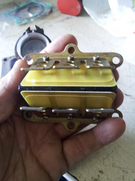

Thank you sir, reeds installed tonight, will let it sit overnight, air leak test it then install in the Vroom pilot, will be riding it tomorrow around the yard hopefully!
BTW VROOM Engine on its way to you, minus reeds, intake and recoil.
PostPosted: Sun Sep 01, 2013 7:15 am
Install complete. Held 6 psi for over an hour before I stopped the test, due to I wanted to put the darn thing in!
Some pictures of the Engine for records-installed fresh Boyesen reeds in the stock cage as well.
