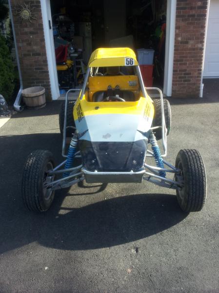

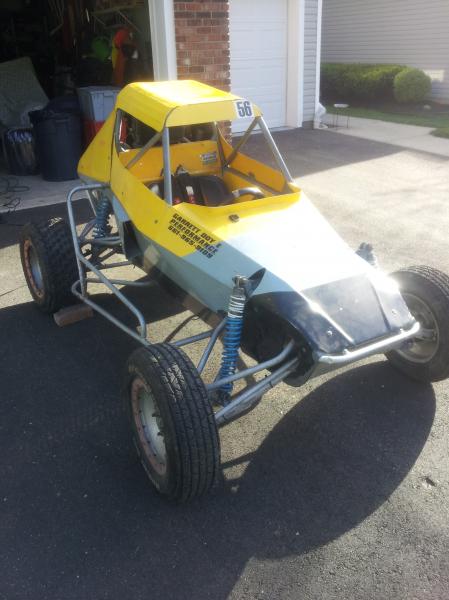

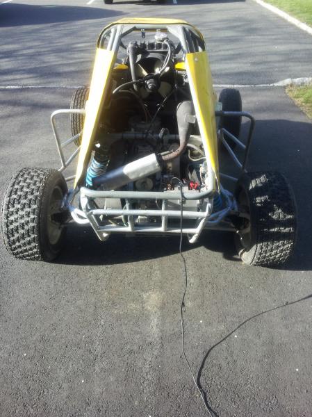

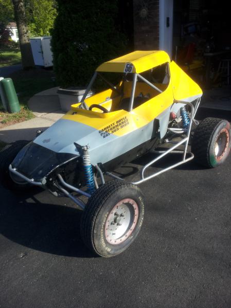

I have had the great pleasure of purchasing my first Triple EEE. The car is in amazing shape from what I have researched on the net/forums.
The car is basically turn key currently. I will do fluids changes and such over the coming weekend. I went over the frame and Engine for several hrs yesterday and found no cracks, broken welds, nothing. I would love any feedback from you guys where these frames and or engines are suspect to cracks, etc. The head has a decal on it, any ideas where that manufacturer is?
Some pictures.

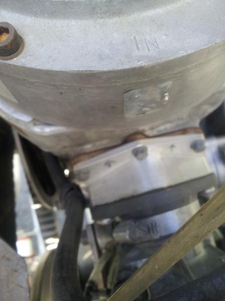

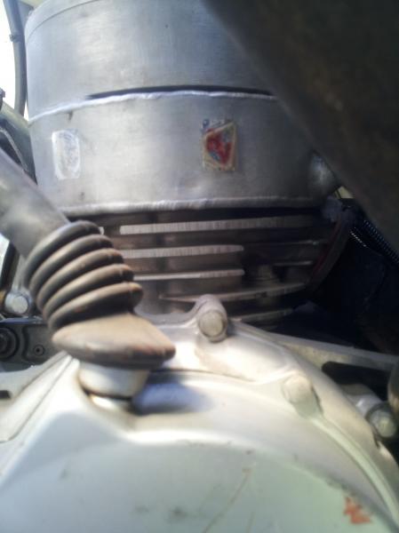

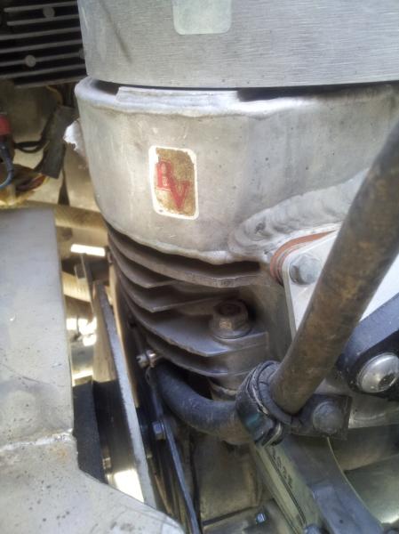

The Engine from what I can find is a typical Gen 3 Engine. If you look closely at this picture there is a decal on the head, any idea on what/who made this head?

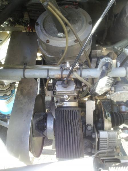

Look at this intake, was this made at Triple EEE?
I think it might be a Mosberger?

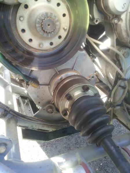

Trans pictures. Is this a Roberto? What trans is stock to these Gen 3?
Vent tube on trans looks flatten ?

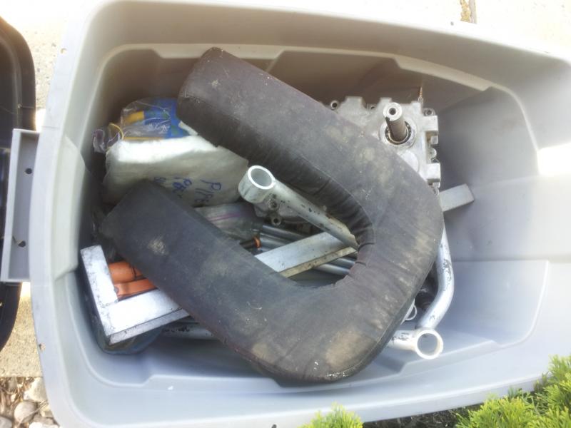

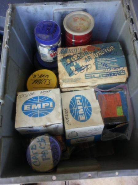

Also included are the original owners race totes. These totes are cataloged for each and every race in a log he kept. There is basically a replacement for everything on the Gen 3 excluding the Engine and frame. It does have spare carbs, reeds, heads, jugs, BUT NO PISTONS for some reason.You name it I got it, even have 4 tubes in case of a tire going down!

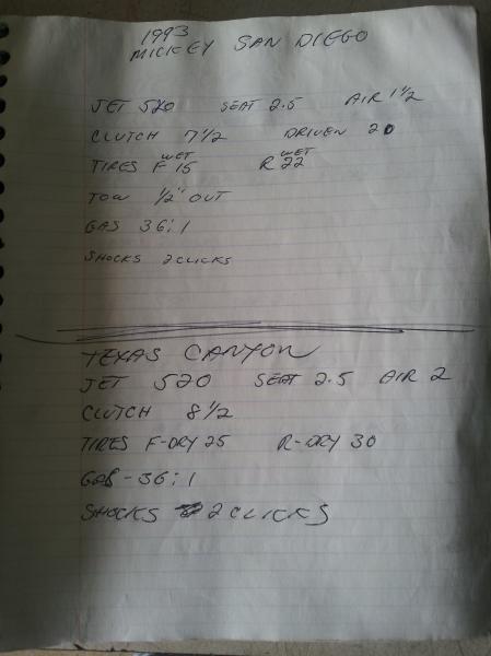

Now something I thought was way way cool. Included with the purchase was a log book. In this log book 1 of the owners cataloged each and every setting he had or made on the Gen 3 for each and every race. Tire pressures, toe in, main jets, clutch pucks, temp, since 1992!! Here are some pictures for you.

Trans is a chenowoth mini mag tranny. Impossible to find parts for. Cylinder is BV Bob Victorino. Engine is mostlikely 350 cc ported good. Reliable but much less hp then the briggs engines. Wheels are champion wheels out of cali. Intake manifold is a mossburger.

Chassis is a gen 3 14 inches of travel and handles the rough stuff very well.

I have seen the aircraft style kill switches but in this model I do not have one. thank you for the information on the trans and other items I appreciate the help. in a case of problems can a roberto be used in place?

Have not raced one yet. I have owed a few eee cars now. Yes a roberto box can be swapped in but one of his current style. Just will need to be lined up and new mounts fabed up. Your car looks good still. I was gonna purchase it a few years ago when it was out here in cali bit I thought the owners price was a bit too high. I do remember him saying he had a spare tranny for it. Did you get it in your deal by chance?
looks like my afterthought motorspurts intake
More to come dinner time!!
the head is an BV racing cast head same as the one i got
