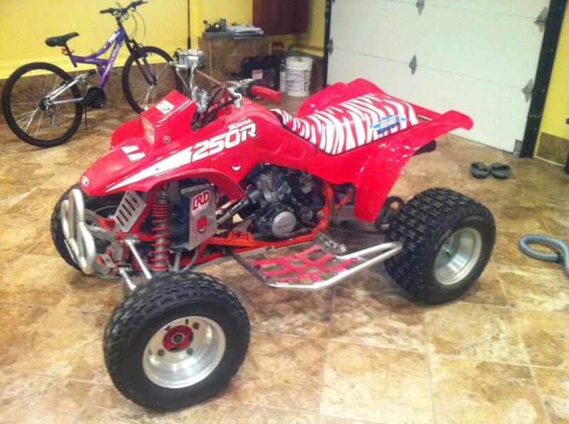

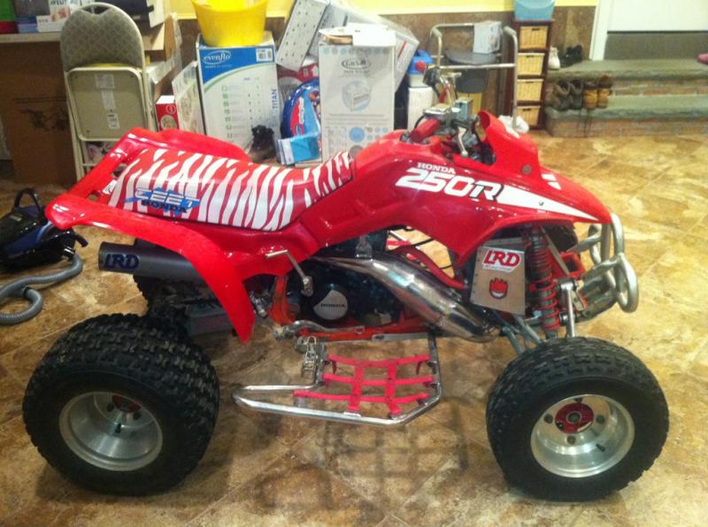

Pictures of the ride, going to get it on Saturday

Please tell me those pics were taken in a kitchen and not a garage!

those pictures are from the seller actual garage. Big Italian family he has. The whole thing is tiled and they use it for parties and such. I had to take a double take when I entered it!

They must have finished the garage instead of the basement?
PostPosted: Wed Jul 04, 2012 7:05 pm
they park the cars in it if you can believe it. I think they used it for a elderly member of the family that has since passed---but I was not going to ask for sure. There were signs of an elderly person/s living there, look at the pictures and you;ll see what I mean. Other then that the dam garage looked like a full fledged kitchen!

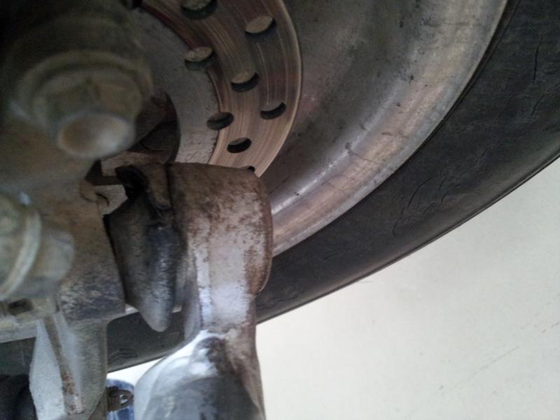

Left front bottom a arm ball joint is gone:

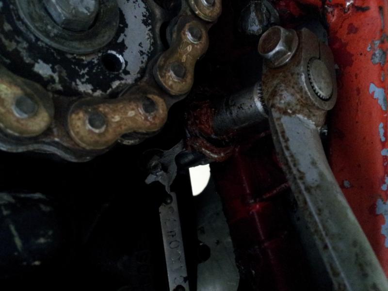

As we all see with the 250r 3 wheeler or 4, side case damage by the chain is as common as apple pie!

Right side top and bottom a arms are bent.
Both sides need seals and wheel bearings they are loose loose loose!!

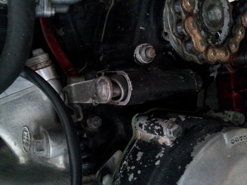

Left side case gear selector shaft seal is leaking, so they RTV'd it to ???

With the RTV seal and some interesting fixes, you will probably find a few stripped case threads and mis-matched bolts. Leak-test that Engine ASAP, or else tear 'er down.
Chain whack is common (thanks to many a slacker owners who don't want to spend $40 on a new chain). Get a nice billet case saver bracket, or machine one yourself.

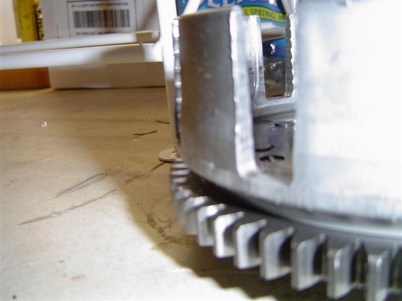

Here is the bad clutch thing Mudbogger found this on his last ATC Engine adventure http://www.pilotodyssey.com/PO/viewtopic.php?f=1&t=5358
PostPosted: Wed Jul 11, 2012 11:03 am
These parts are already here in your sparer parts box.
The gasket kit was sent to me by accident for a Pilot Engine rebuild, the clutch basket was sent for the last ATC Engine build but you sent two baskets think second was for that other "parts Engine" you shipped that came with the 3 wheeler you bought the cases was split because something in the trans broke and ventilated the cases, not much in that Engine useful for parts.
