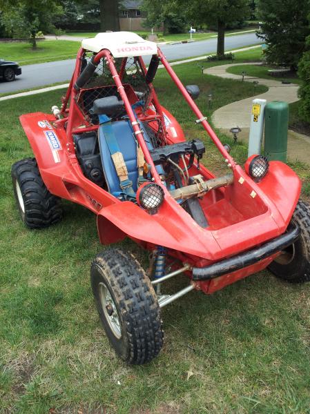

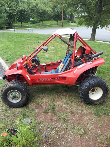

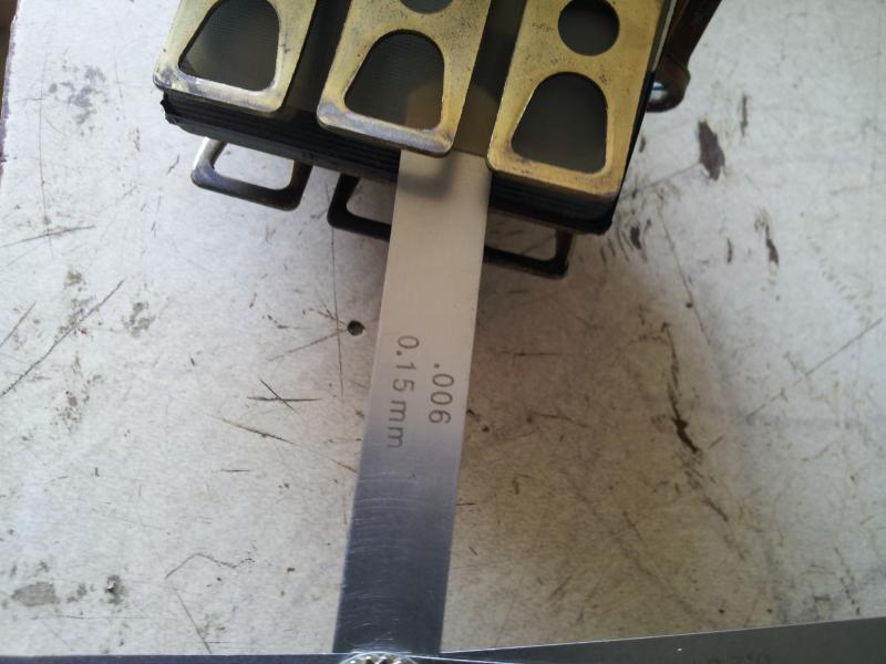

Made another purchase, this time from member Vroom. This pilot interested me as it is basically all stock with the exception of the air filter and harnesses. The Pilot is a great example of a well maintained Pilot with limited mods. The Pilot arrived today at 10:00 am and after a brief discussion with the driver Tom(he has to pick up another pilot I bought yesterday), I set up in the garage for a quick CSI.
First things first, compression check. Stone cold it is 135 psi. After checking with Vroom the jug is on the first overbore with 7-10 hrs of ride time on it. I would imagine that psi is low for a fresh bore so mabye the rings have not seated properly. If I need to install a new set of rings I will, no biggie. Rear suspension power arms on the right side are both bent,and the air filter is totally clogged with dirt. I pulled the slide and it is in remarkable great shape, so the filter did its job. I will replace with a new 1. When purchased this Pilot had a dual air inlet airbox lid, I quickly went back to the stock lid and intake as the carb is totally stock inside and out. The Engine looks like it has been rebuilt as I see RTV on the side case for the pull start and the gaskets look fresh around the reeds as well.
Coolant looks great and fresh, the rear bearing carrier were tight, the exhaust flange where the expansion chamber meets the flange is not leaking at all. Tires on the rear are in great shape, the front rims need some paint but are stock and are staying. The seat has a tear in it, again no biggie, got a replacement here. The frame seems straight, no hits. Front suspension arms and shocks are stock and all bushings, etc are excellent shape. Overall plastics are as to be expected, some cracks, zip tie here and there, all expected and no biggies.
I will look into heat cycling the Engine too see just how much the PSI goes, but I am hesitant to think it is going to get into an acceptable level. I plan to keep this pilot all stock, no mods other then upgrades to existing Engine. I intend on riding this at parks and stuff where the decibel levels are such that the other pilots cannot ride there. Plus I am trying to get my friends wife to ride with us too, this is the perfect ride for her.

got into this project today. First the compression was 135 cold, after warming it up it was checked again, not good, 138 psi. Took thr exhaust off looked up the flange at the piston, it is trashed, no way it can be saved, the top end needs to be removed and checked to see exactly what has happened as the top end is to have 7-10 hrs ride time on it. More to come.
I took the complete rear suspension off the Pilot, and then took the rear shafts out as well. The splines have never been touched and I am sure glad I did it, the trans splines were totally caked with trash, the both cv's had NO I MEAN NO grease in the boots at all, the things were dry. All the rear arms are bent, 1 rear shock shaft is bent (right side), the lugs for the rims are not all OEM, some are aftermarket and will not be used again, I will replace them. Rear caliper is in need of cleaning and fresh pads, the rear dics is worn badly and will be replaced.
The belt is the wrong belt and the wrong width, that is too be replaced as well. The stock clutch need some tlc as well, as does the trans mounts(there toast as well)it is all over the place loose.
More to come going back to it here.
PostPosted: Sat Aug 24, 2013 2:44 pm
Piston is junk, needs a bore, will send the entire Engine to Hoser. Screw it. I'll install the fresh rebuilt NY Pilot Engine in this 1. I will keep the stock carb, clutch, etc in it.

The bore looks to uneven,pictures forthcoming. The piston is a Wiseco 80.5 mm, I took the head off to check it. Got the complete rear end all buttoned up, did the servicing on the cv's and axle stubs today. Completely washed and cleaned the air filter housing and installed new filter with the stock inlet.

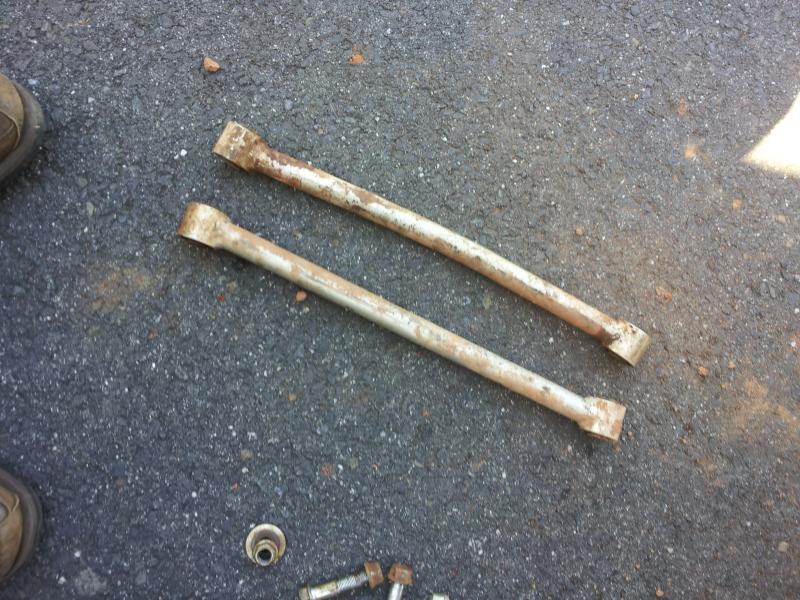

Rear arms after removal. See how badly bent the 1 arm is:

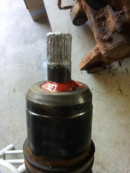

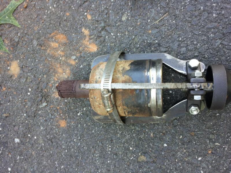

Picture of the cleaned axle stub:
Picture of the stub before installation with the Hoser modification to prevent dirt and debris from getting back in the trans:
Link to that mod from Hoser's tech pages for you:
http://www.pilotodyssey.com/PO/viewtopic.php?t=456
Picture of the completed rear suspension after complete cleaning, installation of rear arms, and axle replacements:
A look at the Hoser axle stub seal mod when properly installed:

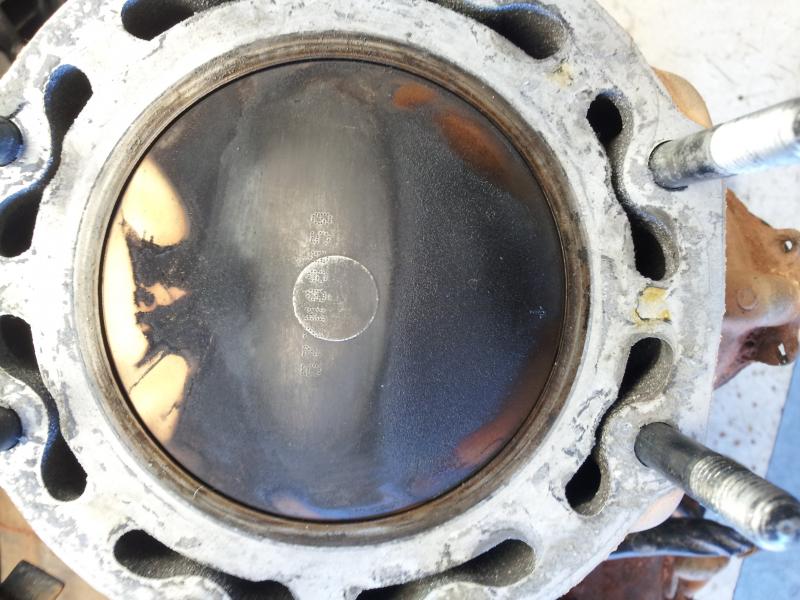

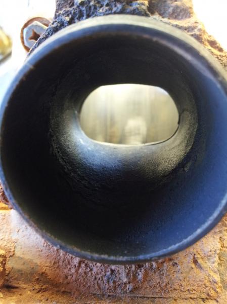

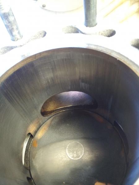

Picture of the piston after head removal. I sprayed carb clean on a toothbrush to clean as little of the top as I could so we can get an idea of the piston wash.
Look at the bore from above and through the exhaust ports:

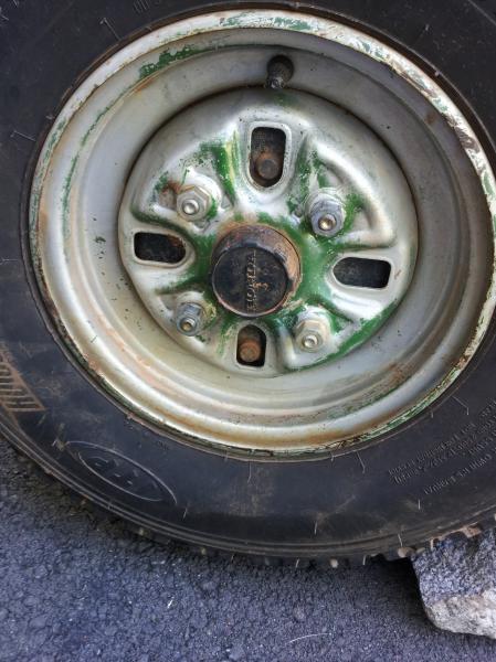

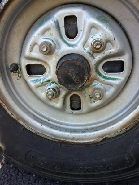

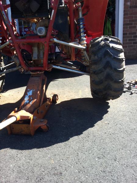

Here is something 1 needs to think about. Say you get a flat tire on a ride, no real tools but what is supplied in the Honda kit. See anything wrong with this picture boys and girls? This stuff drives me nuts!!! Before and after pics:
Before:
After:
Always nice to have 1 size 17mm lugs in case of this!!

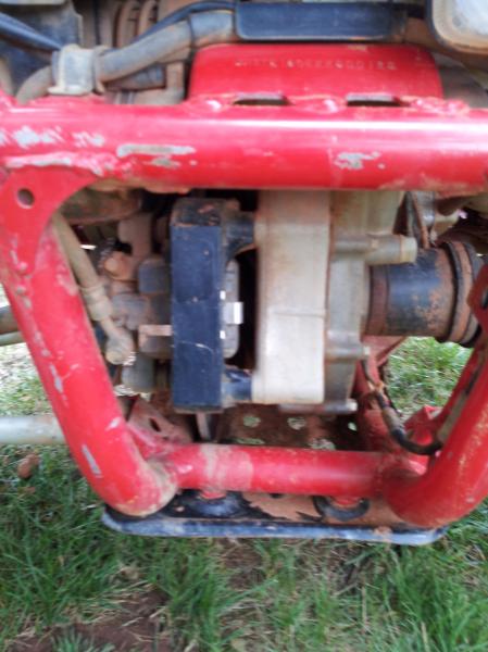

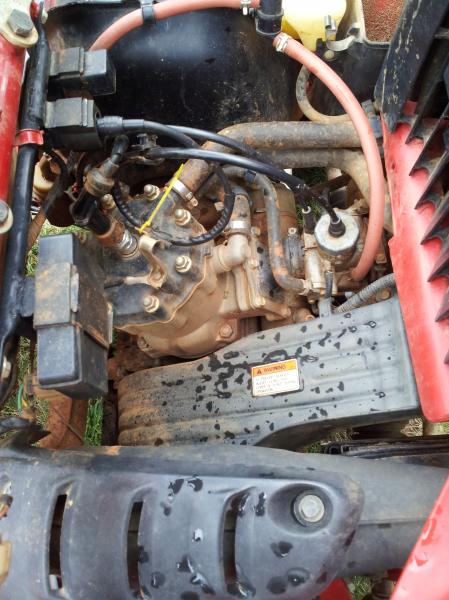

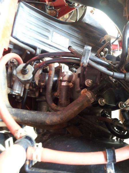

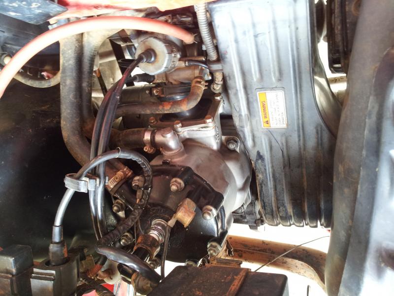

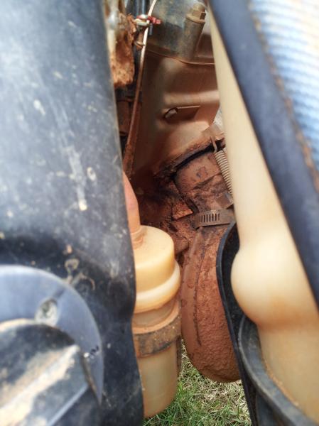

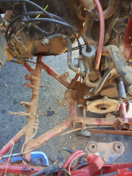

Engine bay before cleaning. It had a ton of red clay/sand everywhere:

scrub the Engine bay down last night..
disassembled and clean the carburetor out. it is all stock internally.
Took several hours yesterday and scrubbed the Engine itself down with pressure washer ans several toothbrushes. It is nice and clean now hoser

Installed the old TurboTexas Engine in the Pilot yesterday:

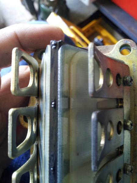

I needed a reed cage and recoil for the new Engine so I pulled them off the old Vroom Engine. When doing this I discovered the reed cage had no-I mean none- adhesive on it, it basicly was just 2 gaskets between the cages:
Probably been sucking air for many rides. I also noticed there appears to be no adhesive on the jug gasket as well, which leads me to believe the top end work performed for Vroom may have contributed to the damage to the piston and rings. The old Engine appears to have a mechanic that believed silicone is the way to seal an Engine too.
The reeds were totally shot-I noticed it immediately after removal from the Engine:
