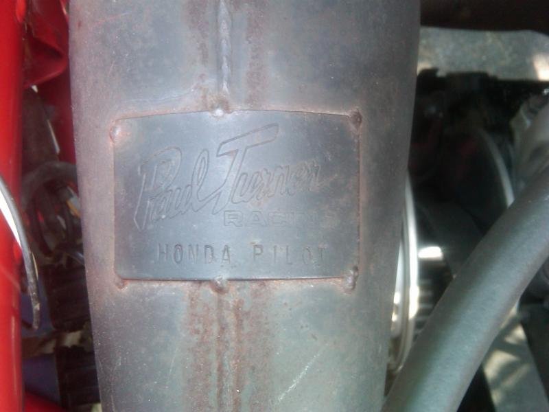

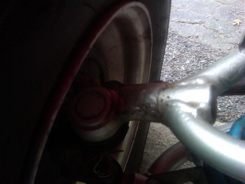

Bought this ride in upstate NY some time ago. I had a thread on the old board but decided to start it again here. Pilot came with some nice add ons and performance upgrades which included 102C CLUTCH,Paul Turner full exhaust, WORKS shocks all the way around,relocated radiator, no rev CDI (Capacitor Discharge Ignition),upgraded 190 rims and tires. When purchased it was noticed the fan is wired on all the time off the key,the spark plug was loose and leaking goo all over the place, wire harness has a section of burnt wires,fan has been relocated with improper wires,carb is not level and need cleaning,cv need to be replaced and axles pulled,front steering has bent rods and loose tie rod ends,and much more.Here is a few quickly snapped photos.

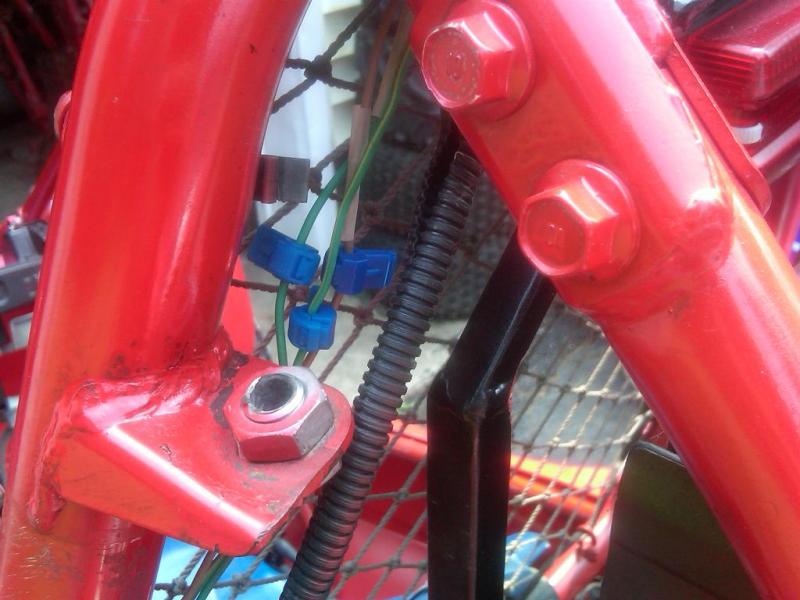

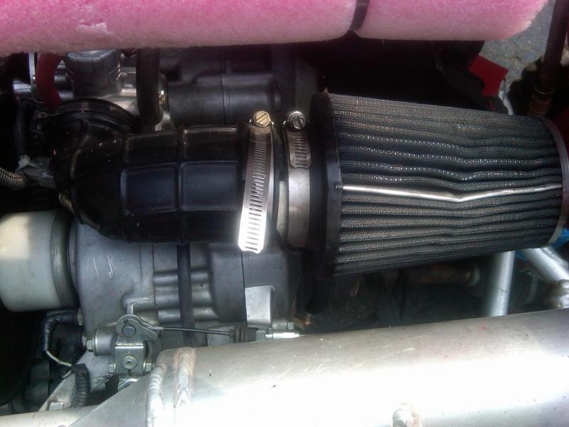

PostPosted: Sat Jan 14, 2012 10:02 am
Some items noticed as well. Head nuts wrong,ground wire is a joke. Missing many nuts and bolts.Air box is gone replaced with a stupid K@N filter kit set-up which I am sure sucked dirt into the carb min. Notice the jug studs on the rear? seem long do they not? Missing/wrong reed cage bolts as well. Wrong hose clamps,carb is off level-many little things on this ride.CV'S ARE TOASTED both sides and the axles need to be pulled and CLEANED/LUBED.Engine has compression cold of 152 psi. See the wire cut off the key so the fan is hot?

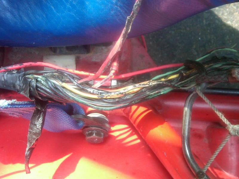

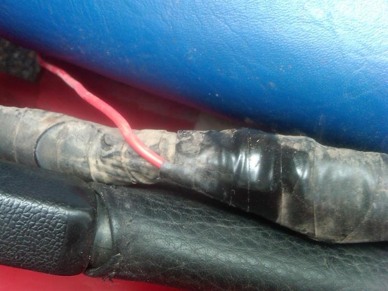

PostPosted: Sat Jan 14, 2012 10:06 am

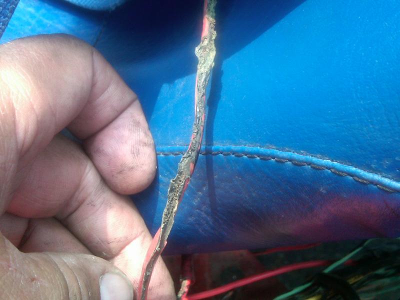

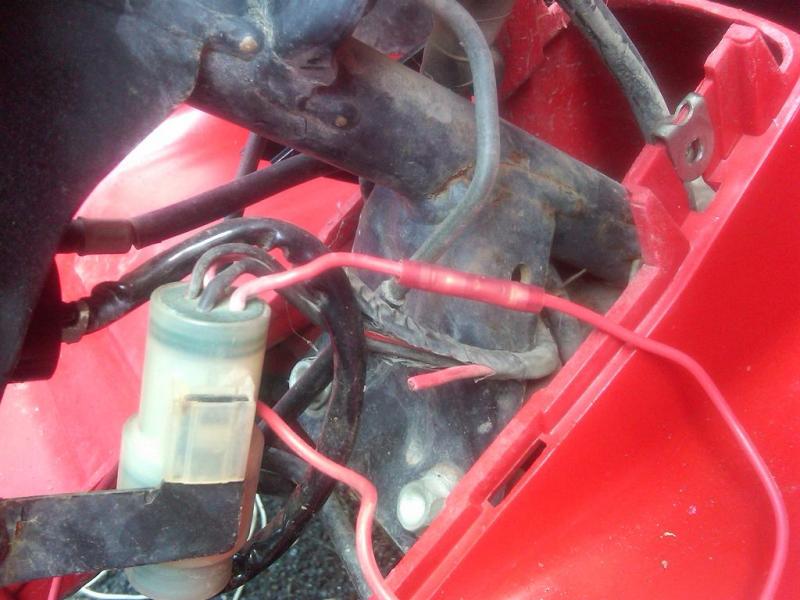

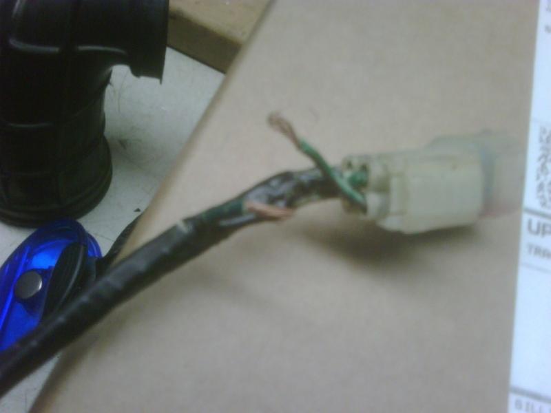

More items. Wire harness is cut in many places, wires badly burnt near the seat, wonder why the fan was not working??????? LMAO!! i FOUND THAT NIGHTMARE in 10 minutes. I hate over spray on the frame and for some reason somebody did it all over this ride.
A little history on the ride. Old owner bought it with the mods to the rad(relocated homemade),clutch(104c),Pipe(Paul Turner),carb(39mm Keihin),reeds and such from dealership in AZ where he used to live. He claims he is original owner but I am doubtful of this. Probably was a rental machine somewhere out there in the desert IMHO. I purchased off Ebay for 4 grand.

File comment: Look what was under that tape
File comment: Main power wire to ignition, no wonder they spliced in at the key!!

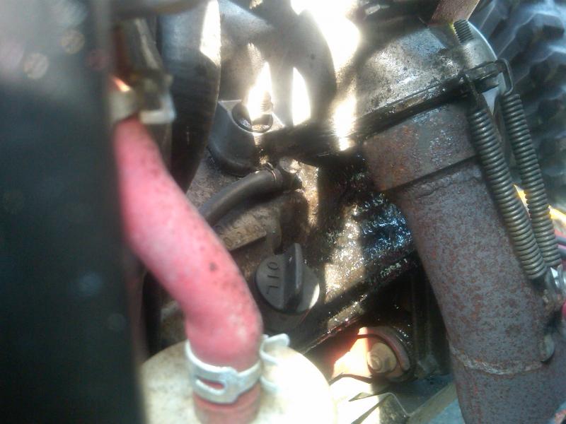

 Post subject: Re: NY Pilot project
PostPosted: Sat Jan 14, 2012 10:09 am
More pictures!

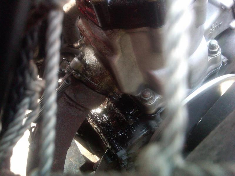

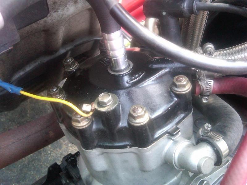

These pictures show you just how much goo was on the jug when purchased. It was running so rich and to top it off the plug was loose in the head. Also notice the wrong bolt on the exhaust flange? As pictured the wires going to the fan stock OEM are all cut, re-routed and have to be totally replaced as per the manual. I have already fixed this to date.But I am a little uneasy on this harness.
File comment: see the goo leaking from top of head?

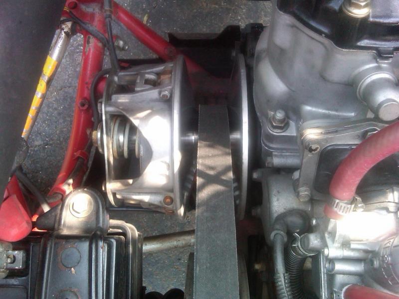

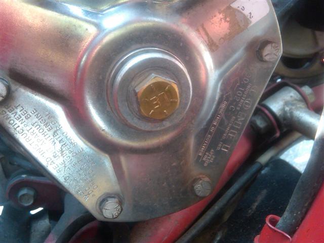

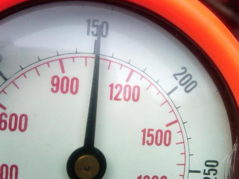

White spring is 4700 rpm just checked.At that rate this has got to have a no-rev CDI (Capacitor Discharge Ignition) or it for sure has no reverse at ALL. My AZ pilot has a powerbloc and at the rate it is set at with 11 pucks that had to have a no rev CDI (Capacitor Discharge Ignition) installed because it hit the rev limiter each and every time I put it in reverse and I am pretty sure the rpm is lower with 11 pucks then 4700. Might need to check into the CDI (Capacitor Discharge Ignition) on the NY Pilot to see if has had the mod done to it. Old owner did not list it in the sale.

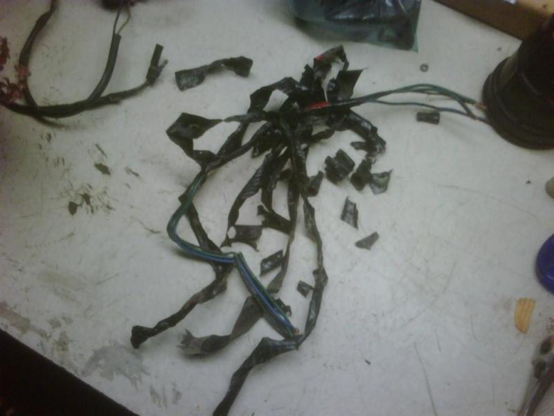

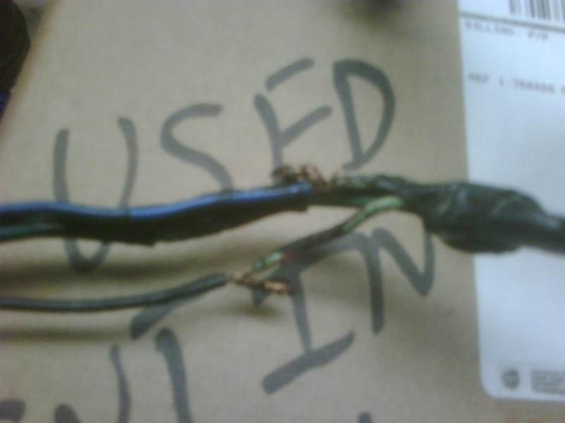

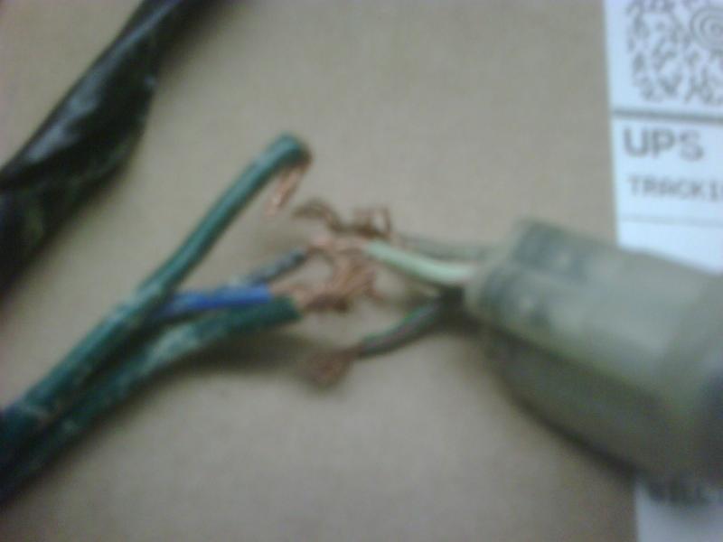

Here is the pile of wires I removed from the harness that had been added. Unreal huh?

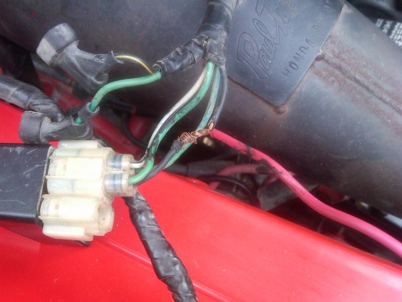

Here is more splicing mutt style in the harness, why do skillbilly do this stuff?????

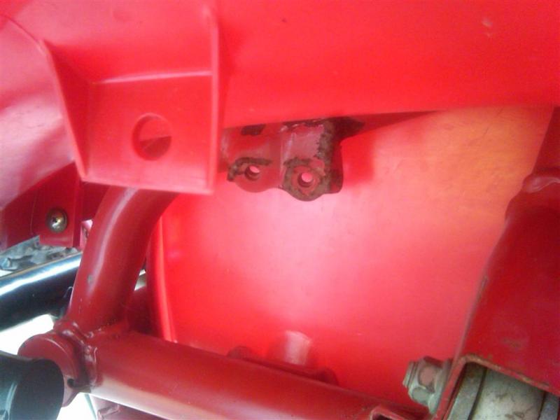

PostPosted: Sat Jan 14, 2012 10:20 am
Missing mounts for the fenders both sides front and rear as well. Ordered a set from Nick Pena with some other parts needed.

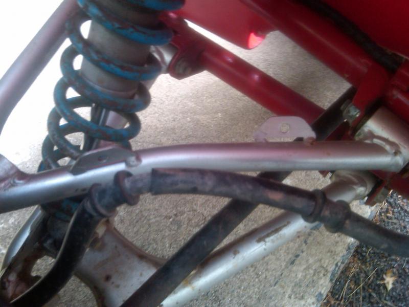

PostPosted: Sat Jan 14, 2012 10:23 am
Not good as well, missing brake line fasteners.

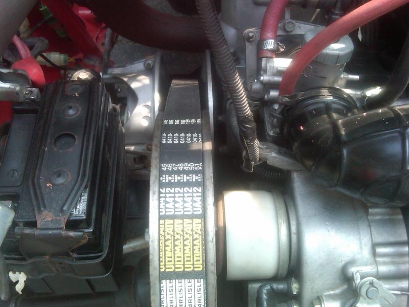

PostPosted: Sat Jan 14, 2012 10:26 am

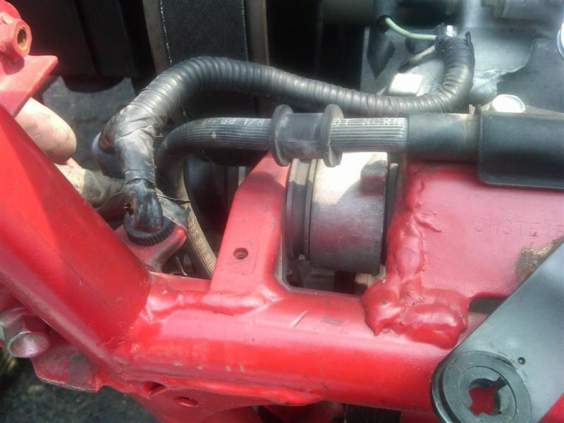

Notice anything here in this picture?
Look at the starter wire routing-see where it has hit the clutch and now has electrical tape wrapped around it? See the wire tie holding it to the belt guard bracket? Also see the carb is not level as well. This cable will be replaced and routed properly with a belt guard installed as well.

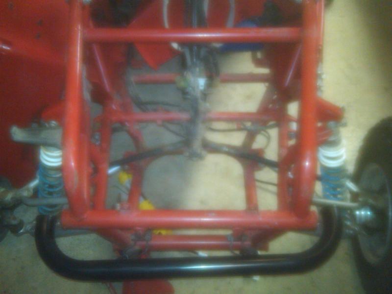

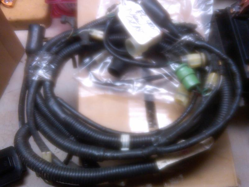

Got the project in the garage today. First thing first: wire harness. After really taking a good hard look at it I determined it was just too cut up to use. I took all the front plastics off the Pilot, ripped the old harness out and installed a brand new OEM harness I had here from Randy @ odysseysalvage.com. Battery is on a slow charge hoping it is good still. I drained the fluids on the Pilot as well.
File comment: plastics out and harness as well.
File comment: NEW OEM harness purchased from odysseysalvage.com

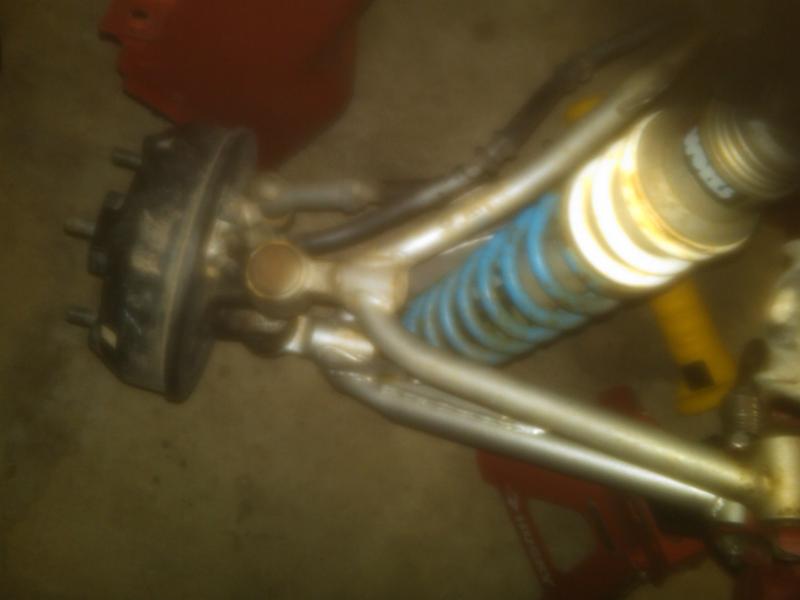

Also today I removed and replaced the right side upper a arm on the ride. The old one had a tie rod welded onto the end of it and the sperical bearings were toasted as well.Picture is with new arm in.

Had to remove and replace the whole rear section of the harness from trans up. This thing was totally hacked into and just ruined. aND AGAIN PURCHASED FROM odysseysalvage.com

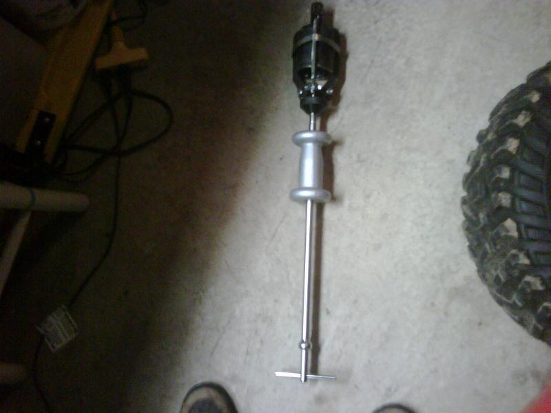

PostPosted: Sat Jan 14, 2012 10:58 am

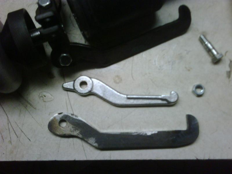

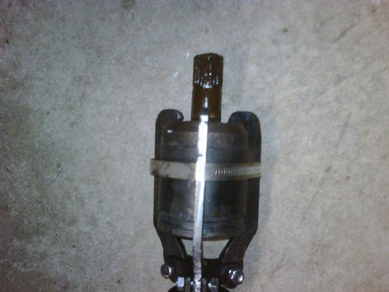

Fabbed some arms for my slide hammer kit to use for pulling these stubs out of the trans. I copied them from the originals in the kit but used a thicker plate steel and elongated them for proper fitment.
File comment: arm provided and my new arm side by side
File comment: I use the hose clamp to hold them tight onto the stub,it is just easier.

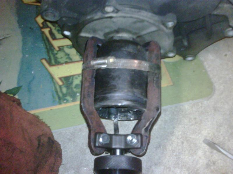

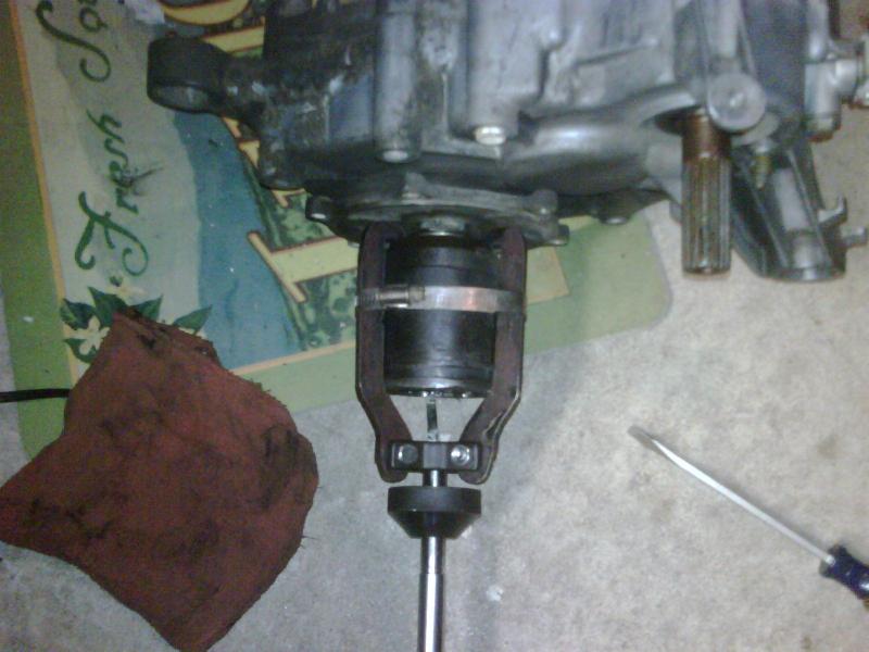

PostPosted: Sat Jan 14, 2012 11:02 am
After many many times pulling these stubs I have finally got it down to a science. I soaked the stubs in PB Blaster for several days prior to trying any type of tool on them. I fitted my new tool onto the stub and attached to my slide hammer kit. Actually took 5 slides and it popped right out. I then used a brass punch and tapped the other axle right out. Worked like a charm.
File comment: look at the tool with attachment
File comment: there is no clearance issues with the hooks on the side of the trans
