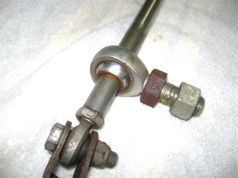

When I went to pick up the 350 from Turbos house we discovered the steering was locked up, now I have it here at my place and apart I can show you what the problem is, its exactly what we told liewire from DAY ONE its exactly what TurboTexas had pointed out shortly after he bought this kit, the stainless steel parts that was included in the kit RUSTED whilst it was setting in storage so the steering is locked up!
Liewire is trying to use a hiem joint for a linear Bearing, show me another application or design that used a hiem joint for a linear Bearing their is none simply because its a BAD IDEA!
Search the web for linear Bearing plenty right ways to do this.
Where are all those liewire lovers today with their garage queens or trailer queens that are never used to tell us how good this kit is? Maybe if they ever used theirs they would then understand the problems with the RUSTING and the galling that happens when you rub metal to metal, the tie rods on this "kit" look like a piston that seized in the cylinder on a Engine haha.
Anyways here are the pictures, TurboTexas and or Mudbogger I need links to the history of this "kit" if you have them please.
Anybody following the saga of this POS suspension kit will remember TurboTexas pointed out that the "stainless" parts LIEwire sent with this POS kit were stainless, see how they have rusted to the point where the steering will NOT work and its locked up tight haha, Here is where TurboTexas points out the LIES http://www.pilotodyssey.com/PO/viewtopic.php?f=42&t=3267
Yeah we told you so Steve Bishop (Professional Liar) AKA livewire better known as LIEwire because of all the LIES he has told and tells.
I am going to take this junk apart put the shafts in my lathe and sand them down so it will slide again then put it back together so the steering will work long enough we can get this 350 to Mudbogger's then he can change the design, this is NOT A FIX or a REPAIR if anybody drives this 350 in this condition and the steering locks up AND IT WILL its your problem!
See all the galling on the shaft from the metal to metal, no matter how often you lube this or what lube you use dirt and sand just gets between the metal and galls the metals.

Oh man, that mis-use of a heim does suck. I also hate that lower shock mount. I've bought some other stuff off them without issue, but this LT kit sucks!!

they make ones with a nylon ball which would cure that. However without knowing the load factors, it might not be reasonable.
PostPosted: Wed Jan 18, 2012 11:53 pm
Even if you were to coat them with somthing or use a set of nylon ones, what happens when a rock hits the bar and bends or or puts a big dent in it like hoser said? Reguardless if it was coated with somthing or a nylon heim it would lock up the steering, no? Or it at least wouldn't let it move passed that point
good point - I suppose then it becomes a trade-off analysis - the probability of occurrence given an individual's particular riding style versus cost.
That is what I was thinking. I have a 3/4" nylon spherical bearing supporting my steering wheel shaft that is holding up very well. There is more load in this application but I still think it would work.
That is very unlikely, almost impossible, as these rods are inside the frame. The tie rod that sticks out of the frame could still bend but in that case your steering will get messed up anyway. As long as the rod can always slide then you don't have to worry about the steering randomly locking up like you do now.
