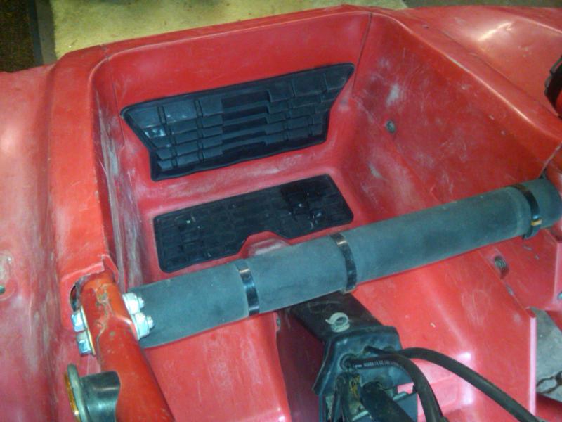

I'll need to replace the 2 front fenders, floor tub,and I need a e-brake arm and hardware as well. New belt also.
Now I have a used rebuilt powerbloc clutch off my CO pilot at Hosers,a new 39mm PWK carb, a new Power pros full exhaust I can install on this 2800 project. I will install my Yoda LT front end kit on my AZ Pilot and leave this front end stock, there really isnt anything major wrong other then a bushing or 2 needed. just have to make the call.I am going to see exactly what top end if needed I put on here as the previous owner has told me it already has a 81.5 Wiseco in it. I got top ends here with bores left on them, mabye I will keep it mostly stock and save the upgrades for my AZ pilot.Just got to think about it. and see what Hoser says!!
File comment: Fenders and front arms replaced, floor tub used also installed

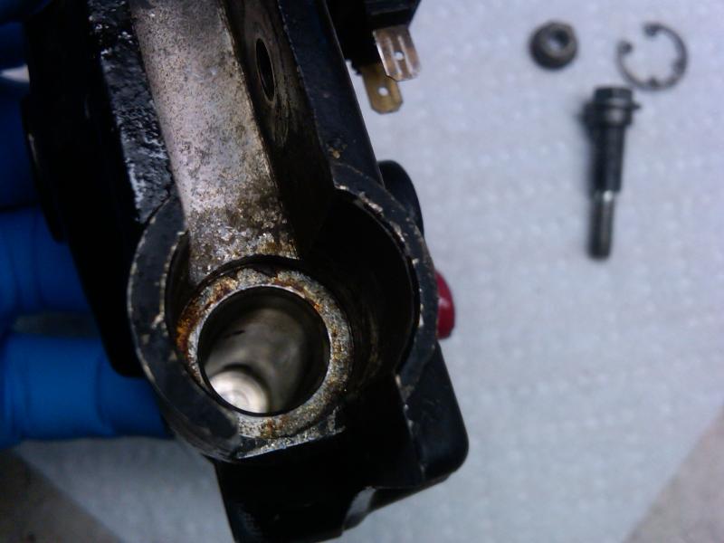

Well after close inspection the front master was leaking fluid so I rebuilt it using an OEM kit I had here.

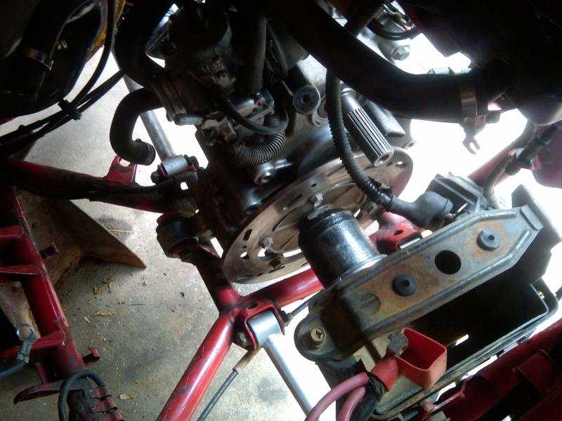

As usual both rear axles needed to be serviced as per Hosers tech pages:
http://pilotodyssey.com/800reasons.htm" .".." ."..

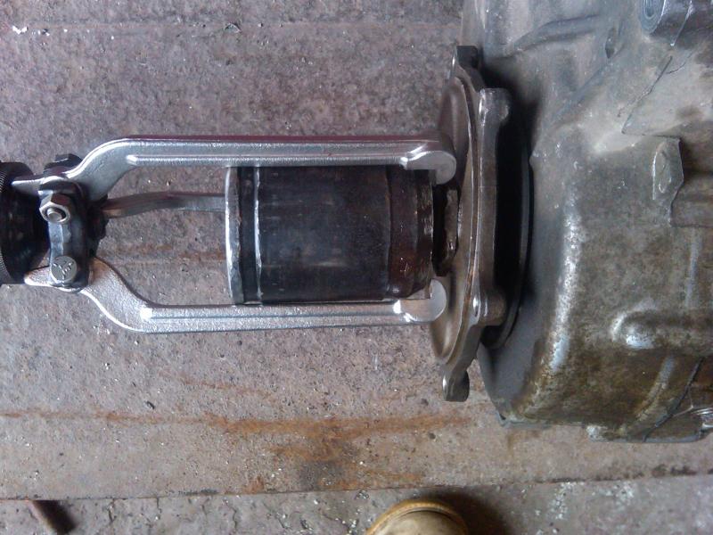

so off we went and boy were these son of bitches stuck good. At that time I had not fabbed a tool for pulling the splines out so I went to my friends shop and used his puller set to remove both side out of the trans:
This tool works perfectly on these stubs-heres another pic:

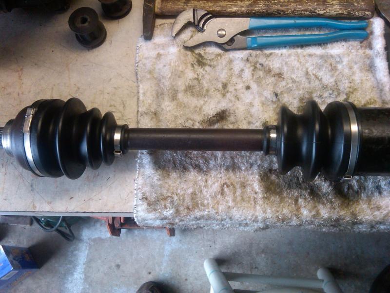

Luckily I had a spare here so I replaced it. I also serviced both cv's and boots on each side, fresh grease as well and new clamps.

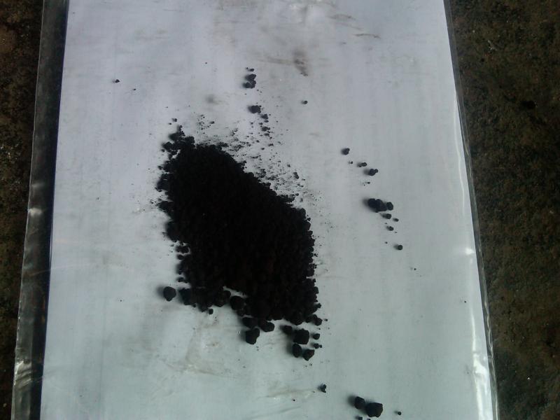

Here is also a great reason to check your splines and axles each year-thisis debris that was laying in the trans shaft between the axles:

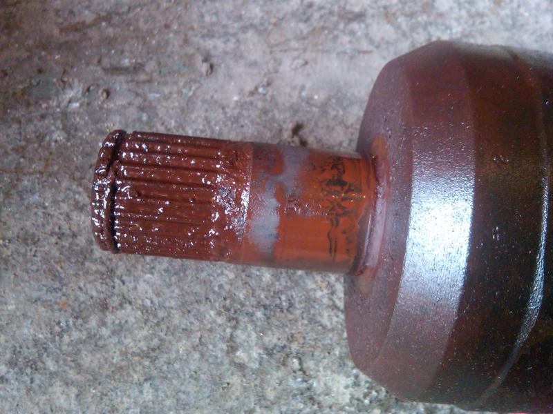

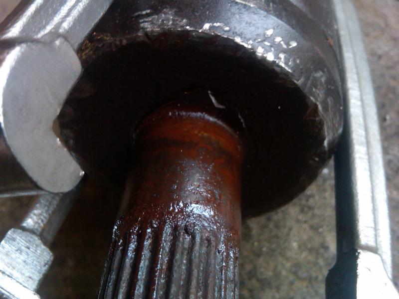

Here is a good shot at the inner cv stub itself-see the wear from poor lubrication? that's from poor grease 100%

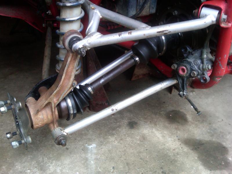

Picture of the completed rear suspension on the Pilot. I also changed every rear arm on both sides as they were bent badly front and rear!!
