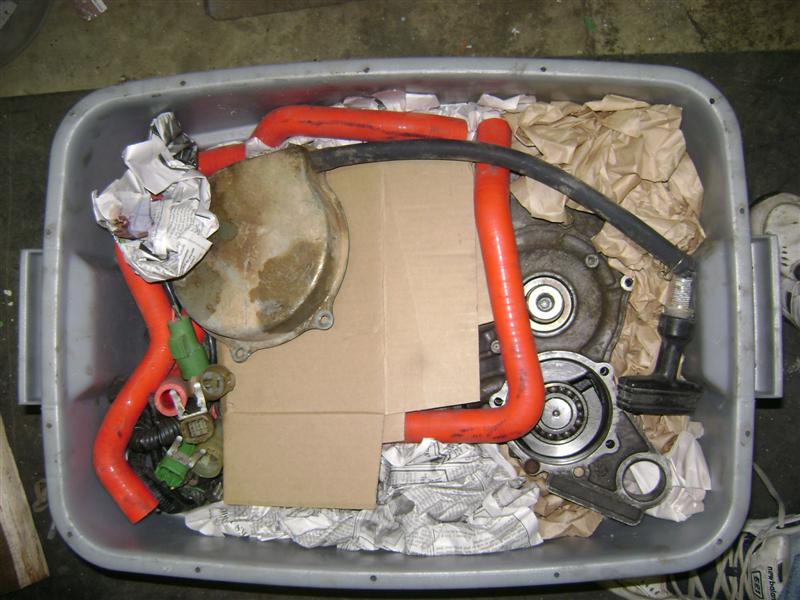

The night before I was to leave for Florida I found two boxes on my door step Mudbogger had bought another basket case Pilot Engine had it shipped to me for CSI, I don't know the details I will let Mudbogger fill you in.
Update he bought this Engine from nitrosport_5 who bought it as a basket case Pilot The rest of the Pilot is here "Alabama Pilot Wreck" viewtopic.php?f=5&t=9241
 Post subject: Re: Pilot Engine CSI -
PostPosted: Fri Feb 17, 2012 11:50 am

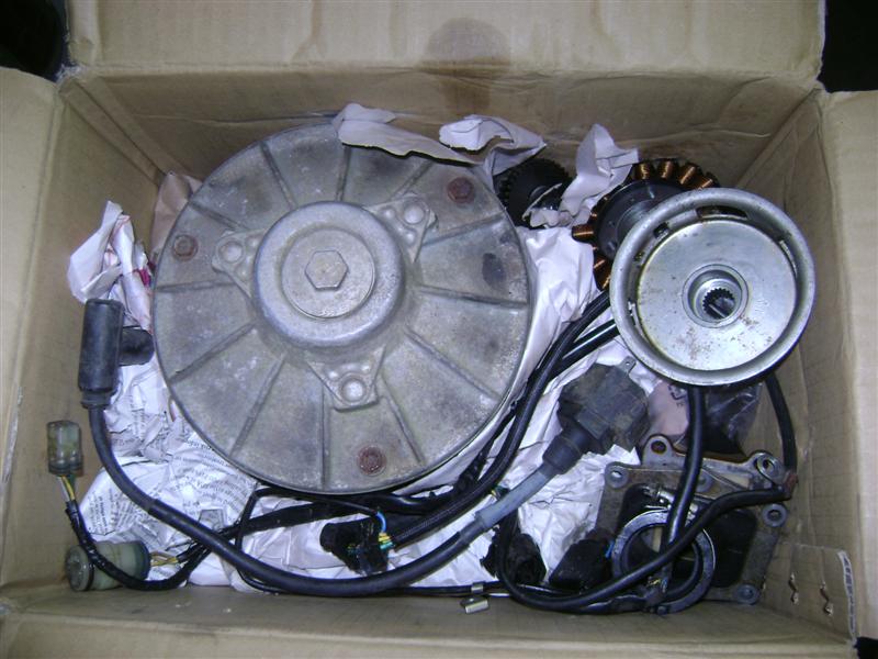

So far it looks very complete it also looks like its been taken apart then put back togther for shipping.
Included was the stock clutch, CDI (Capacitor Discharge Ignition), timer box, wiring harness, mount for CDI (Capacitor Discharge Ignition) complete Engine in parts.

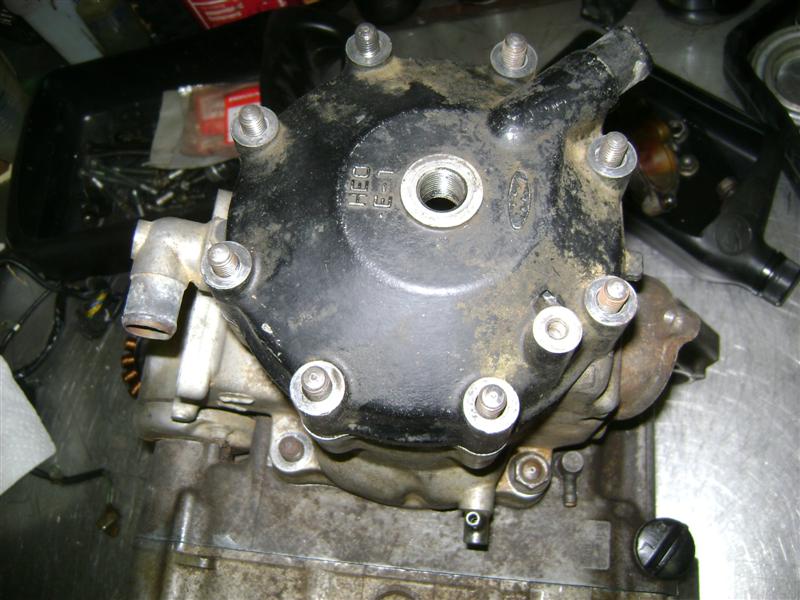

PostPosted: Fri Feb 17, 2012 11:53 am
Over all pics of the Engine as found out of the box.

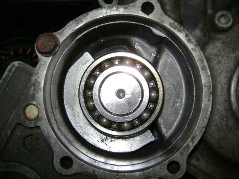

Looks like someone got the balancer about 1/2 way out of the Engine, they beat the shit out of the end of the balancer shaft assume they were trying to get the bearing off all they did was wast their time going caveman I used a small puller and pulled the bearing off the balancer shaft.

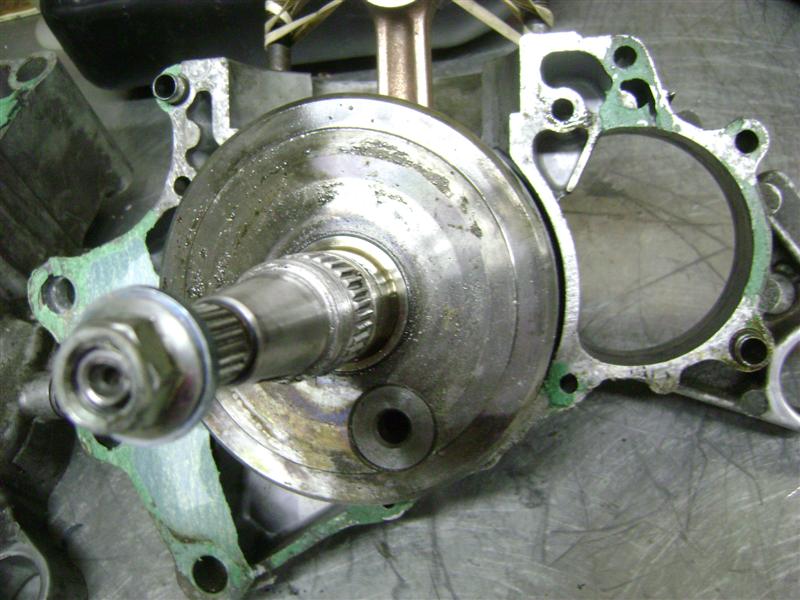

PostPosted: Fri Feb 17, 2012 11:59 am

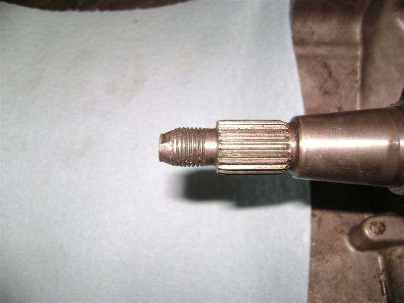

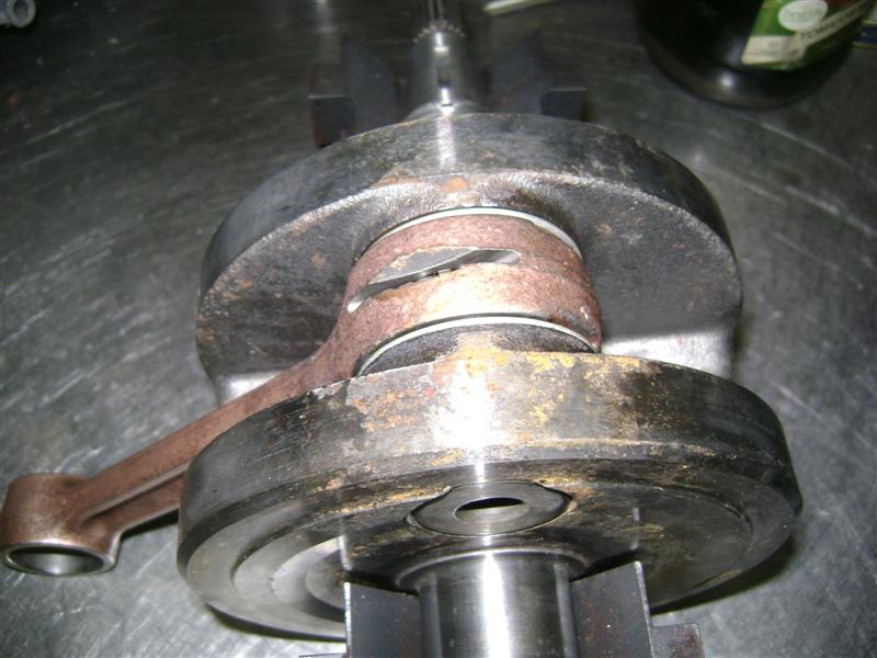

The wrong tools and procedures were used to remove the flywheel so the end of the crank shaft is damaged I think it can be saved.
It appears that the crank shaft has been replaced before the rod feels nice and tight, will have to do a real close inspection of the crank once cleaned up when spinning the crank in the cases the flywheel end has a wobble in it telling me the crank is either twisted or they bent the crank by using the WRONG flywheel puller to remove the flywheel be a shame to turn a 500.00 crankshaft into a paper weight simply because someone didnt want to buy the right puller :shock: then where you going to get a replacement crankshaft?

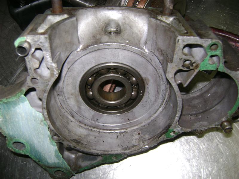

1/2 the crank case removed.

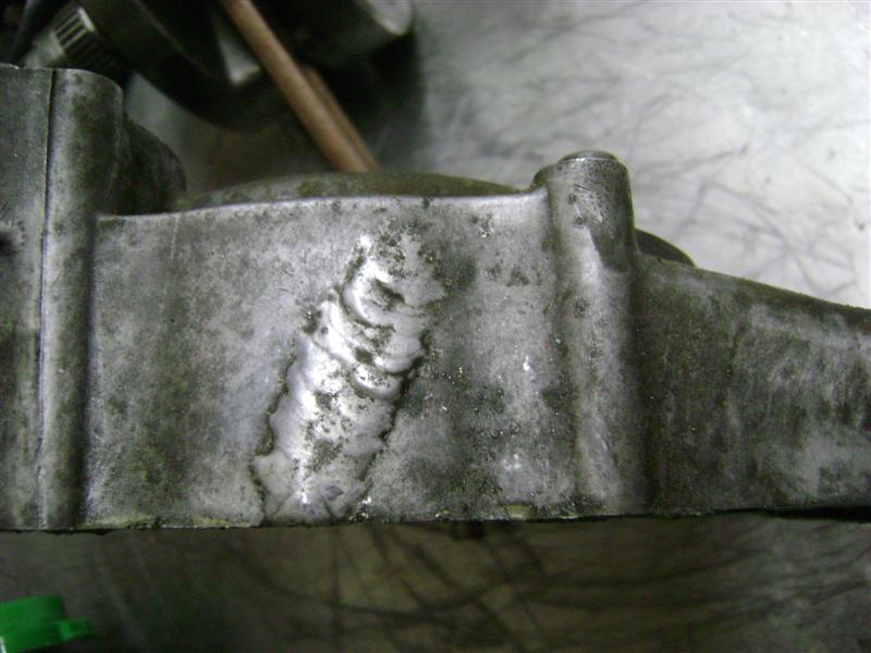

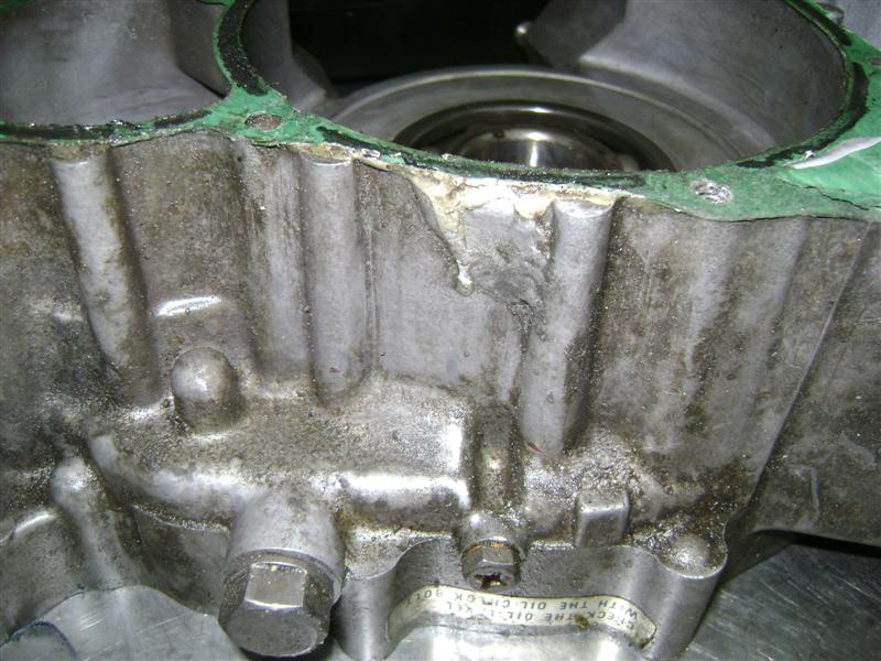

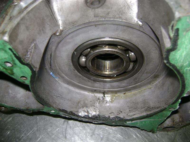

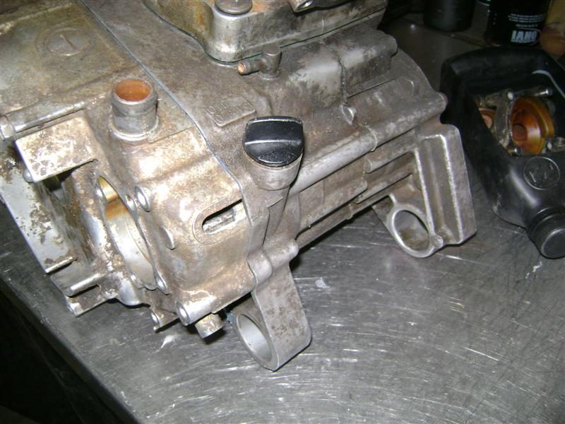

Both crank cases has been welded up assume a past Engine failure damaged them, the repairs look quality I will take a real close look after the cases are cleaned up and the gasket surfaces lapped.
Engine is all apart today I will clean up the parts and inspect them then build a parts list.

Yeah I noticed that CDI (Capacitor Discharge Ignition) had been modified I am sure Mudbogger will find a real good use for it soon :-)
I cleaned up the crank to take a closer look their is enough surface rust on the lobes of the crank to justify pressing it apart to inspect the pin and the bearing to ensure its not rusted so will see if Mudbogger wants it sent to Speedchaser and if Speedchaser has enough time to mess with it right now.

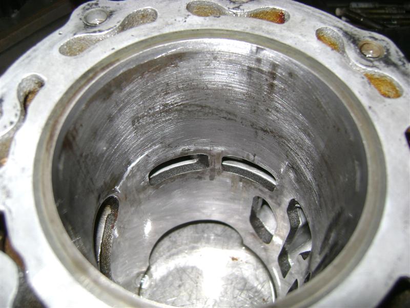

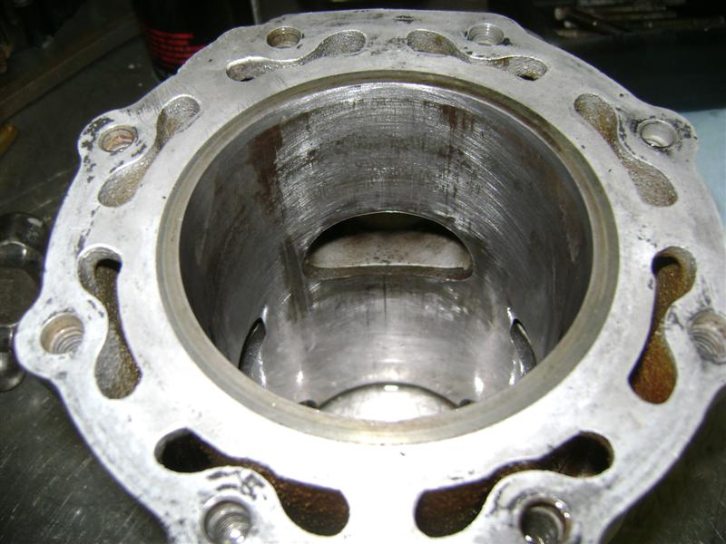

All the dowel pins were rusted in the cases I had to crush them then beat them out with a punch to remove.
The cylinder has enough wear rust and scaring it needs bored to the next size.

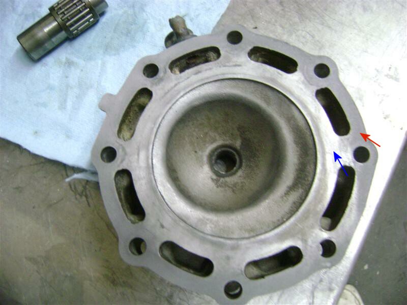

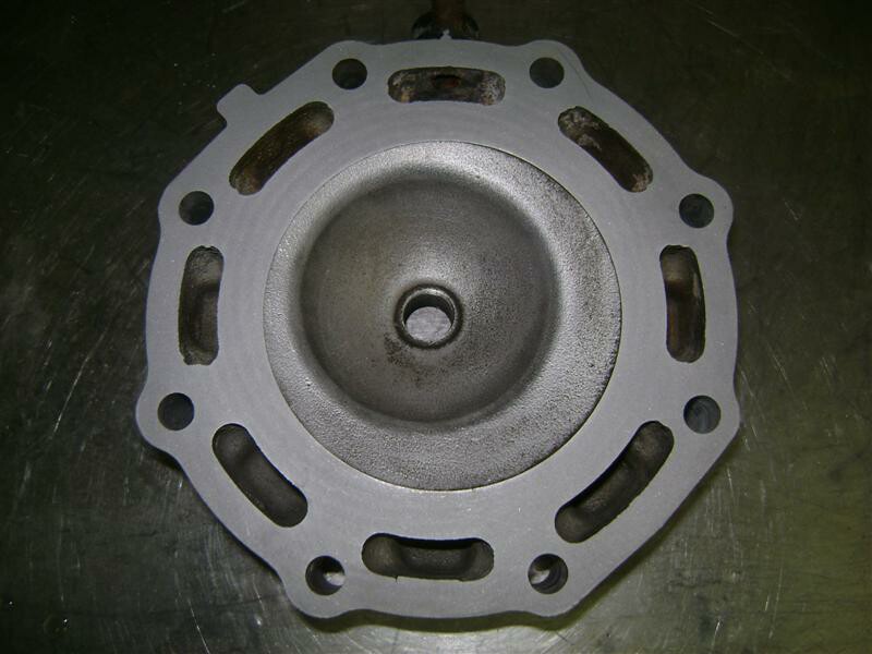

The stock head that came with this Engine was not flat so I put it in the lathe and made a skim cut removing about .005 to true it up then lapped it flat, its another good stock head for your inventory.
In the pics the red arrow is pointing to the dull gray area that is the high spots the blue arrow is pointing to the shiny or low areas that did not contact the lapping plate.
