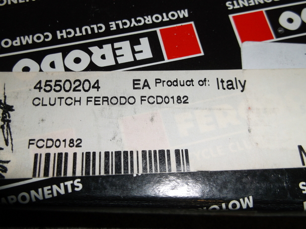

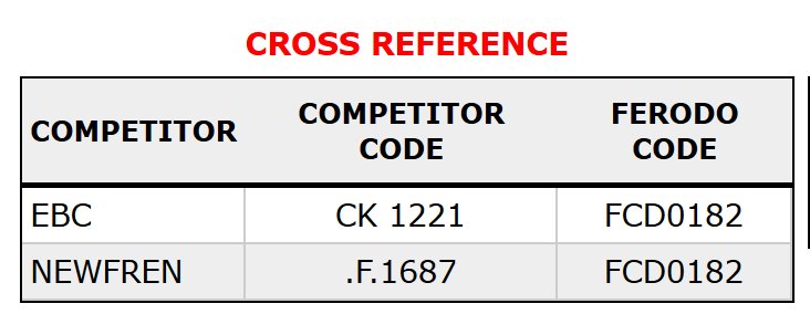

Thanks for the update, the above ebay links were dead did some searching found some info to document here.
The old ebay link said Ferodo-Clutch-Plates-for-1989-1993-Honda-FL400-Pilot-4-Wheeler-NEW so I Googled it and found another link on ebay and found the following pictures, in the one pic I searched for numbers and found more info on these plates.
First I searched for ferdo fcd0182
http://www.ferodoracing.com/catalogue/detail_clutches.php?cat=clutches&code=FCD0182
Found some cross reference numbers EDIT Cross reference numbers need confirmed!
EBC CK 1221
NEWFREN .F.1687

I disagree with the EBC cross reference. I believe it should be EBC CK1234.
PostPosted: Mon Nov 18, 2013 4:56 pm
I believe you are correct. the ferodo ones I am using are the FCD0182. they measured out the same as the ebc kit.
PostPosted: Mon Nov 18, 2013 6:31 pm
Why do you disagree with the cross reference, I am only going by what they provided, does not mean its right, this whole parts chase thing is trial and error lol Hopefully someone can confirm then update this thread I know others will need them sooner or later.

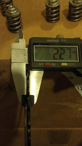

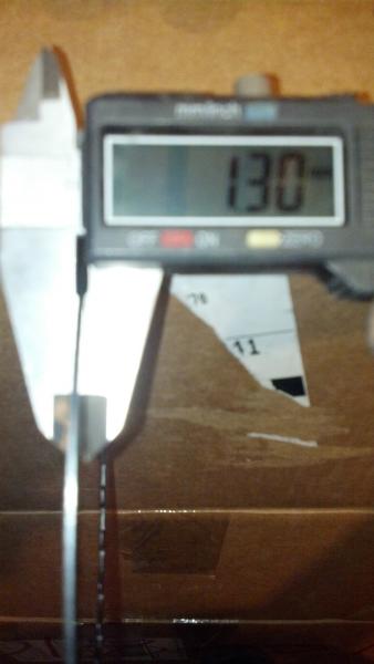

Mass, if you have one of those steel plates will you measure the thickness for me please.
If Anybody has a new Honda please do the same. I have "H",s number of 1.39mm
