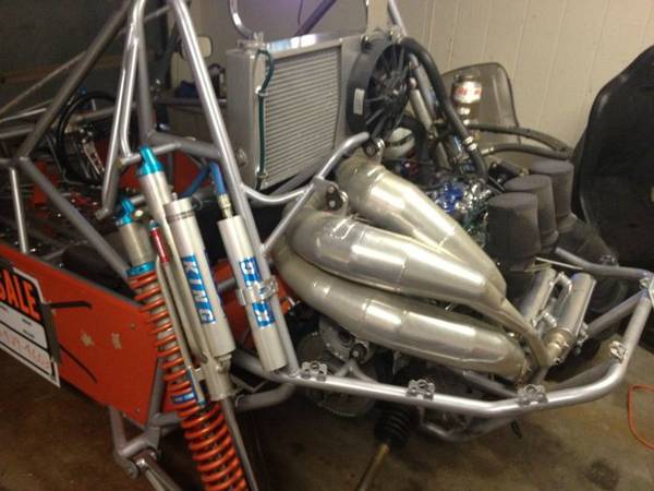

jetting nightmare!

Jetting should not be an issue unless ATV Racing has done work on this Engine and made it like their Pilot engines where jetting is finicky.
If it was mine the first thing I would do is build a air box setup like I run on my Pilot so it has dual filters and you can choke down the air flow like on my Pilot air box, jetting from bottom to top by restricting air flow on cold days, and like the Pilot or my other two strokes engines jet the thing so its right on or slightly on the lean side at 0 feet elevation at 50 degrees then your jetting is good to 5500 feet elevation without jet changes, fouling plugs or leaving a trail of smoke for others to choke on.
Rebuilds wont be fun lol $$$ good filter maintenance quality oil should allow you YEARS between rebuilds.

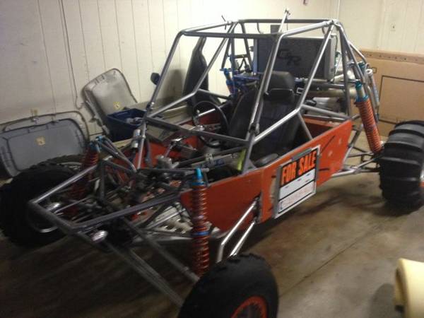

Long travel taz car. King dual bypass, reverse box, power steering, clean title, 1000cc artic cat motor (( Internal Combustion Engine ? )) 174hp. Clean title. Will trade for muscle car, crawler, jeep, duramax, cummins, toy hauler, wake board boat, bass boat, rzr, etc

what in gods name are those cage bars doing on the sides?
PostPosted: Tue Feb 11, 2014 3:02 pm
Steel tube nets they keep other tires from entering the drivers compartment lol
I have not seen them on other TAZ cars.
I have seen intrusion bars added to the front never the sides....

Triangulation, makes the cage nice and strong so it does not fold/bend like a drakart one time use cage. That is a weak area on a cage. Some sanctioning bodies will require bars such as/similar to that design to stiffen the cage.

There are several that have added bars to prevent the cage from shifting during a rollover. Take a look at the pics for yourself and you will see. Some use a lot of triangulation others use a small amount in key areas of perpendicular connections.

If this is the guy I'm thinking of...he is in a wheelchair and I believe that's why it was made into a single seater. I think the paint on the side (under for sale) is of a skull and spine with bottom of spine broken. Looks like a nice ride but is huge!

I saw some more info on this cage. Owner was paralyzed, top section of cage tips forward so he could be lowered in from top with a crane. If you look close you can see the pivots and where it catches on top.
