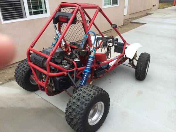

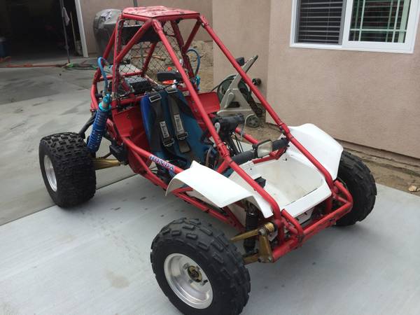

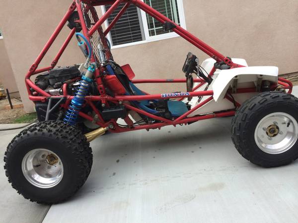

I can figure out what the heck those black bars are in the rear suspension. They look welded to the frame to me?
PostPosted: Thu Feb 05, 2015 7:30 pm
kind of a waste of king shocks unless you were going to to a conversion to long travel...looks like he made is own upper link. must ride better than stock though lol
PostPosted: Thu Feb 05, 2015 8:13 pm
Maybe someone can contact the owner have him come here give us some details maybe he is on to something?
PostPosted: Thu Feb 05, 2015 8:59 pm
Looks like it MIGHT be a bump stop?
PostPosted: Thu Feb 05, 2015 9:51 pm
Good call baz, bet you're correct. Otherwise it would bind the hell out of the ujoints I'm sure on full uptravel
PostPosted: Thu Feb 05, 2015 9:57 pm
i would say he replaced the adjustable camber link with that a-arm looking thing..
PostPosted: Thu Feb 05, 2015 10:07 pm
The OEM upper stay arm is STILL there...Looky closely. :-)
That's why I thought bumpstop due to the Xtra travel of the Kings.
To restrict the UJ angles and keep them in safe limits.
Thanks for your confidence in me Matty..............................(fool) :-)
PostPosted: Thu Feb 05, 2015 10:31 pm
I'm with the bumpstop guy.
Looks like a nice ride.
PostPosted: Thu Feb 05, 2015 10:39 pm
I'm off to mow a meadow,you guys bump it out.
PostPosted: Fri Feb 06, 2015 1:04 am
Reply from seller:
"Its a bumpstop we added to not over travel suspension and cause axle bind under full compression of suspension."
Good judgement Matty! :-)
