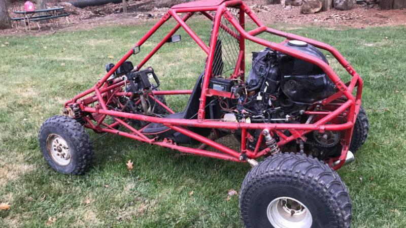

Not mine but I had to share.
https://newhaven.craigslist.org/snw/d/1 ... 58047.html
PostPosted: Tue Nov 28, 2017 12:43 am
Well maybe with all that weight back there the stock Honda oddy spring rate will work :-)
I am sure he engineered it for that :-)
PostPosted: Tue Nov 28, 2017 1:26 am
Wow would not want to roll over in that.Lots of dead tubes and missing braces to direct the forces loads.
The main roll bar stops at the hip rail very dangerous.
In a roll over and upside down scenario the downward forces and weight of that (Internal Combustion Motor??) would bring in the bottom half of the chassis which is not tied in properly with the hip rail etc Disaster waiting to happen.

Even better, no rear brakes ----------- AND no floor pan so you can use your feet like Fred Flintstone to bring it to a stop.

NO seat belts ------------ you don't need them ------------------ your gona die anyways

Maybe you'll get thrown clear of the wreckage --------------- but the fire ball might engulf you when the fuel tank ruptures
PostPosted: Tue Nov 28, 2017 2:04 am
Acceleration: 0-100 mph 3.6 sec
Braking distance: 8' (estimated) ------------------ the distance needed for the rear wheels to touch the front wheels

Tires on backwards ??
