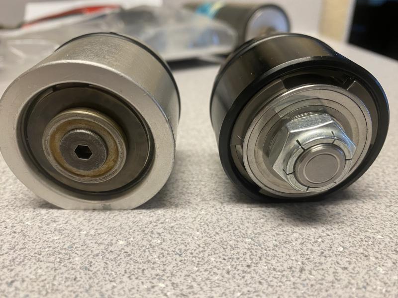

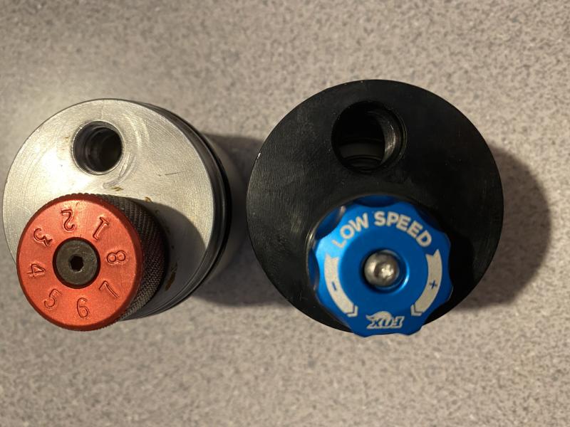

Anybody have a set for sale? Or parts?
The adjuster cap is cracked and fox doesn’t make parts for 1/2 shafts anymore.

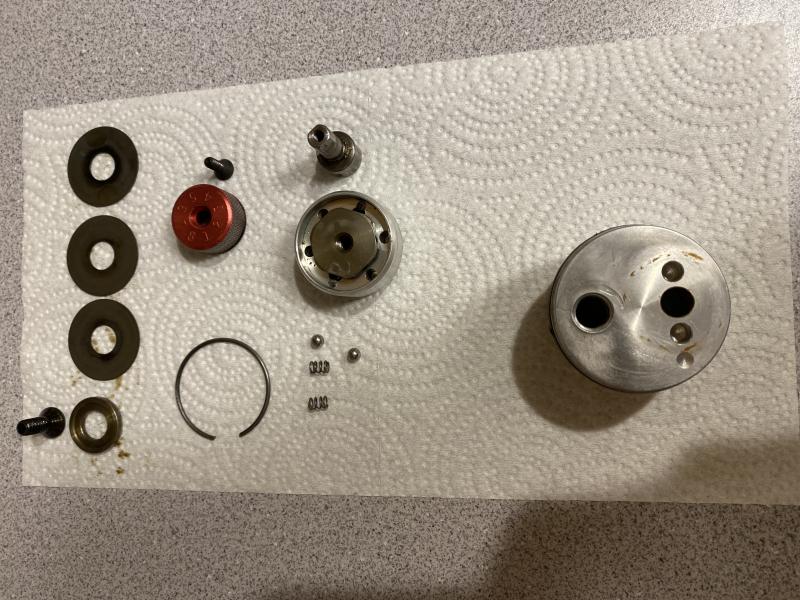

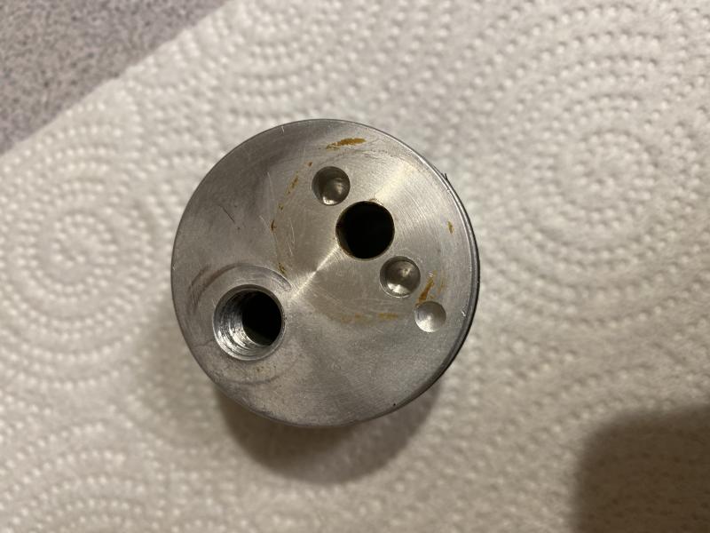

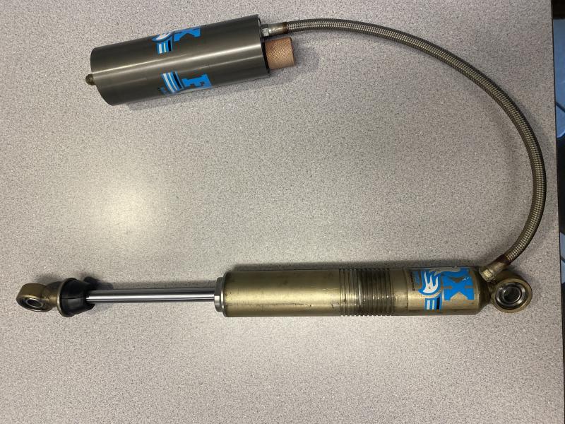

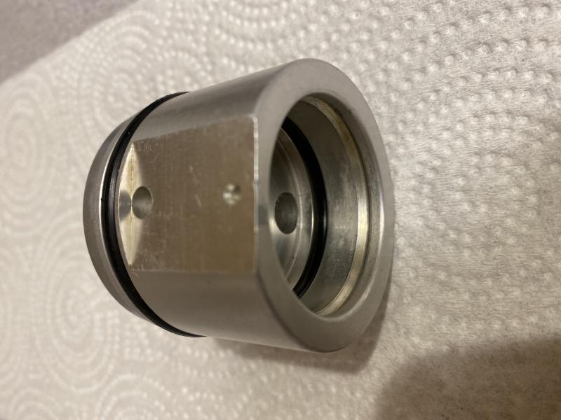

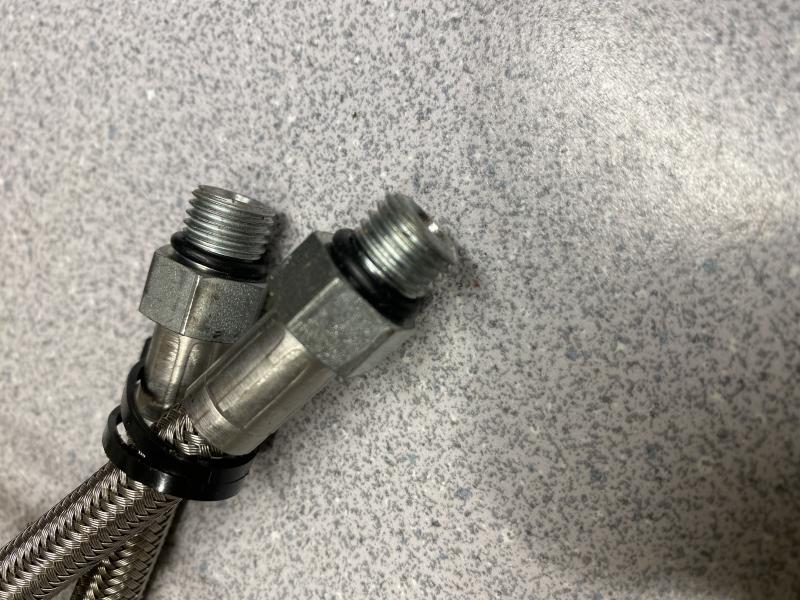

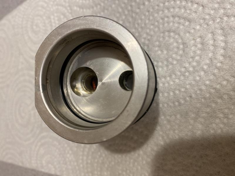

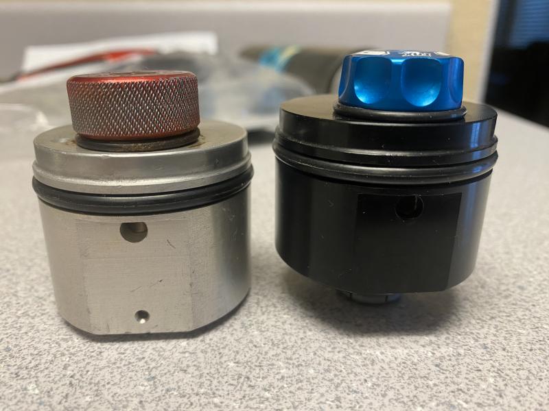

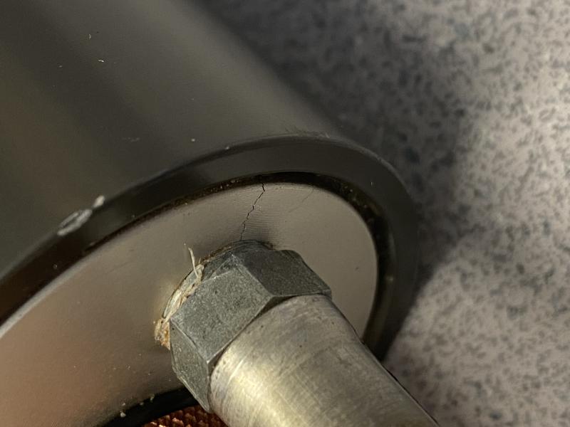

It’s a pretty involved piece. The older style used pipe threads and most I’ve seen or had the pleasure to buy are cracked. Fox sells and upgrade kit (all the pieces) and they go to O-rings. The shock isn’t converted but the steel body generally doesn’t crack like the aluminum. Then you have to buy the ORB hose for the new reservoir top on one end and pipe threads on the other for the shock. These are made for a 5/8 shaft but Fox has told me they will work in the 1/2 shafts as well. Pretty sure I have found all
The parts so hopefully it’s all back together soon.

The new adjusters showed up, still waiting for the lines.
Hey CO, I’ll send one to you when I get them all fixed up. For some reason my text messages aren’t going through to you.
