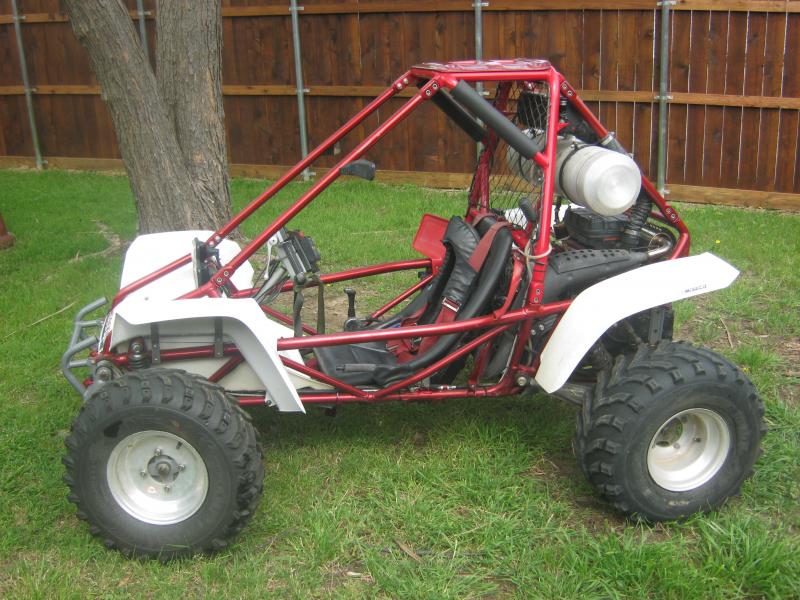

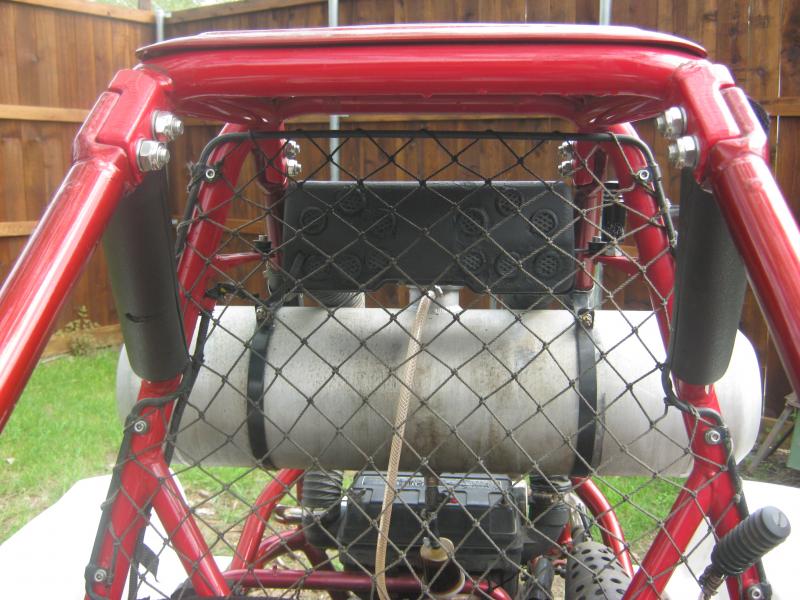

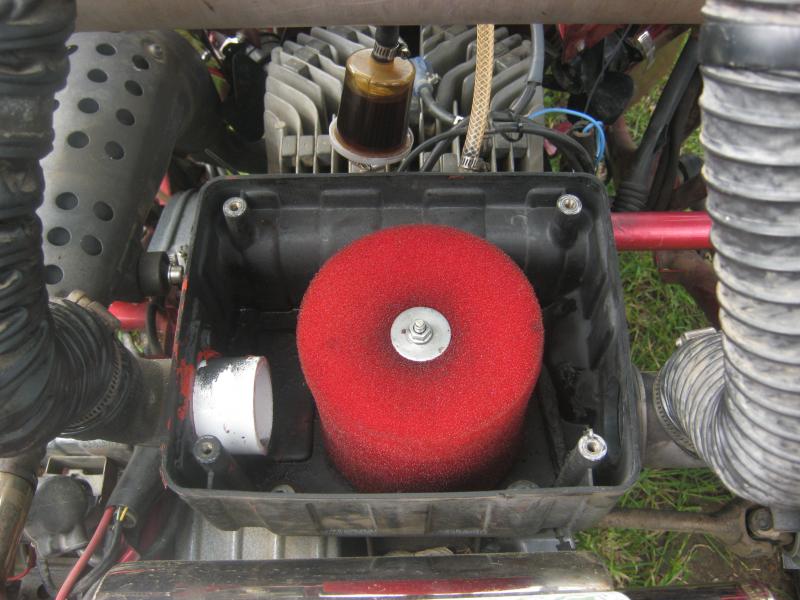

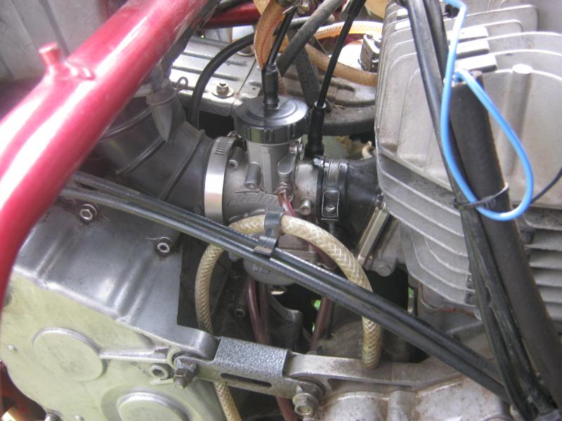

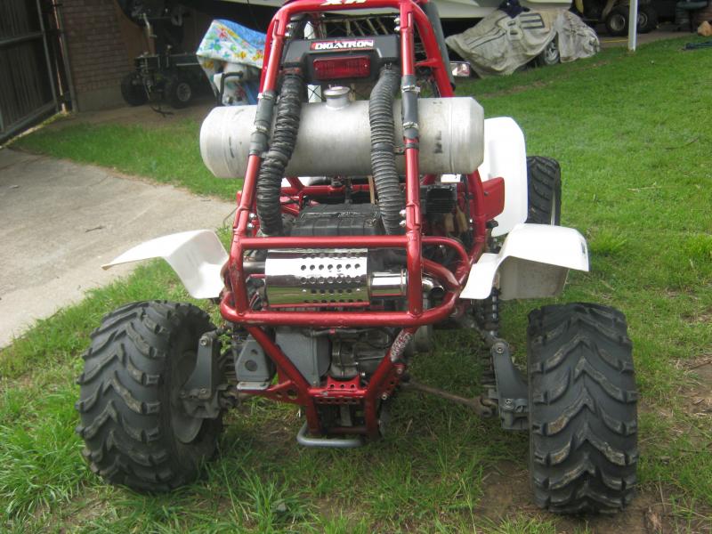

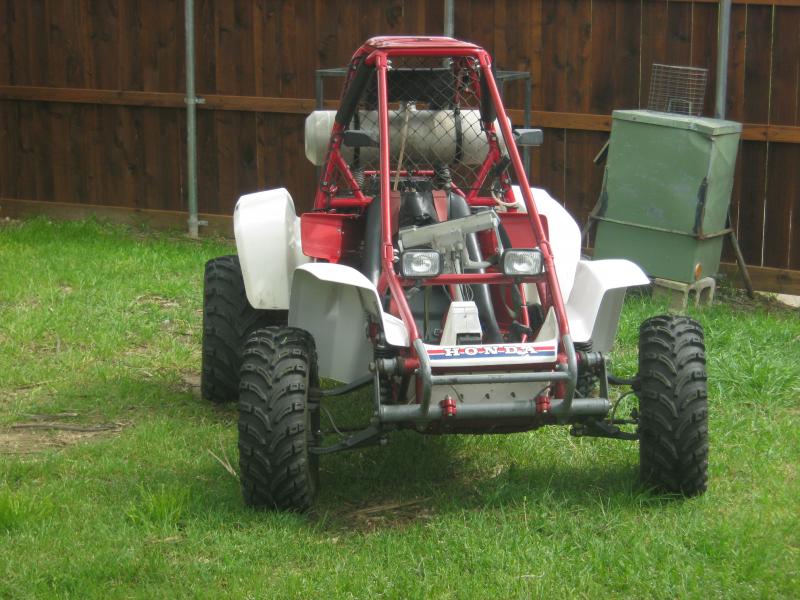

Looks like I have to sell it.
It has a clear title and I have it on hand. Everything works including the electric starter. The seat is in great condition, along with the harnesses and wrist restraints. Has a gravity fed tank and added a Mikuni fuel pump to a Keihin 35mm PWK carb. motor (( Internal Combustion Engine ? )) is 1 over bore with a Weisco piston and was preformed by the Honda Dealer in San Diego, also has Digatron 32K2 LT RPM/EGT Gauge, Dual Air Box Mods, Stainless steel brake lines front and back. new front fenders, slightly used front tires. dual air fans (off of a Goldwing). I'll also give my Motion Pro leak down tester, and have a few extra parts to go with it as well. 2950.00, obo. I'm in Dallas, Texas.

Nice rig, but the dual airbox mod confuses me.
Are there really only those (12) ~1" perforated air inlets (on snorkel box) feeding air to your Engine? So (12) x 1" holes covered 50% by perforations...doing the reverse math...the flow area of those (12) perforated inlets is equivalent to a single 2.45" ID inlet pipe.
Area of 1" hole = 0.785 in2
Perforated hole area (assumed 50%) = 0.393 in2
Sum Area of (12) inlets = 4.71 in2
Use Area formula A=Pi*r*r and reverse calc for diameter where A = 4.71 in2...r = 1.225", so D = 2.45".

good point, yes it could be better. not my design but i went with it. I was thinking about cutting out the whole front of the snorkel, didn't have or couldn't find the right type of screen and pre-filter to put there at the time. however, since were assuming lets assume it 3" id. whats the id of the carb intake? 1.25? i don't really know. now take in affect your going 15 to 60 mph, its no longer air trying to be sucked in, its air being forced in it. When the piston goes down the only air it gets is whats in the box. just adding that second hose alone gives the piston a little more air to suck in. But I could be wrong. this odyssey wouldn't be where it is at now without the advice and tips i have gotten from reading and reviewing all the post here. you guys are great. The best thing to do is to buy it, and add your modification to it. :) :) :)

Just an observation, plus I'm a "filter guy" for a living.
Bottomline is...it runs, right? :-)

OK, I opened up air flow more by cut out the middle diamond in each opening. and it did run better at lower throttle, :).
