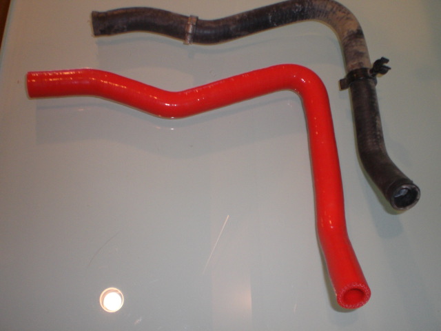

I have been working for some time now to get the discontinued Pilot radiator hoses remade, no one wanted to make a small run for us but I finally found a company that would and have been working with them and today I got the test set sent to me.
OEM Hose A 19115-HE0-000 $33.16-$27.19 discontinued
OEM Hose B 19116-HE0-000 $21.49-$17.61 discontinued
OEM Hose C 19501-HE0-000 $12.69-$10.41 discontinued
OEM list total-$67.32 OEM Service Honda discount total $55.21
After market 3 ply silicone hose set 98 dollars.

Im working on pricing I had to pay for the molds and prototypes and they have a minimum order. Im going to sell them to POOA members for cost and what doesnt sell here I will add 10-20 bucks to and sell them on ebay. Im not doing this to make money I have 5 Pilots and want to keep them running forever, the price for a set will be around $100 and if we ever do another order the price will come down 20-25% because the molds are already made.
I will only sell these as a set I don't want a bunch of partial sets laying around.

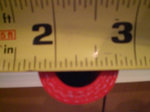

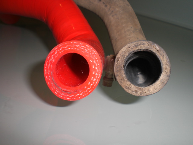

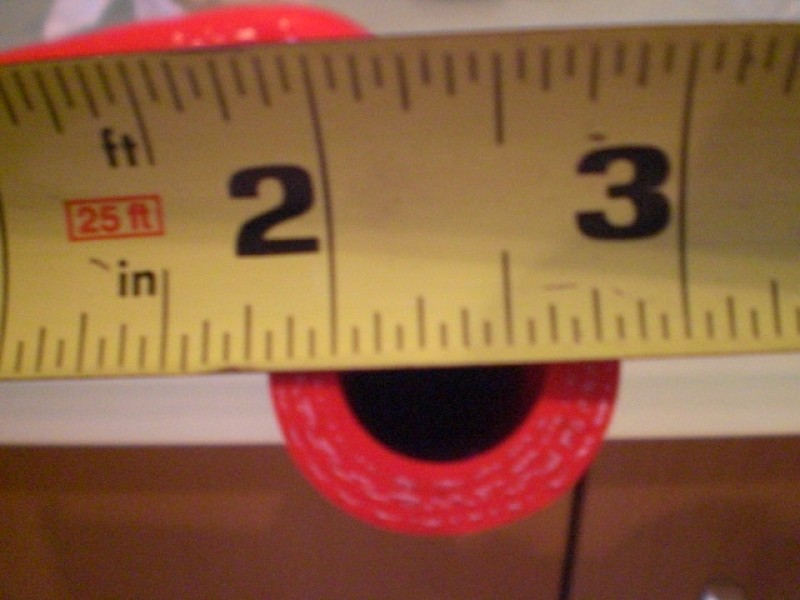

Ok guy's I need a little help I only had used hoses to send them to copy and they thought the ID was .62" these hoses are thicker than OEM and seem a little hard to get on, I got them right on with a little plumbers grease, you cant push them straight on you have to rock them on if you know what i mean.
so what im asking is should we make the ID bigger or is .62" what it should be? It would be nice to get this right before I make the order.

searching the net it seems 5/8" .62" or 3/4" .75" seem to be standard sizes for heater hose.
PostPosted: Thu Jun 24, 2010 9:30 pm
I measured the hose barb that's cast onto the Pilot cylinder it measures .755 I measured the ID of the Pilot short hose both ends seem to measure about .723 as you know its rubber, old and just a guess but I would call it .723 I bet if you cut the hose and measured it in the middle where it was not stretched over the hose barb and clamped all those years its actually smaller, we would need LEE for that measurement not cutting any good hoses here :-)

If it where me, I would make the ID 17mm.
OD is not as important, but I would have used 25mm.
But that's just me;-)
I think what afastcar has done is great.
