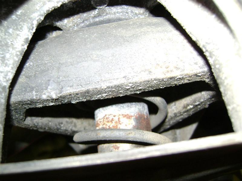

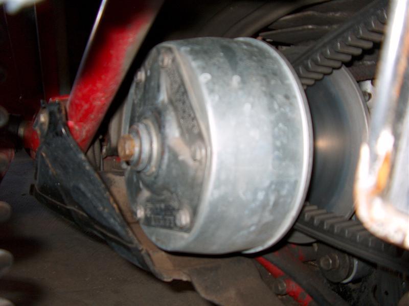

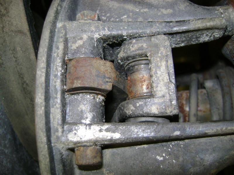

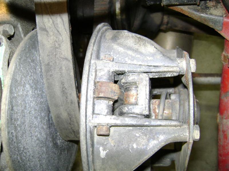

The 102c was NOT designed for use in the environment it will be exposed too when installed on a Pilot or Odyssey the clutch was designed to be used on a snowmobile under a sealed hood and Engine compartment like found on a snowmobile and in the winter below freezing where humidity levels are low so I strongly suggest you buy the clutch cover they sell for the 102C to help keep the shit out of the clutch.
Cover installed on a FL350 with a 102C
Below are pictures of a 102C clutch installed and used on a Pilot under normal conditions, you really want to spend 350 bux on a clutch then not seal it up?
Pics came from this thread viewtopic.php?f=25&t=4235
