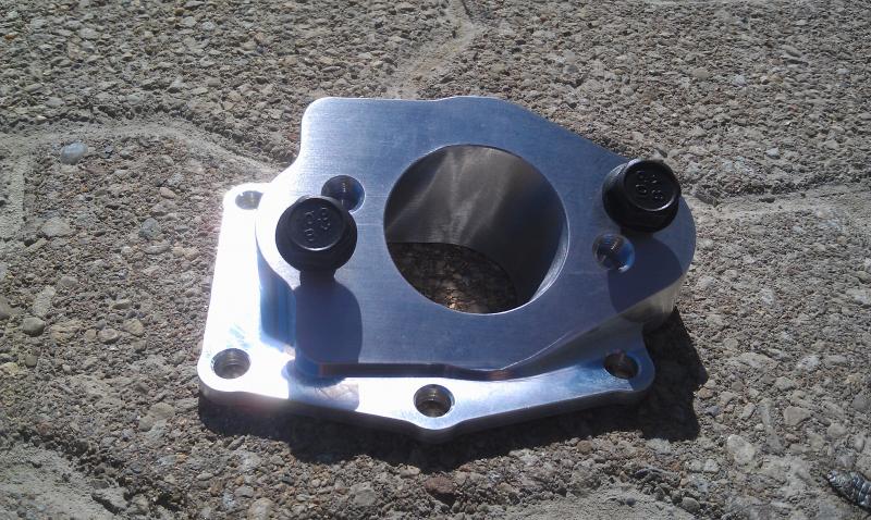

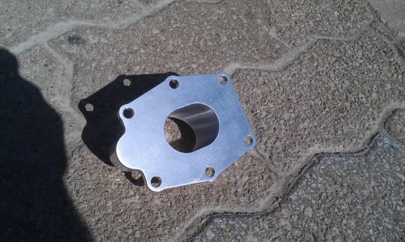

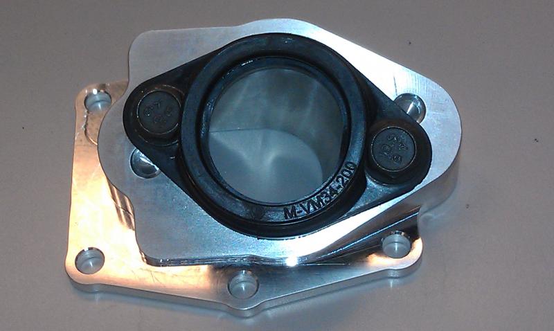

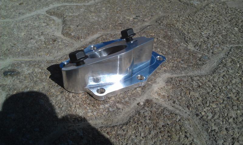

First piece....see pics. :-) Should have them all Wednesday.
Also, the big order of rubber flanges has shipped. :-)

Making a couple of minor changes to the part after playing around with it over the weekend.
Change #1: Targeting a 38.6mm inlet port diameter to ensure the small rubber flange's seal ring still seals. The ID of the seal ring is 40mm. Prior to the change, misalignment of the flange could cause the seal bead to miss. Granted, the flanges still seal just fine. I didn't want to worry about. Those running the 39mm carbs, you aren't missing much. Those running the 32-34mm carbs, you won't have to worry about sealing. =)
39.0mm ID = 4778.3 mm2 flow area
38.6mm ID = 4680.9 mm2 flow area (2% less)
Note: stock 34.0mm carb = 3631.6 mm2 flow area
Most "39mm" carbs generally have an ID slightly less than the nominal.
And...for those anxious to regain that 2% flow area, it would take mere seconds of filing to remove 0.2mm off each side.
Change #2: Trying to get 10% deeper threaded holes. Its fine as it is, but I don't want to leave any thread engagement on the table. With a coarse thread, every thread counts.
I'm hoping the shop can re-program and still have parts ready tomorrow.
The flanges are expected to be here by end of day Thursday, so kits will likely ship out Friday. Flanges left Texas this morning at 10am EST.
Also, I will try to ship parts out the "next day" from when I get them. I've got all the shipping materials, bolts, and addresses all set to go.
-D$

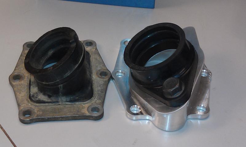

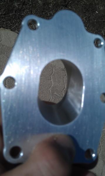

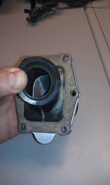

Couple comparison shots of the new intake (with big flange) versus the stock Pilot intake...

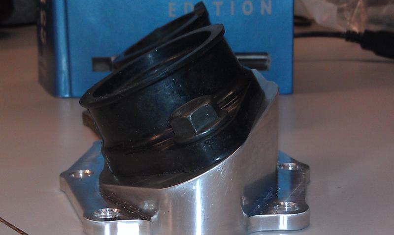

FYI - for those who have bought a Pilot intake kit: the flanges are installed on the intake, but the bolts are only finger-tight. Be sure to tighten them down.
And I'm glad I had the holes threaded a little deeper. Now the 16mm length bolt has more than enough depth and thread engagement.

When you heat and stretch a 39mm PWK onto the stock manifold right after the carb their is a slight choke point where it gets smaller the Dan i fold using the larger carb flange will eliminate the problem, no clue if it will be a noticeable performance increase I just know the flow will be better than using the stock manifold, removing and installing the carb should be much easier too :-)
PostPosted: Wed Jun 04, 2014 9:00 am
I agree the transition side is very well produced. I received mine yesterday and they are 100% what I expected them to be, thanks again for spearheading this, these intakes are getting harder and harder to find and these intakes assure myself leak free usage for years to come!
Yes indeed. The major ID of the VM36 flange is 39.5mm, so it fits the 39mm carb nicely. Plus the flanges are very forgiving (aka: stretchy), hence why I spec'd out this Mikuni 36mm flange for a carb 36-39mm. :-) I wanted to make sure the carb was the pinch point and nothing else.
