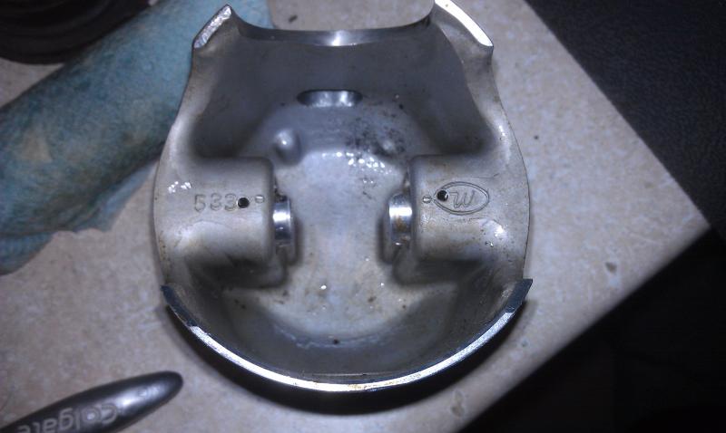

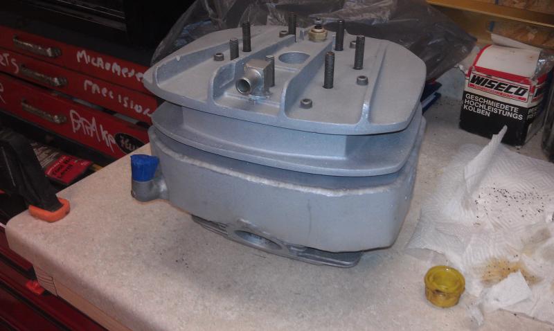

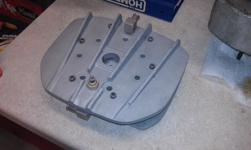

Hit all the aesthetic surfaces with the bead blaster. Then rinsed a few times in the gas-o-rinse-bucket and blown off with dry air. Looks new again!
Got the rings & grooves soaking in acetone now. I guess the piston sat in a box for years, but he put klotz on the rings. It turned to funny varnish. See how it looks in the AM.
File comment: Piston wrist pin lube holes...
PostPosted: Fri Dec 21, 2012 11:59 pm
Ooooh that's fancy. You gotta get that on a ride soon. Your gonna be very happy with that.
PostPosted: Sat Dec 22, 2012 12:28 am
Check your cyl studs for stretching,looks like some are narrower at the middle section.
Use verniers or straight edge to make sure.
Over the years/owners, they are torqued down many times.
Also ensure they are torqued in correctly.
When I had mine,3 studs loosened up,plus my mech Dean noticed most were stretched in the middle,also showed me to look at the wider gaps in the threads,had a good eye.
PostPosted: Sun Dec 23, 2012 11:50 pm

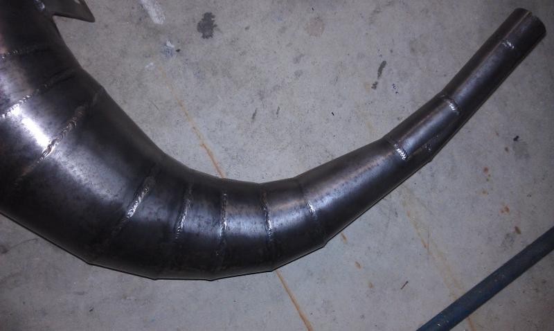

It's very tempting to buy more parts off of Bill, but I had to put a limit on my spree. Bought the Jemco pipe as well as a Comet 94c, all for under $200 shipped from FL to OH. And that's likely all I'll buy (for now).
Pics attached. A little blurry. Will get some better shots when it arrives, hopefully before 2013.

PostPosted: Sun Dec 23, 2012 11:52 pm
Bill says he's got the receipts for the studs and bolts and they're brand spanking new, un-used.

That's a cool looking pipe. Looks pretty short. Will it bolt into an fl350 stock location?
PostPosted: Mon Dec 24, 2012 8:15 am
Yep, it will need a mount or two welded on.

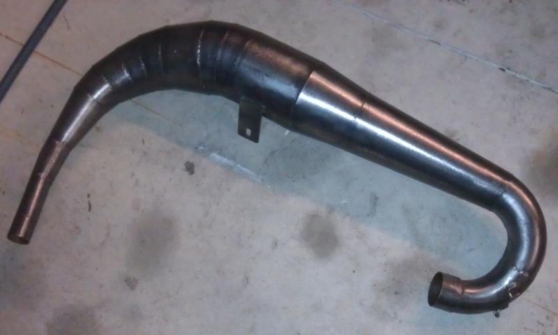

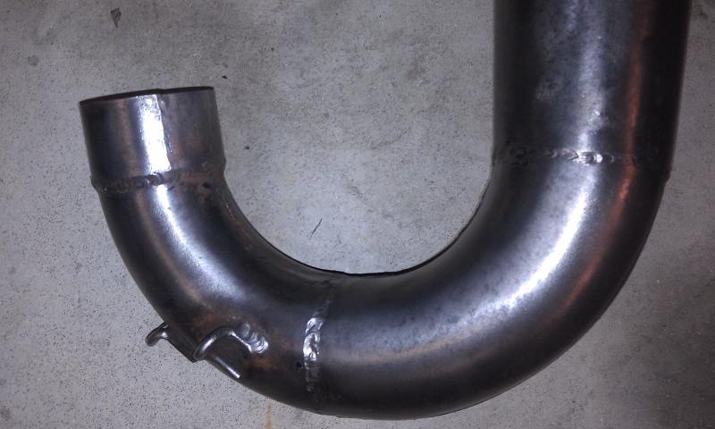

PostPosted: Thu Jan 03, 2013 9:25 am
And here's the Jemco pipe...
In hindsight, I had a stock pipe sitting on the floor 6' away and should've taken a side-by-side photo.
Silencer placement will be a little trick. I've got a clean Klemm in my FL350R pile, and have a FMF powercore from a Zilla that can be hacked and fit. Will prob use the Klemm since it's steel, so I can weld on any required mounts (FMF is alum and I don't have TIG).
