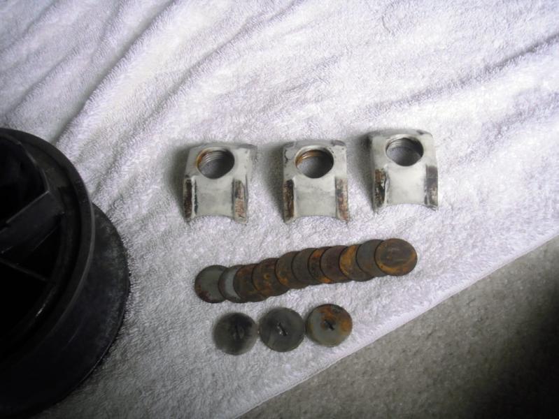

here ya go baz. here are some pictures of the goods i need!
Thank you!
The first pic are the parts I need replaced:
[*]Three white pucks(doesnt have to be white)
[*]various puck shim weights(mine are all rusted to hell and looking quite sad)
[*]I probably need a spring.. this one has a severely rusted teal spring and there is nothing about teal in powerbloc central
[*]and most importantly the caps that hold them in as mine are SHOT.

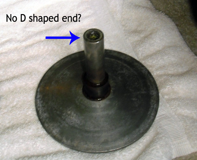

I cannot find anything anywhere about weights as they related to desired RPM engagement.. The only thing I can find is foot lbs through the RPM range. The second pic is a question I have...
File comment: Who can find out whats wrong with this picture.

"What's wrong int he pic" for starters theres only eleven washer if two are not stuck togheter. Ooops. 4/4/3.
Since you have the bolcks, weights and caps I would put 4 washers, one cap and one block on a scale and weight. Then when you get new parts set up your block starting with that number as a base line. As far as the spring find the pound rate and try to find out the free lenght of the spring to compare to yours. The difference of free lenght will change the preload which can be shimed into shape if not out to far. If out to far it could coil bind if shimed to far. Some bench testing can tell you the parimeters. Just be carfull those springs carry a lot of energy when compressed.

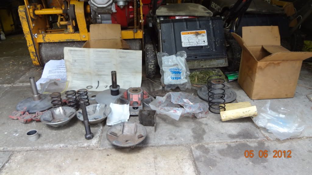

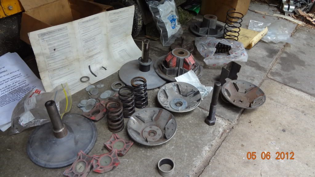

Tim,finally dug em out,here's some pics...and Rand,sorry but can't find that 350 Ody exhaust ring,plus NOW I can't find that lil plastic bag of O rings and gaskets.
I saw it the other day on my pegboard,now don't know where the !@#$% it is?
I bet I put it somewhere where I would'nt forget! :shock: I am my own worst enemy,and often make things worse,by thinking I am improving on stuff,know what I mean? Image
I'll keep looking tho,and let you know if/when I find em.
