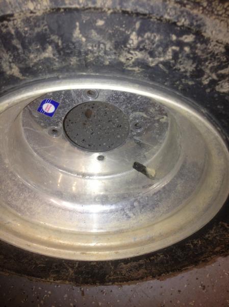

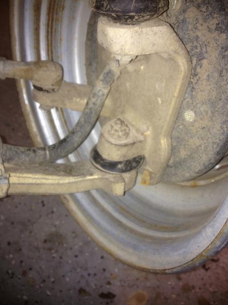

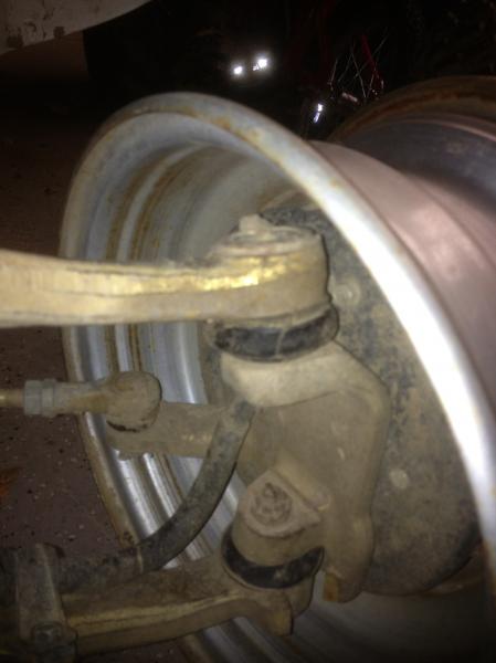

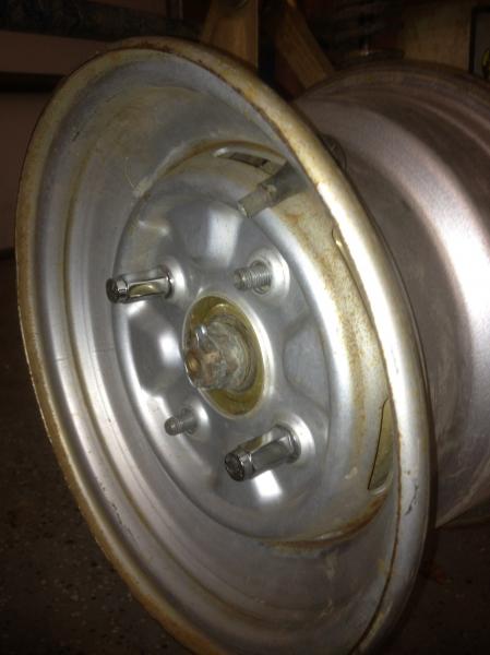

These are the pics i took of the 97' yamaha timberwolf 250 2x4 rims i just received from powersportsnation.The rims match up nice even though they are a inch wider than the oem(1"to the inside). The other drawback is the don't have the access hole to inspect/adjust the front shoes, but for $60 shipped for a pair in good shape i couldnt go wrong. I also need to get some oem lugnuts and keep the others for the other wheel if i ever mount sand tires on em. The last pics is the "Douglas Deep Dish Wheels" that were hurting my arms/wrists. I will update again once i mount them and go for a ride, maybe this weekend....??

PostPosted: Wed Nov 28, 2012 6:35 pm
The aluminum ones do look great but they taco pretty easy to. I'm a sucker for gold wheels so I had no desire to change them. You got a drill bit don't you? Inspection hole solved!
