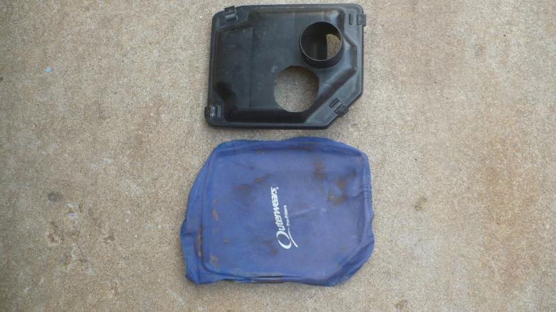

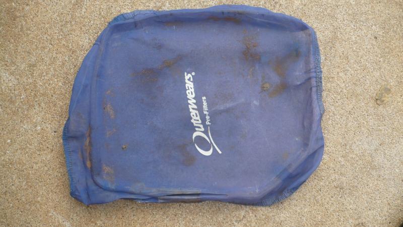

On the last Pilot I bought it had an Outerware prefilter for the box, I snapped a pic.

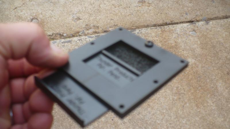

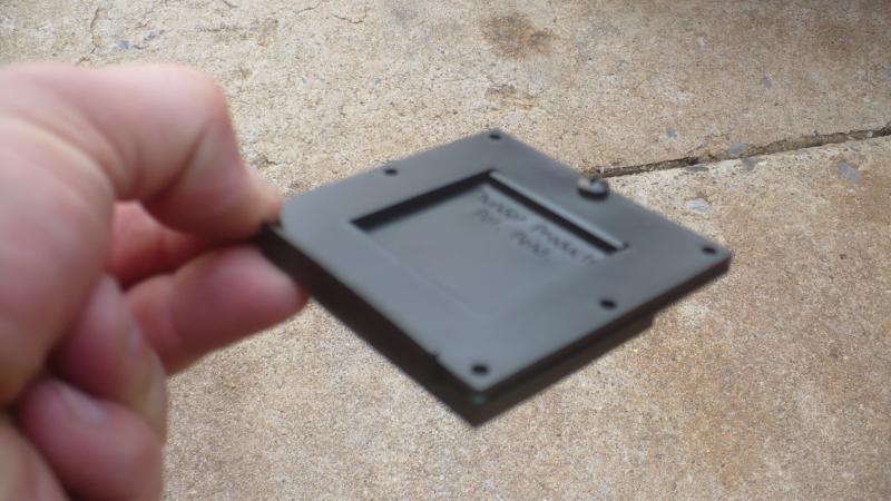

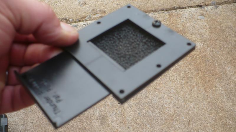

That would work...This is what i have

Im installing the Outerware air box prefilter and run the Uni filter in the box. The Outerware prefilter is installed between the lid and box, its airtight , that's my prefilter.
I have the same exact thing on my Turbo Pilot and have yet to jet it using it. I also installed a dial a jet in the same pilot so I have a advanced method to jet especially in the winter.
