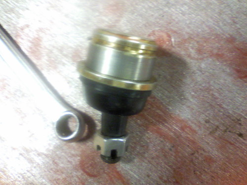

You can see in the photo that they have been turned down. better put some ant seize on that bare metal when you install those ball joints.

That might be why so much then, but since its modified their is a good chance its a 6.00 off the shelf part available about anywhere.
If I had one out I would take to a few quality auto parts stores see if they can measure and match it up, all the ball joints I have are currently installed.

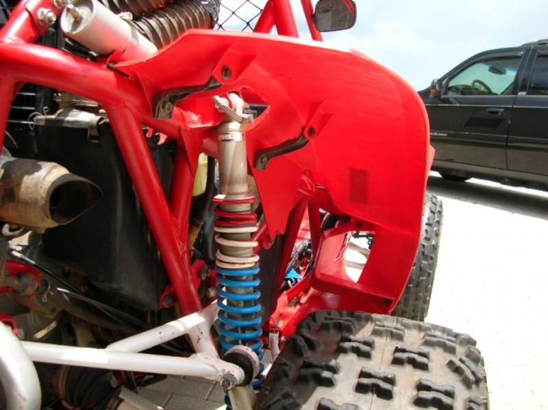

I remember the rear was smaller, but it seemed there were two sealing surfaces that the boot could be attached to. Been too long to recall exactly.
The best picture I could find is attached, maybe Aussiehoon can take a better one

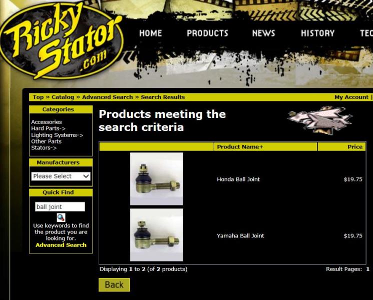

You can still get ball joint boots from Ricky Stator, I think I paid $15 for 8 or 10 including shipping, they did not have the spring clip but I was able to reuse, also as mentioned in another topic, super glue seems to work well as long as you can keep all the surfaces clean which is a trick if you grease before it's installed.

this is all I see on their site.....what am I missing?

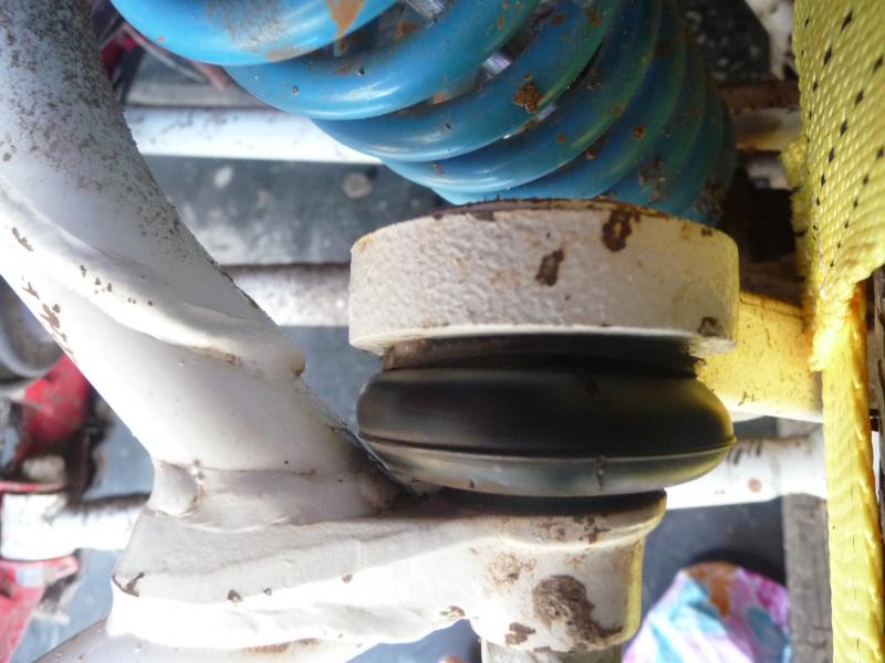

Here's a close up of the glued boot on DC's old Pilot.
Looks like they are holding up good thanks for the update :-)
